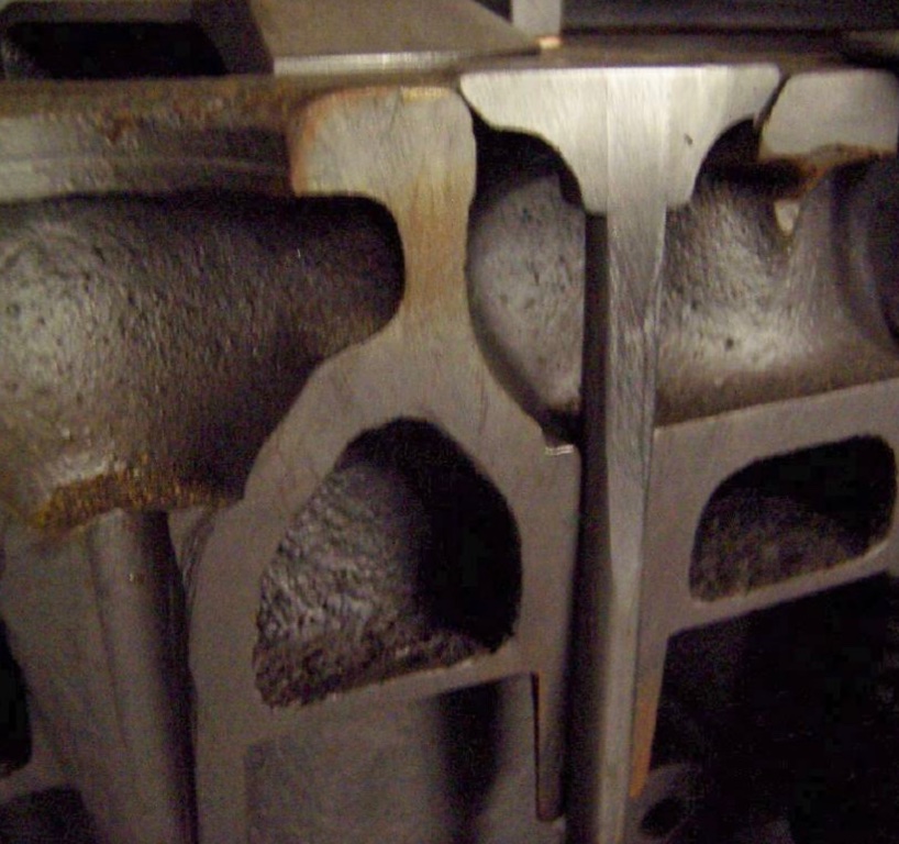

- Posts: 3953
Re: Factory drawing of two piece valve
Here is pic of a two-piece valve ground away to show with a cut-a-way engine display. Shows the steel shaft and the cast iron valve head. Likely heat formed together in perhaps an electrical method. Ford did a lot of electrical welding in many processes.

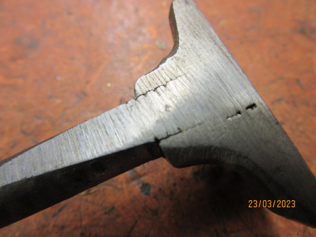

I contacted the Benson Ford Research Centre and they have drawings which I'll buy. They are $30 per drawing.
I've cut a valve in half, linished and acid etched it and it looks like the head is poured onto the stem, which has either a thread or series of grooves which deform under the heat of the pour.

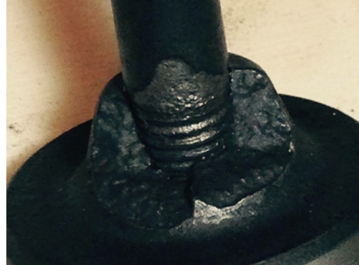

This is what I find :
I don't know or it is a thread like a bolt , or just grooves ? Toon
I have removed some in pieces that looked like the stem was mushroom then poured around it.
