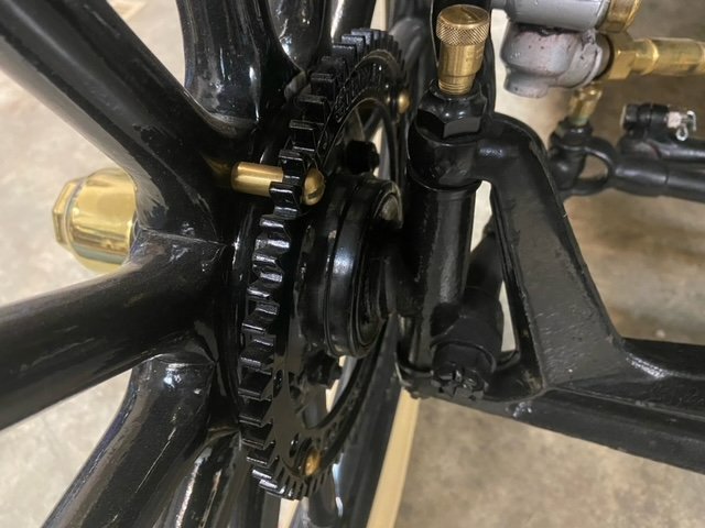

I just received an early hub with the machined step and three holes for mounting a speedo drive gear directly to the hub. I thought the holes for mounting the gear would be threaded but they don’t seem to be. Should they be threaded and if not, how is the gear mounted?

Re: Question about mounting a speedo gear to a hub
Three screws into the wood.

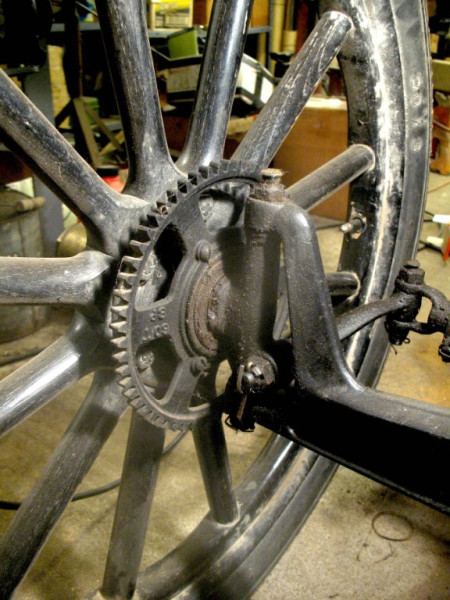

This is my 11. I have not installed the small driven gear on the swivel. I think the screws and spacers came from Langs. Art
- Posts: 6801
The hub with machined ring is its own spacer. Like Steve shows, you install long-ish, round head wood screws through the holes and into the wood. There are no spacers, and you'd be hard pressed to get the wood to hold so well that you manage to warp or otherwise injure the gear.
Personally, I'd pre-drill three small holes in the wood, drag the screw threads across a beeswax block and sock it down. Done.
Good catch Scott! I skipped right over the “machined step” part of the post. Art

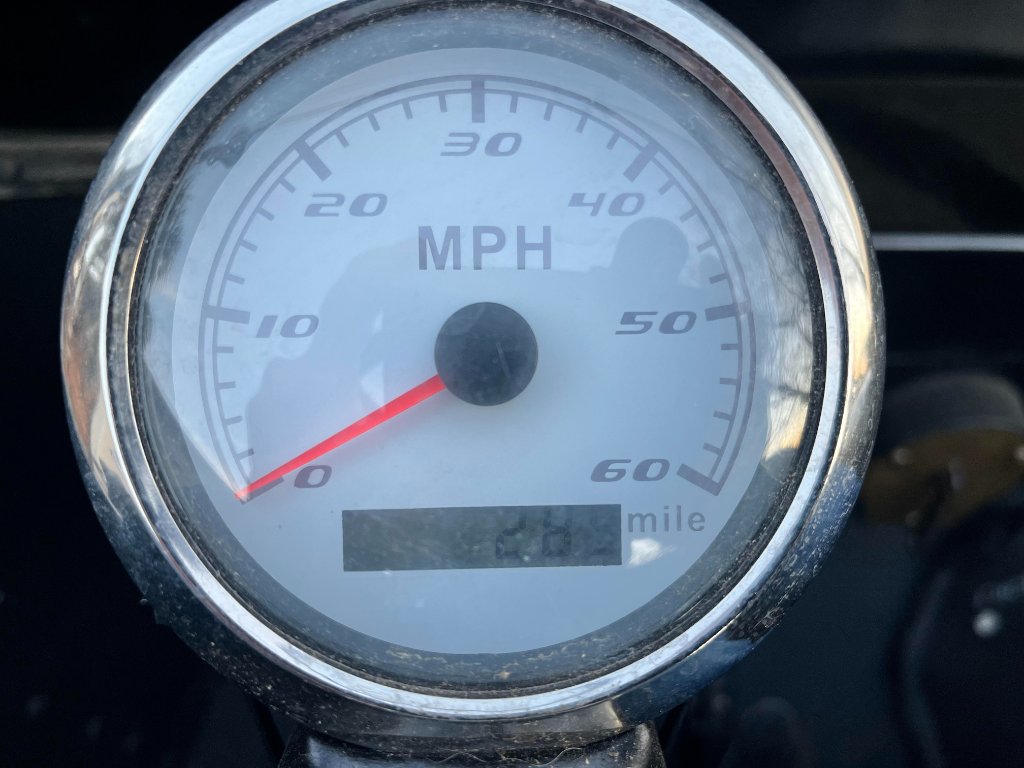

An original speedo is great but you can get a GPS Speedo on ebay for about $50. They say it needs 9v but it works just fine on 6V
