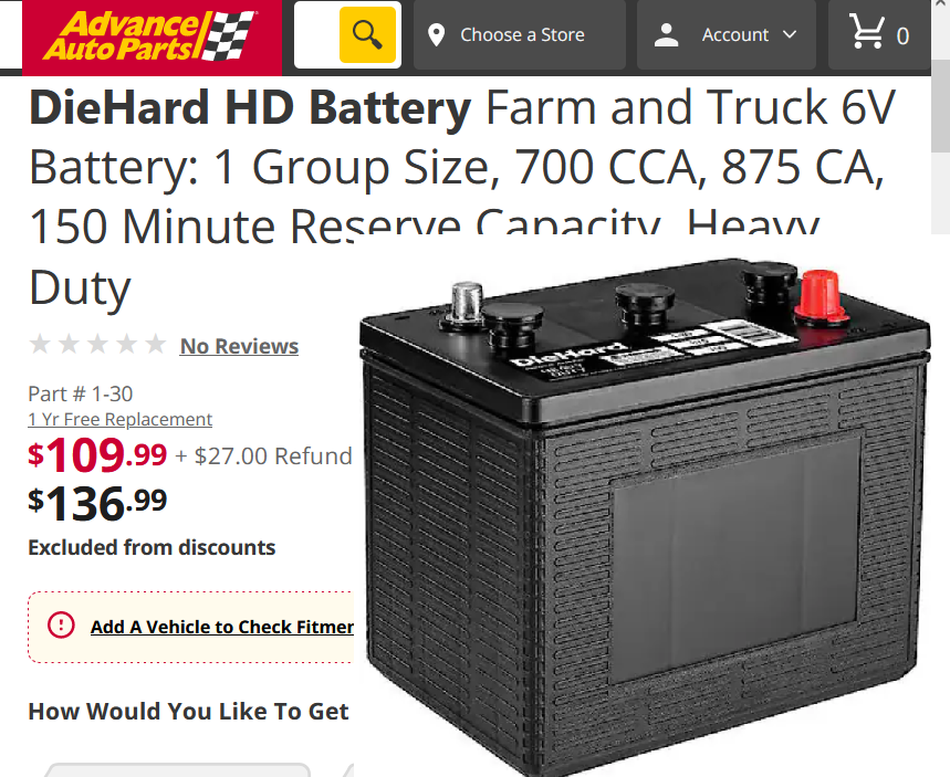

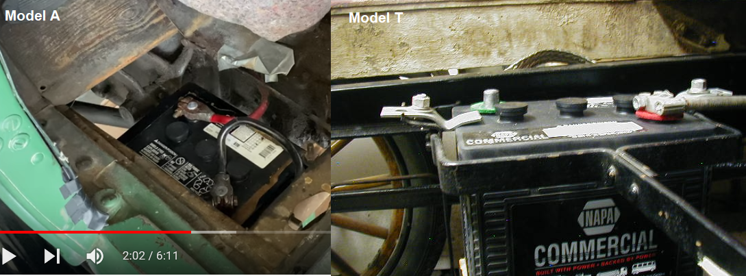

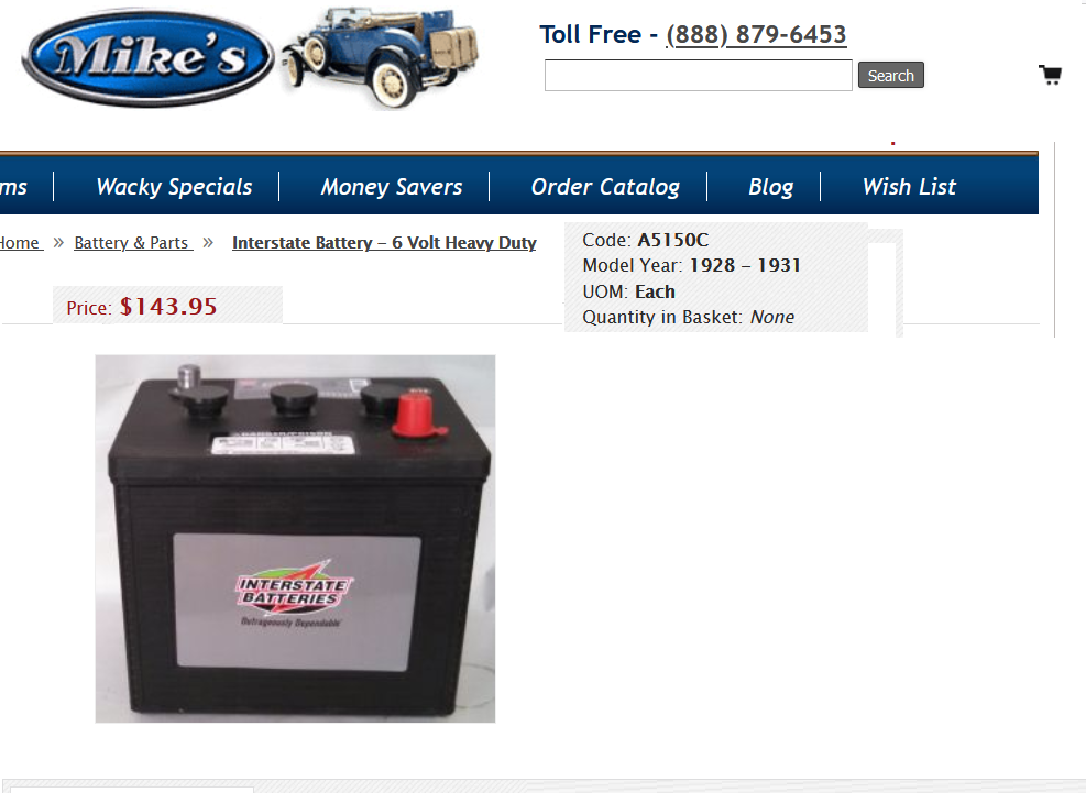

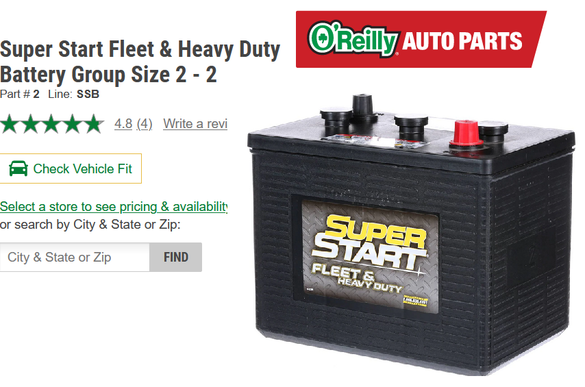

Posts: 6588
Re: Optima 6 volt battery
Post by TRDxB2 » Sun Mar 26, 2023 3:27 am
Posts are in opposite corners so they are the same.
