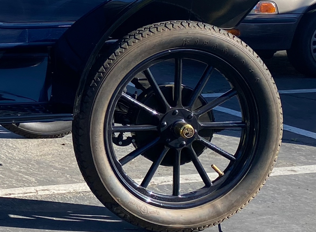

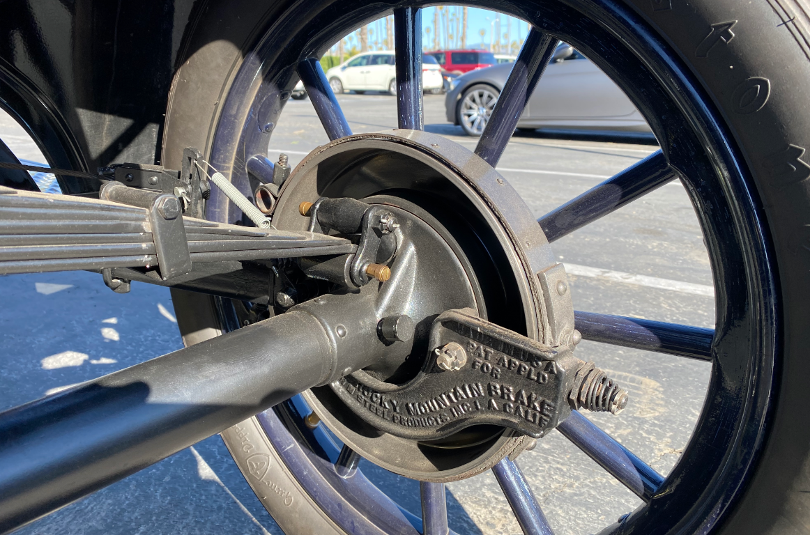

Here are some original Rockies, from Original's car. Saw it at a tour last Friday. Nice looking castings.

Posts: 7411

Posts: 3953
Location: Lomita, California
Re: rocky mountain brakes
Post by Original Smith » Fri Mar 31, 2023 11:30 am
The photos above are on my 1913 runabout. Thanks for posting! They are 100% original Rocky Mountain Brakes.
