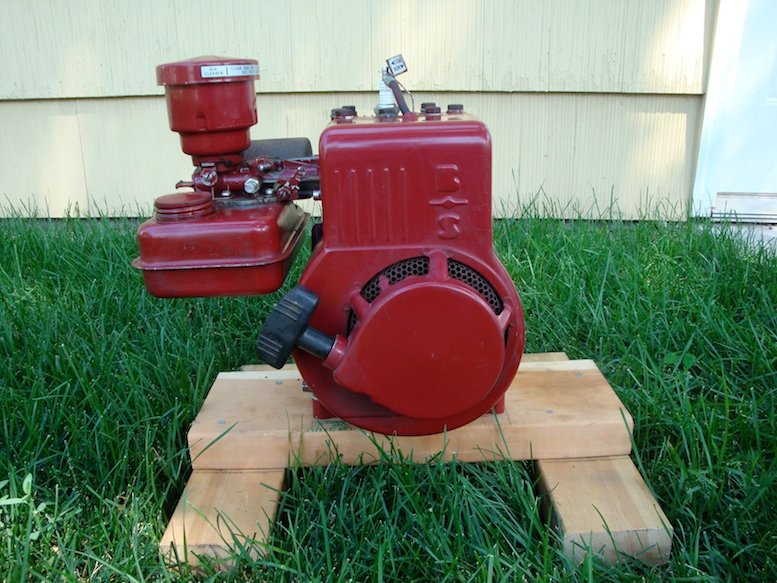

You've probably seen a floatless carburetor on a lawn mower or snow blower.
Example of a carburetor with no bowl or float on this 1959 Briggs and Stratton from a Toro reel mower. It draws fuel directly from the tank.
This style of carburetor is still in use today - refer to second photo of a new one.

Hi Erik,
Technicaly that carb has a bowl that is open on top and the level is controled by the bowl that will spill the excess back into the tank. The short
tube draws fuel from bowl & the long tube is attached to a pulse pump that draws fuel from the tank. Don't get me wrong I used those Carbs. In
Kart racing on Methonal years ago and they work great. I just don't want the gas tank hanging under the carberator on my T. The vacuum
controled flow is still used today in weed-eaters & leaf blowers in states they are still legal. They were used in updraft carbs on aircraft for a
long time and even on Harley-Davisons but are signifacantly more suffisticated than what was available for T's. I dought I would be able to put
up with what I would get from most T'ers if I put a side draft Tillotson on my T.
Craig.

Hi Erik,
On second thought you are correct there is no float in that carb I was thinking bowl not float sorry if I miss spoke.
Craig.
