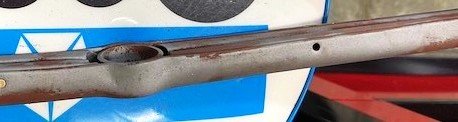

23 touring, want the lower Windshield frame at least, with safety glass at best. Kinda would like a good pass/right stanchion with nice square bolt holes where it mounts to the body

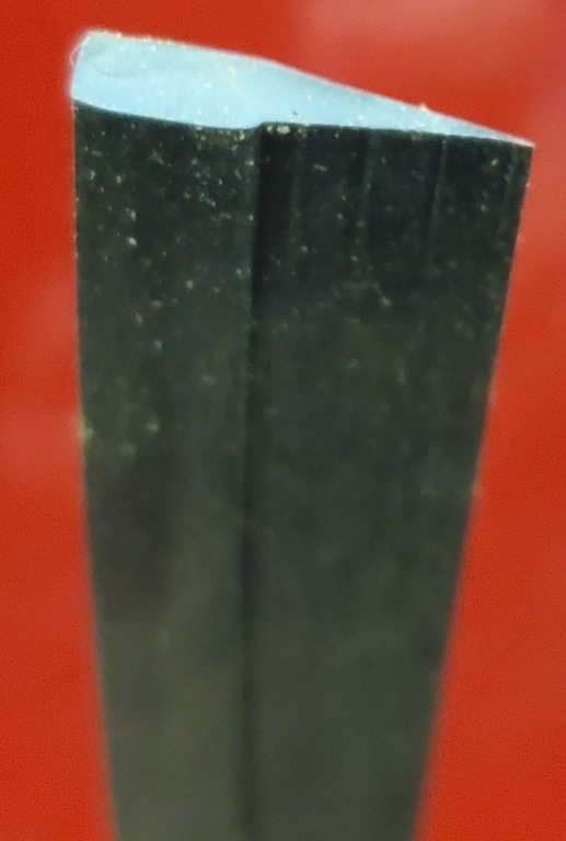

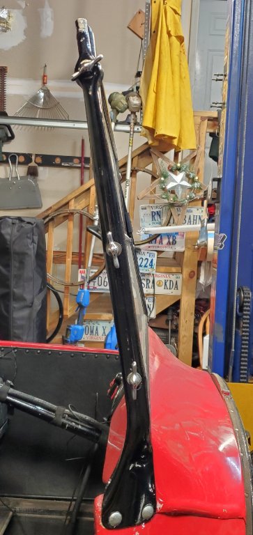

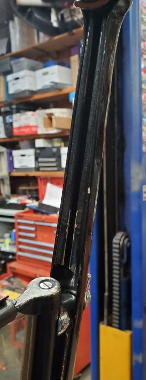

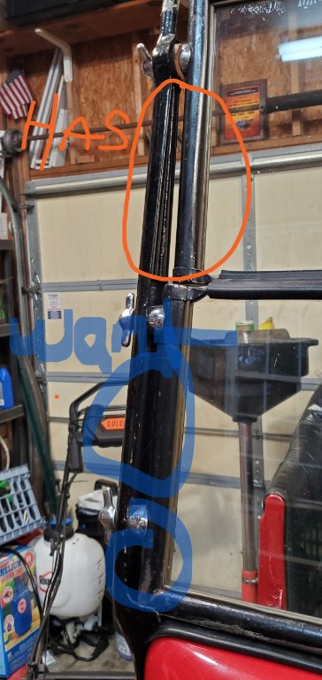

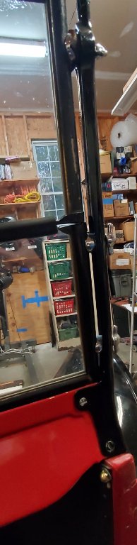

Here are what I have. I assumed the insert was to hold the rubber gasket so when it rains it will not come in between the stanchions and the windshield but here come some learning hopefully of not some parts!

Post by Mark Gregush » Wed May 03, 2023 9:12 pm
Looks like wrong bottom section has been installed. Someone may have used a 1915 to 22/23 bottom section which would be narrower. With channel the bottom glass would be about 10 X 38. The leather pads at top do not belong there, nore do the 4 cones on the bottom glass.

Post by Will_Vanderburg » Thu May 04, 2023 2:14 pm
The bottom frame is incorrect. A correct one is wider than the top one for your car. It should fit inside the stanchion. Only the top frame needs rubber to seal it on the sides.

Post by RVA23T » Thu May 04, 2023 3:05 pm
Thanks for the education, Seems I'm going to be looking for a late 23 lower windshield as well as a right stanchion.
The leather is there to give resistance to the upper windshield. Helps keep it in chosen position.

Post by Humblej » Thu May 04, 2023 3:52 pm
Richard, something is wrong. You may have two upper windshield frames being used there. If so you may only need a lower windshield frame. Your stantions may be ok, just an extra pair of holes drilled in them. That would also explain the leather in the upper frame piviot.
