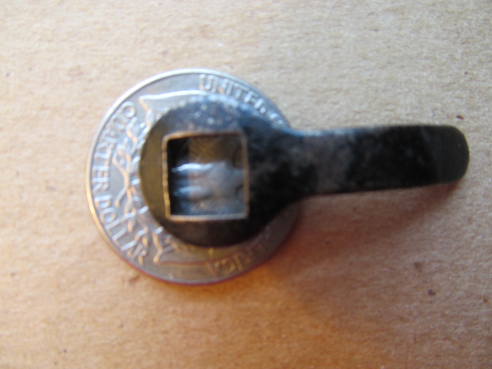

Modal T part what is it?

Top prop nut keeper. Not sure if that’s the right nomenclature.

Side curtain clip at the bottom on the windshield post. This one is broken.

Looks like it would make a nice wire holder

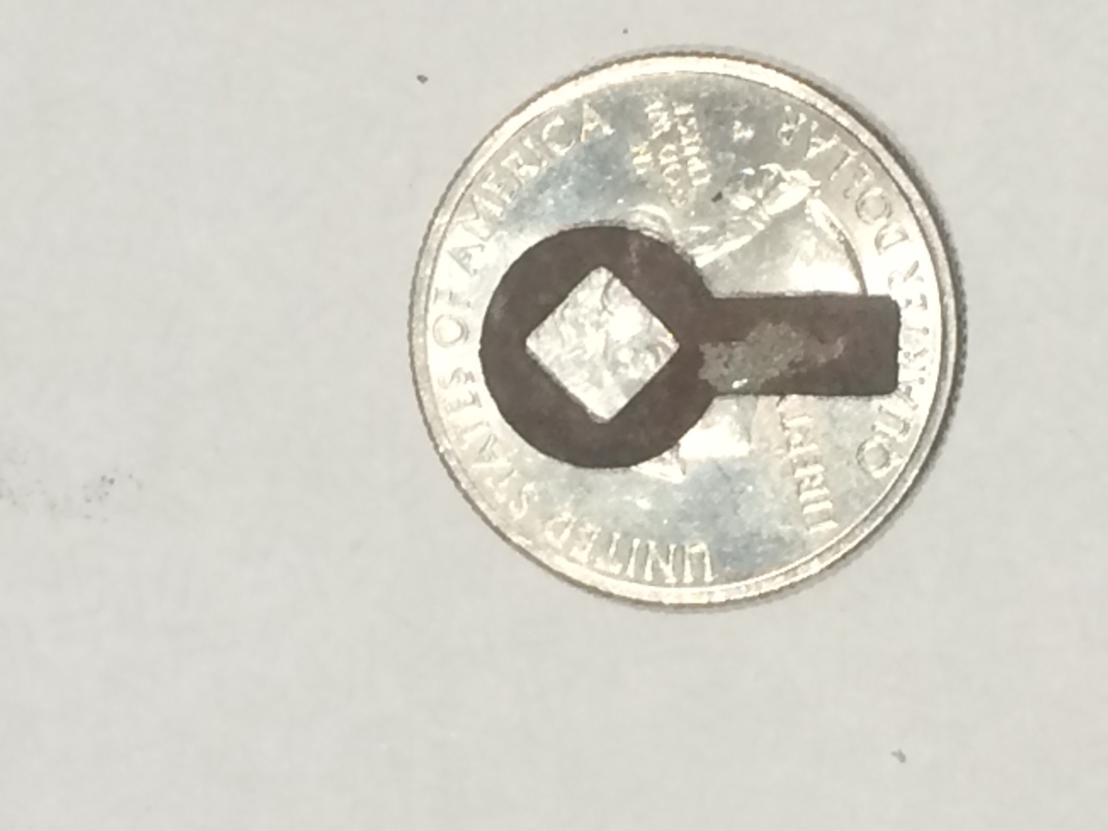

It's actually a two-part question. The answer to the second part is "an American 25-cent coin." (You're welcome.)

For open cars beginning in 1920. Before then, the side curtains were held in place with straps that went around the side lamps. In 1920, open cars that were equipped with starters and generators did not have side lamps, so Ford had to have a new way to attach them.

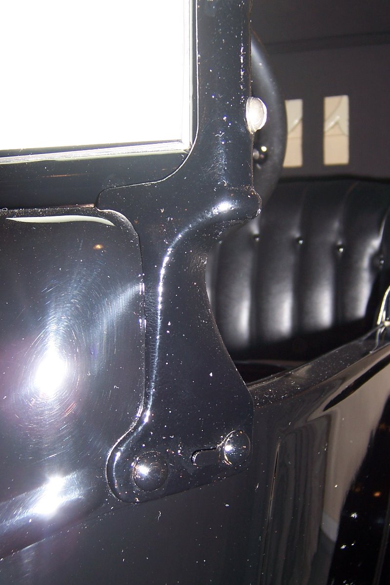

Dean's quiz part is too small to be a side curtain hook!
Try again....
Curtain hook for the stanchion.

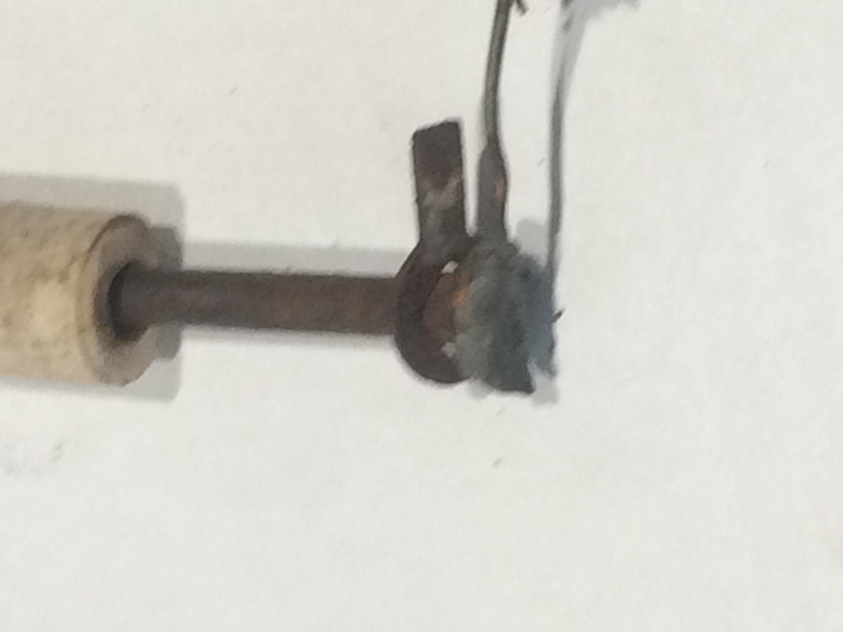

That one came from a coil box, keeps the bolt from turning ;)

Dean' example is lying on a 50 cent piece, not a quarter . . .

I guess my first post didn't show, that part goes in the coil box to keep the carriage bolt for the electrical connection from turning ;)

That's no half-dollar!
Read the legend on right side....
Hint....that little square hole is for a little carriage bolt, and seems to measure on the face of that quarter about 3/16"
Think I know that p/n & Fac.# and Parts Book description....using Holmes reasoning of deduction Dr. Watson :D

Rich - Take a closer look,....you'll see the word "QUARTER" on it!

I say also it’s from the coil box. One on each side connects the wires from the switch to the front mag and battery terminals.

Iornhorse got it correct
