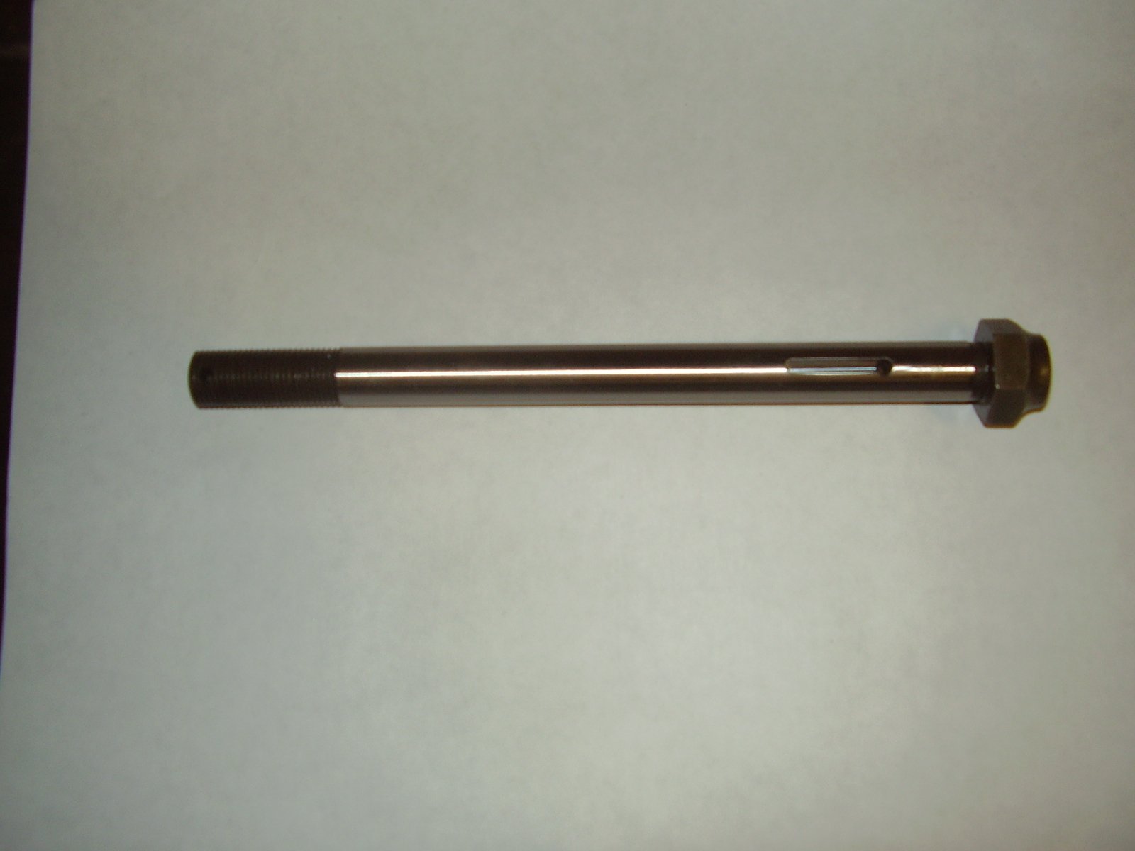

I suspect most of you are aware of this but for those who aren't (like I was) this is good to know. I recently replaced the spindle bolts (kingpins) in my front axle. Denny Newman used a Steven's tool to install cone-shaped top bushings in the axle so everything is now nice and tight. looking at the new bolts I observed that the top bushing covered the oil hole in the shaft. The only way oil can dribble down the bolt into the brass spindle bushings was to find it's way to the narrow split in the top bushing. A test showed very little oil making it's way thru.
Conferring with Denny Newman and looking at my old spindle bolts I learned the solution was to grind a small groove from the hole in the spindle bolt to a point below the top bushing (or if unmodified, the top axle arm) so that oil can make it to the bushings. The attached photo of my old spindle bolts should give you an idea what I'm talking about.

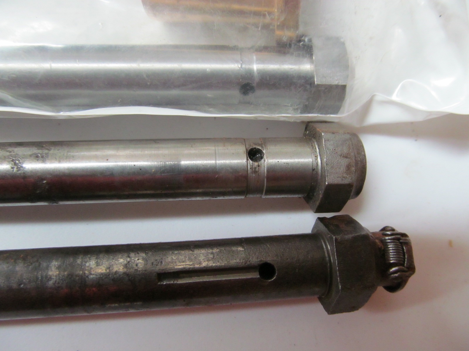

Mine came from Lang's - they had a groove around the circumference of the bolt at the level of the hole but not the longitudinal groove.
- Posts: 4084
Re: Spindle Bolt oil groove?
Unless you can find NOS Ford spindle bolts, they all have just a hole and circumferential groove.
BTY, your old bolts are the nice to have original spring loaded manhole type, the oiler with that manhole cap is integral with that king pin bolt.
Ford design vs. Repro re-engineered.
Hope the oil runs from that shallow circle!

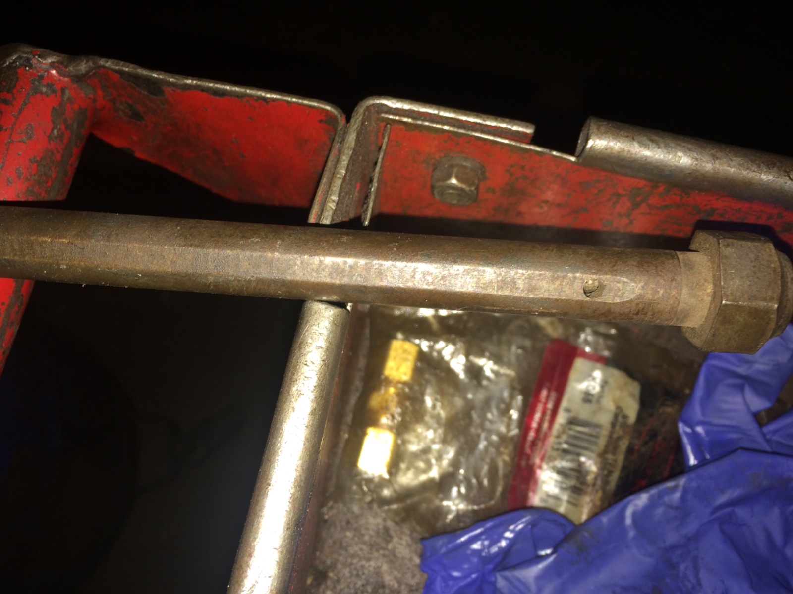

I robbed the oil cap from this bolt and noticed it has a flat spot down the whole side...

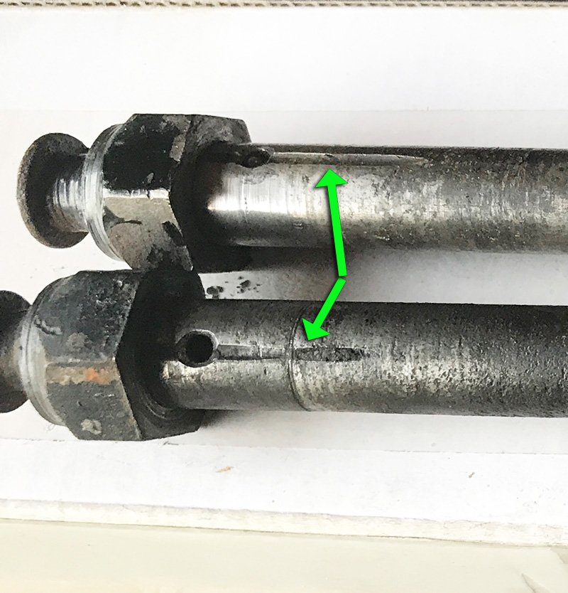

The ever-vigilant Chris B. spotted my confession and emailed me some hints. Here goes:

The photo that "Ruxstel24" posted, shows a spindle bolt that has a pretty simple modification that is the first one I've seen that seems to be a very positive means by which oil can find it's way to the lower spindle bolt bushing.

The bottom spindle bolt that Dan posted is correct. I guess from this discussion, that Ford started the long groove in 1915? Randall and I had this discussion several years ago, and it was then that he decided to start the long groove in his spindle bolts. It only makes sense. I personally don't believe a Zerk has any place on a Model T.
