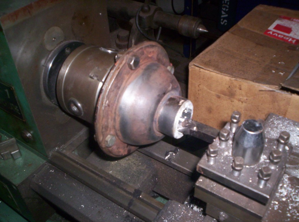

Post by Kerry » Tue Jun 13, 2023 6:01 pm
Tinned, poured and bored.
Looks OK is not the issue, working OK is, they are tinned for a correct bond, if not then all you have is a babbitt sleeve which will fail.
