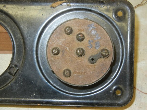

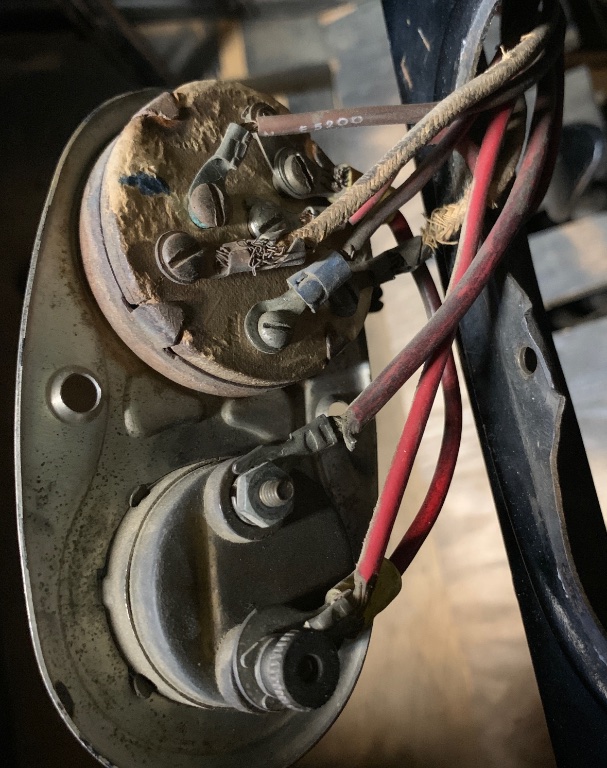

I'm preparing to rewire this 26 TT. The existing wiring is a bit of a conundrum. Let's start with the ammeter to switch panel. all the diagrams I've seen have the battery wire directly to the ammeter, then jumped to the switch, then back out to the car. (Solid Yellow to ammeter, Yellow black jumper to switch, Yellow black to wiring block on firewall). The existing wire has the jumper from ammeter to switch, but both hot wires directly to one side of the ammeter. The post looks to be designed for this purpose. Should I rewire per all of the diagrams and ignore this anomaly?

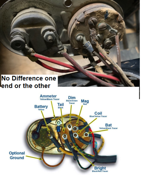

If you get a repro wire harness it may force you to wire in the normal,position because of the wire length. But your current wiring - makes no difference which end of the "jumper wire" you connect to.

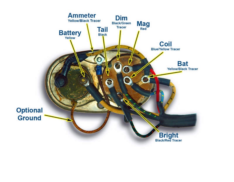

Thanks. So to be clear, on my existing ammeter, on one post, (the left post in the rotated photo), the ammeter is connected to the switch and the generator, the other post is connected to the battery.
My new harness is color coded like this. So, I'll just rewire to match these diagrams.

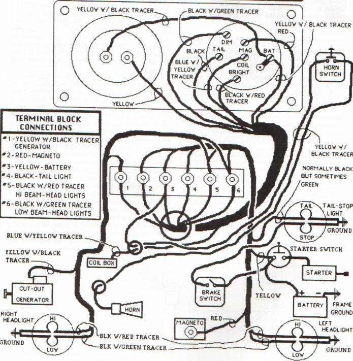

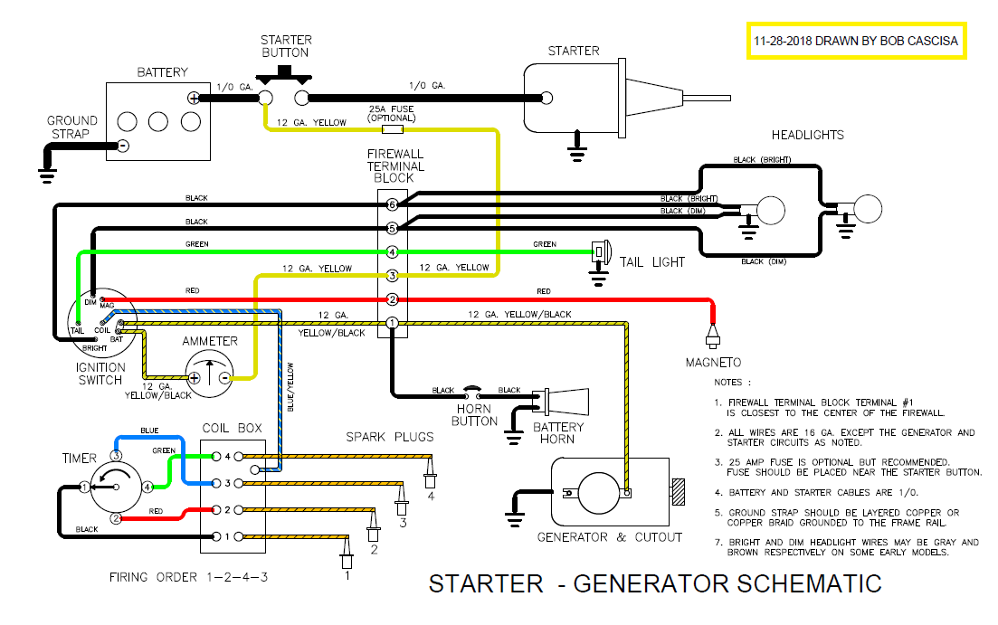

This shows correct wiring, colors, and wire sizes.

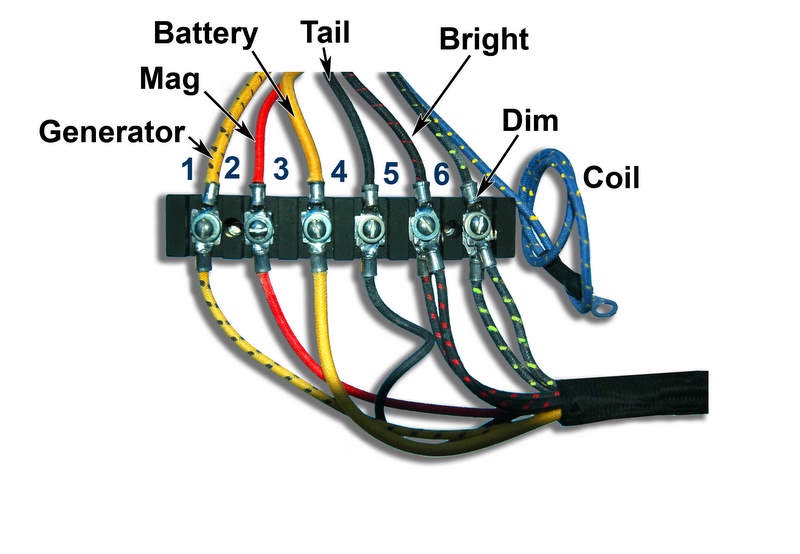

There is a difference between the photo and the diagram. In the Photo, the "bright" headlight wire goes to 5 on the terminal strip and the "Dim" to 6. On the diagram those two wires are reversed. Not a big deal but confusing.

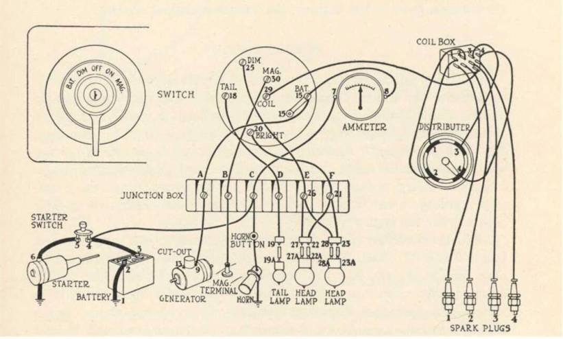

This drawing appears to be old but I don't know it's source. It shows the "Bright" on 6 and "dim" on 5 like in Ron's drawing. Either way you'd be OK as long as you followed thru with connecting the switch Bright/Dim to the same posts as the headlight's Bright / Dim.

Your current wiring is a mess. I would completely remove it and ignore everything about it. Install the new harness according to the wiring diagrams posted above. To do any less, would be repeating past errors and "work arounds". Also, forgive me if you already know this, but T's have a negative ground. I only mention it because maybe the person who installed your current wiring may not have known it.

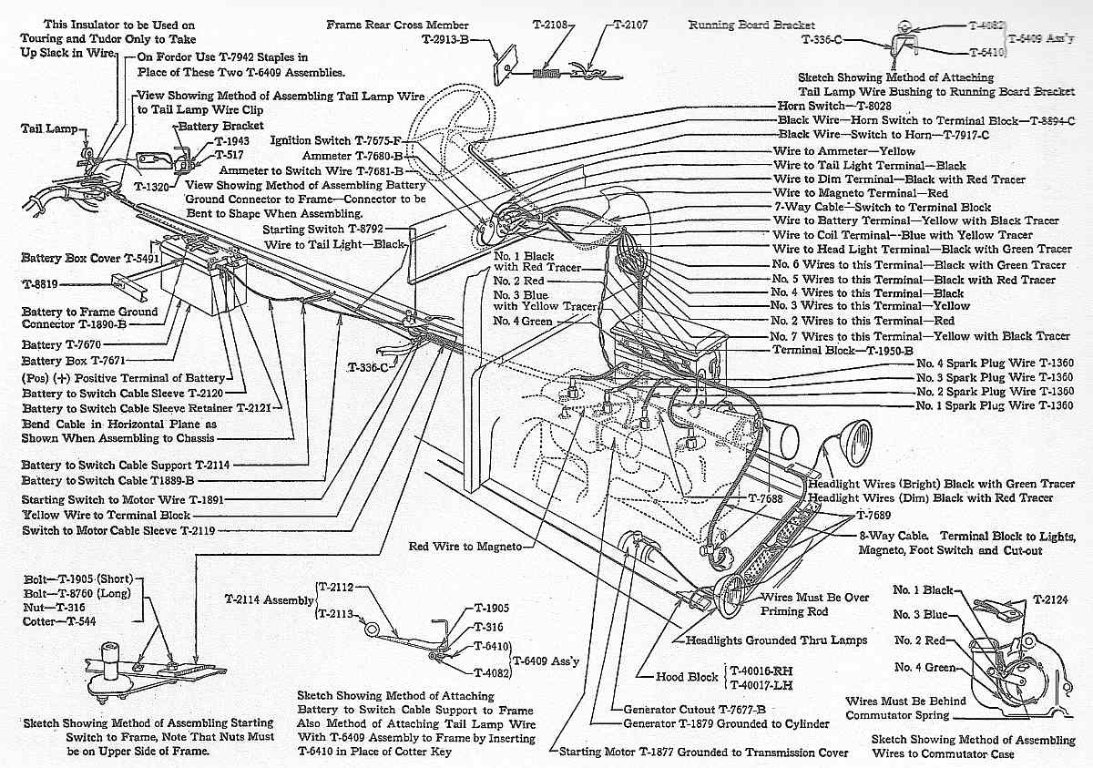

Diagrams for a '26
