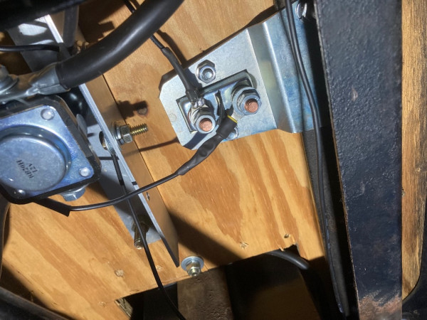

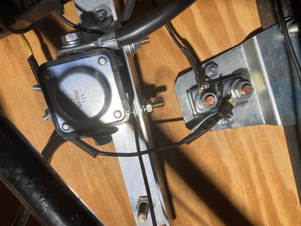

Mark, if you look at the attached photos, I have installed a starter solenoid. I’m checking the wire size but believe I put in #2 .
If you can give me some direction, I’m whiling to try anything. I’m tired of Hand cranking it. Don’t get me wrong, it normally startes on the second attempt.

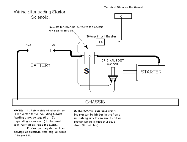

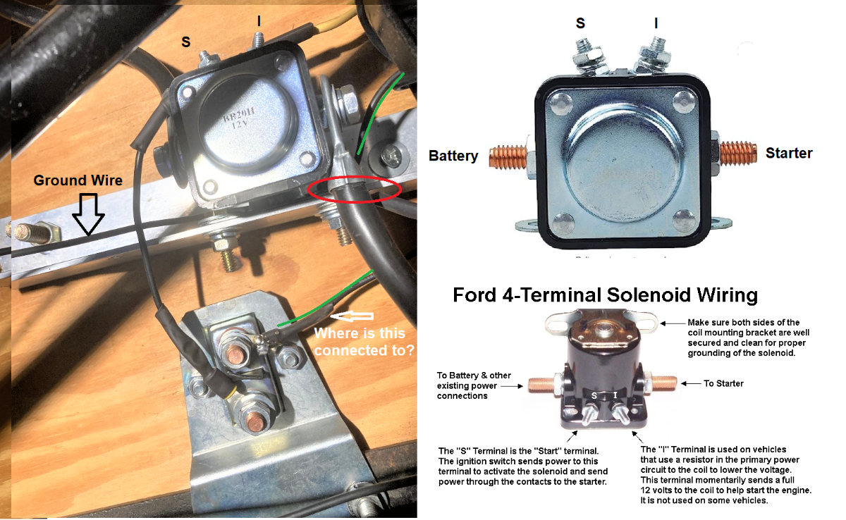

Starter solenoids with the S & I terminals for use with distributors. Ones with just the S terminal are less expensive and all that is usually needed. It doesn't really matter, just a cost issue.
The body of the starter switch is usually the problem if it is not mounted through the floor board at the proper height. Too low and when depressed doesn't make contact. Too high and eventually it bends forward and no longer is able to bridge across the studs to complete the circuit.
Some questions about your wiring. I have assumed that your started solenoid switch is oriented the same as is the images I added. That is the heavy wire is connected to the starter.
I highlighted a connection to the starter switch with a green tracer & wondering where it is connected to. If you look at the schematic below it just needed to connect to the battery post on the side of the solenoid. I red ovaled the cable to the starter side, can't tell if it touching anything. What is the yellow wire on top of the photo connected to at each end?
You can bypass the solenoid by just connecting a jumper cable from the battery + to the starter terminal on the solenoid

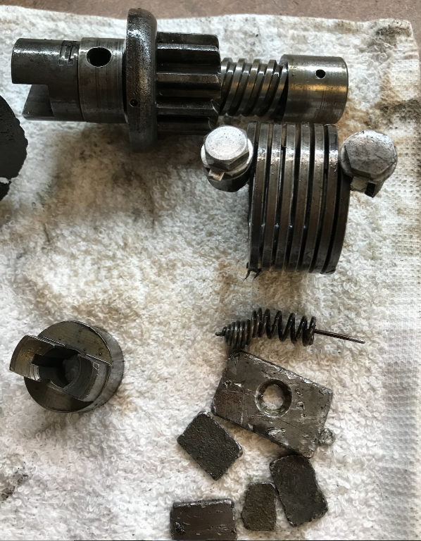

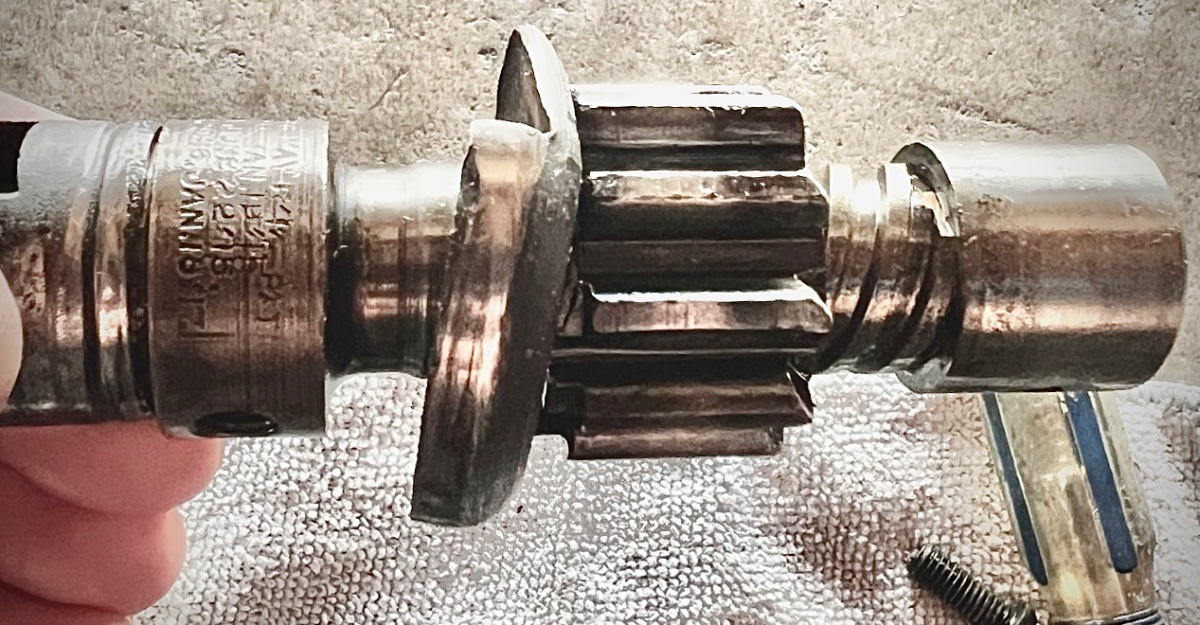

Installing a starter solenoid is a terrific investment, especially if you have a 6v car. it's literally the first mod I did when I first bought my car. I highly recommend it.
Apply 12 volts to 6v starters and they may seem to crank better but there is a hidden danger lurking. 12 volts slams the bendix into the flywheel at an amazing speed sort of like a speeding bullet into a steel plate. It is only a matter of time before the delicate bendix gives up the ghost and obliterates itself, or worse, destroys your flywheel ring gear by chipping a tooth. The worst is yet to come though. Once those bendix or flywheel parts go flying, all kinds of mayhem can ensue.
I'll attach a couple pics of what happens when you apply12v to 6v starters. I got these from various customers who all experienced multiple problems. The call I got last week was that the woodruff key was sheared off and required replacement. The starter shaft was also bent after that.
As always, your mileage will vary.

Jeff I'm glad you chimed in on this. Broken collars seem to be the most missunderstood part on a T starter drive. I see them welded, brazed &
staked in attemts to stop this from happening. Shouldn't the bendix nut contact the boss of the larger diameter of the shaft before the collar
collides with the ring gear? I find on most starter shafts this is in many different places. I have been machining a heavy washer to stop the drive
before it collides. At first I tryed correcting this with end spacing but have found some shafts that a 1/2" washer/spacer had to be installed. Is
there any merrit to this aproach? I do hear a noticeable quieter engagement & cranking when the collar is prevented from striking the ring gear
even the end of the starter itself.
Craig.

Honestly, I can't comment on this because I don't know. All I see is broken starter & bendix parts from 6v starters used with 12v. If you want to use 12v in your car, either buy a modern 12v starter or get a 6v starter that's been modified for 12v usage.
I've never seen broken bendix parts on 6v cars, at least that I know of...
