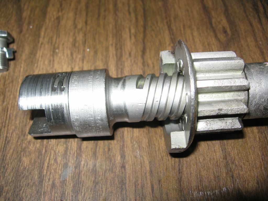

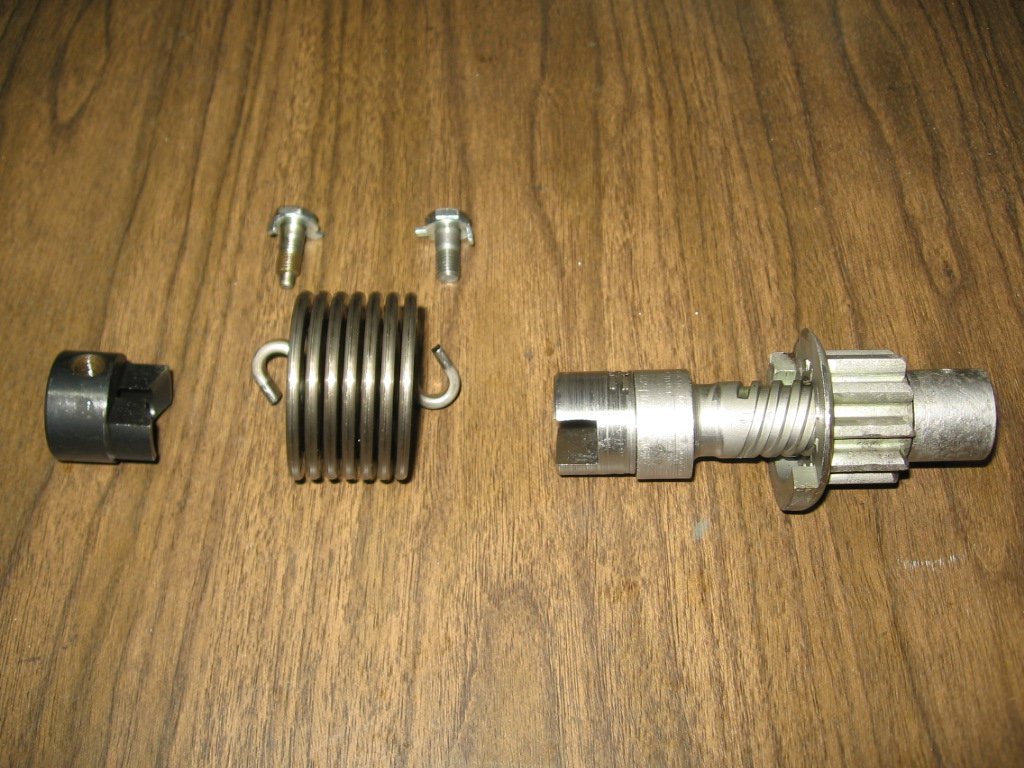

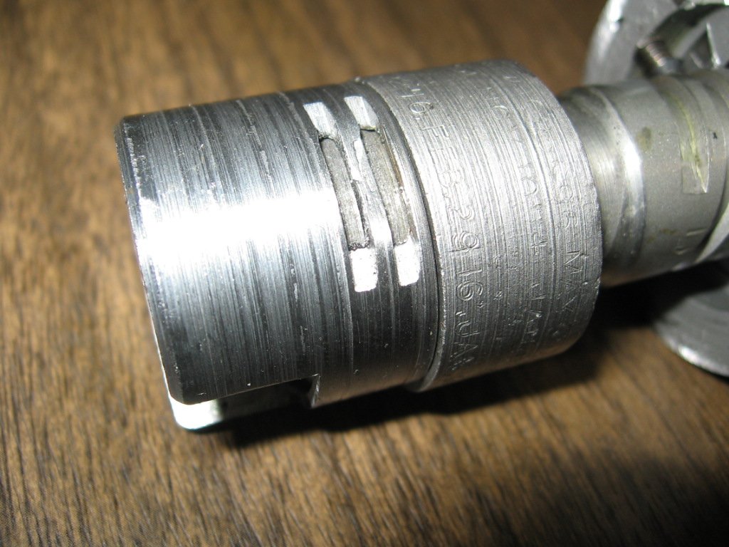

Re: Model T Bendix repair
You'll probably need a pick or very small screwdriver to get under the staked strips and pry them up.
Here are pictures of a partially disassembled Bendix with a closeup of the staked strips.
BTW, this support section of the forum is for folks having difficulties with the workings of the forum itself (like posting pictures, how to edit posts, etc.).
Questions about parts and repairs can be posted in the general forum section.
Thanks for those clear photos---mines different and the "new sleeve won`t fit. would mine be a different version? Not sure how to remove/ replace it? thanks for any input----Paul
I've never seen one like that, can any other members comment?
- Posts: 5470
That's an original sleeve - have to cut it off if cracked (Dremel works good) - should attempt to move this over to the regular discussion forum !
A slight crack at one "flange" (kind of visable on upper flange in the photo I sent). Guess I could weld it up, but prefer to replace it----Looks like the new replacement will require some thin metal inserts at the base ? What /where can I find these? Thanks!
- Posts: 4388
Paul,paulgriesse wrote: ↑Fri Jul 21, 2023 12:07 pmLooks like the new replacement will require some thin metal inserts at the base ? What /where can I find these? Thanks!
The new one requires nothing extra. Slip on the new sleeve, then simply bend down the narrow strip running between the two slits, (do this on both sides of the sleeve). This pushes the strips down, where they will engage with a slot in the Bendix shaft, preventing the sleeve from coming off. You'll see the slot once you've removed your old sleeve.
