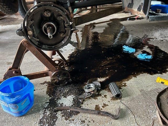

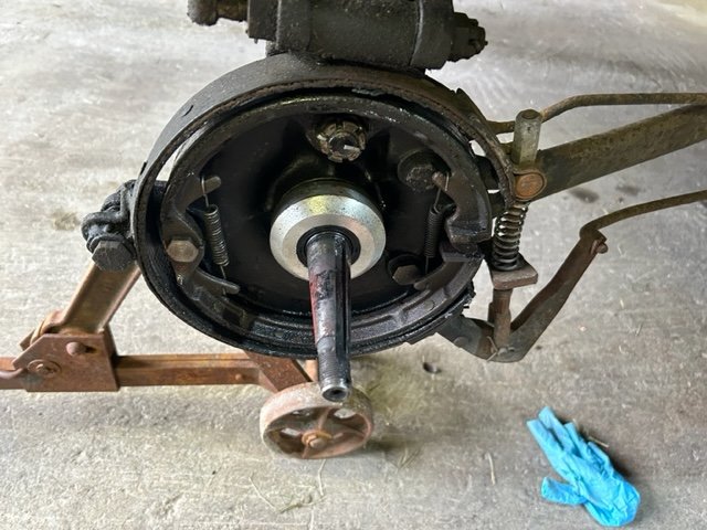

I noticed grease on my brake drums so I decided to pull a wheel and see what the seals looked like. A previous owner installed what looks like the neoprene seals. Both brake drums appear to have grease on them. Has anyone just changed the O rings and seals in these or will I need to buy a new set?

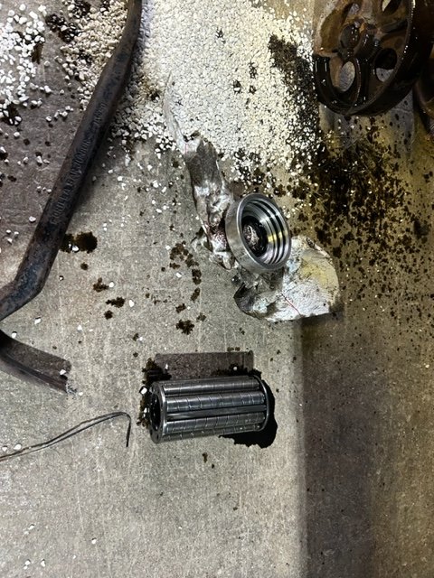

When I pulled the outer seal and the bearing oil ran out & there was no grease on the bearing. I assume the inner seal is bad. Is there any differences as far as the outer bearing area since this has a Ruckstell axle?

The seals are a standard type and just press into the aluminium housing. As for the O-rings, I'm sceptical of their effectiveness at sealing against the rough surface of the axle housing, so I use silicone sealant in that area.
I can't tell from the photo, but it looks like your axle keyway is very close to the lip of the neoprene seal. I've had problems with this and had to sleeve the axle to stop it leaking.

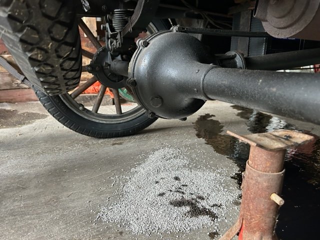

The oil that came out appears thinner than I expected. I would say it more closely resembles engine oil than 90w or 140w gear oil. That makes me think that there is a seal leaking and filling the rear end. I did not check the level before pulling the axle seal.
I lowered the end of the axle I was working on last night onto a jack stand before I went in the house. Tonight when I went into the barn I realized that this wasn't a smart move. Here is a picture of the differential fill plug. This looks like it's the "low" plug.
That would be engine oil leaking out at the ball cap and running down inside the tube to the rear axle. Keep your U-joint packed with grease.

Parts came in from Lang's today. Working on degreasing stuff and cleaning the brake pads. After cleaning the outer seals everything still looks undamaged and pliable. I'm going to go ahead and replace the inner seals and axle sleeves while I have it apart.

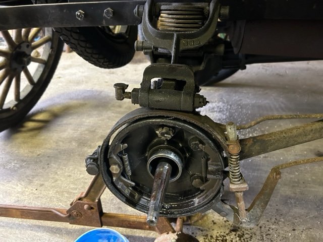

I have replaced the inner seals and bearing sleeves. It's back together. The passenger side outer bearing still had grease in it, so that was a positive. Thank you all for the info.
