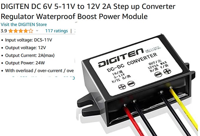

Fortunately it's easy and inexpensive to do this today. You simply need a current and voltage adjustable dc boost converter that can be powered from the 6V battery+generator and will charge a 12V battery at a constant current 'till it reaches a certain voltage and will then maintain that (or better still will drop to a 'float' voltage).
If you adjust this to trickle charge the 12V battery at say 1A that'd require ~2A from the 6V, not a huge drain - this is just a suggestion as you can set it to what you want, although you need to be careful of the limitations of the T electrical system. You'd also need to ensure it wasn't draining from the 6V battery when the motor is not running, there are many ways to 'automate' this, or you could simply use a switch.
Prices for such a thing start at around $3+ shipping for a small 10A-capable unit. YMMV a little in terms of how much the electrical noise of a T might affect such a thing, but it's an inexpensive trial and should be sortable, if needed.
There are other alternatives, including separately charging a 12V battery from the generator and then using a buck converter/regulator to the 6V system, but this would be more complex to set up.
Personally I'd just change the car to a single 12V system as it'd be the simplest and most proven thing to do.
Luke.

I use a 6-12v converter when I need to run 12v accessories in my T. The only thing I ever seem to use off it is the car fridge. The USB cigarette lighter converter plug I have still regulates perfectly well with 6V input.

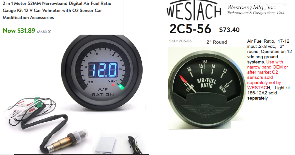

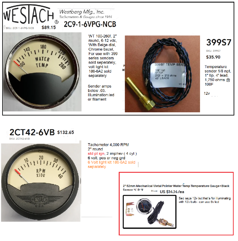

You said you want to add a wireless O2 sensor, temperature gauge and tachometer & running headlights, tail, brake & running lights.
Best to understand the total load on the electrical system from each component since there are options to go mechanical, 6v or 12v.
Keep in mind that many gauge's voltage specs are related to illuminating the gauge's bulb and not necessarily its sensor. In that case a 12v can use a 6v bulb or none to eliminate the load on the system
The following is just for estimates and others to chime in choices & calculations
The temperature gauge can have a mechanical sensor vs an electronic one.
Not sure what O2 wireless sensor you are referring to. The one noted below uses a 12v bulb but the sensor wasn't noted likely much less
A narrowband O2 (Oxygen) sensor only reads either rich or lean of Stoichiometric. Stoich is the ratio to completely combust the fuel. So a narrowband will only read rich or lean. It does not tell you how far away you are from Stoich.
Don't know what tach you have in mind but likely not much to drive it, just the illumination issue.

6v to12v boost converter with 2 amp output to drive sensors 4 amps
so either 8 or 12 amp load depending on bulbs
Charging a battery needs volts charge it (voltage regulator) available amps determines the length of time to charge (trickle charge vs Engine starter/charger.
So do the math or just settle for an 12v alternator

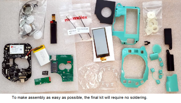

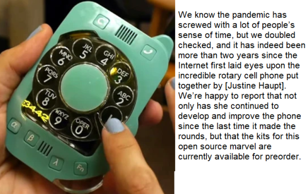

I don't know much about electronics but can muddle my way through with a bunch of hand holding.
The turn signal and running light are for safety the other stuff is just for fun. What I would like is to be able to read on my Iphone, O2 sensor, temp, RPM and GPS. The O2 sensor is so I know what is correct for lean, rich, read lots of good advice on how to set this by feel and sound but I want to see it until I know for sure, same for temp and RPM, I just thought it would be cool. An Iphone APP to show all this is the easy part, just ask my friend to write me an APP.
A project I'm working on now is a 1920's rotary candlestick "cell" phone for the Model T, have a working model just need to figure out how to get it into a vintage candlestick phone.

Feel and sound will serve you better than an 02 reading. The T engine probably runs best a little richer than stoichiometric, and in any case, ambient conditions and whether the engine is warmed up or not, engine condition, elevation, and just about everything else under the sun, will affect ideal settings. Making adjustments by ear and feel is easy and effective, and the convenient fingertip controls allow for ease of adjustment without taking your eyes off the road or your hands off the wheel.
A Garmin device uses very little power and it will give you enough information at a glance to determine RPM, along with speedometer and odometer functions and more. Stick it on the windshield or dash, feed it 12 VDC, and you're good to go.

Is there an interface device that will allow a rotary dial phone to work on modern phone networks?
Maybe some genius will come up with a really good AI robotic telephone operator. Just dial "0", and she'll connect you with anyone from satan to Jesus Christ anywhere on Earth ... if you have enough nickles.

I love gadgets too, I also like lots of info. I find ( oh god I'm not sure I want to say this)
that Moto meters are very unreliable so I install a Stewart Warner mechanical Temp. gauge in my T's so I know what the engine temp is.
As far as a tach they make a very inexsensive ( self contained) battery unit for rental & industrial engines that has a pickup wire that
wraps around a plug wire for the signal. and can be programed for 1-2-3-4-6-8 & 10 cylinders. I do not believe the tach will work on T coils
because multiple spark pulses will confuse it. I did not know there was a O2 sensor App. but non heated O2 sensors work off a 5.5 volt input
signal so 6vdc & a resistor should work. I think what you are looking for is a air/fuel ratio meter. They are 12vdc & mostly for tuning & racing
will run on a sealed battery for months on a charge and I think they may give you a lot of information that is irrelivant to Model T's. I use a
tach more to ensure I don't lug the engine to much rather than over rev it. As far as iphone apps most of us don't have enough thumbs to
drive a T & use a app @ the same time in a safe mannor. If you are new to Model T's I would like to make a suggestion. Part of the hobby is
driving very old cars like they used to. Try removing some of the seat padding, wearing thinner underwear & try doing it by the seat of your
pants. It's a lot of fun. I just did some racing with a onboard computer & I hate having a computer remind me just how bad I F---ed up that last

An 02 sensor would depend on a tight intake and exhaust system and a tight engine to provide
meaningful data. The location of the sensor in the system would also be critical.
Lacking a method of making continual corrections to the fuel/air mix, as would be available with a modern fuel injection system, most of the information would be of little use.
Running a T engine at the absolute leanest A/F possible is not desireable, since performance and driveability suffers, and over time, issues with exhaust valves and exhaust manifolds could be expected.
Modern computerized engines use an 02 sensor in combination with a number of other sensors and inputs to manage fuel mixture, spark timing, operating temperature, and EGR to minimize "emissions" and maximize fuel economy consistent with good performance.
With an unmodified Model T, you are both the sensor array and the computer/management system and the servo-actuator that makes the physical adjustments to meet the requirements of the situation.
