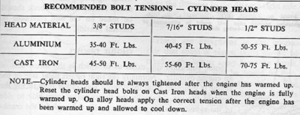

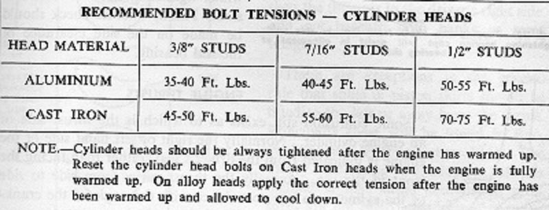

Gasket sets usually have instructions to do so and like many spec/tech books also but with out giving the reason why.
The types of metal expansion rates, example, in older engine design of a cast iron block and steel bolts/studs, you have about 15% stretch on the bolt when getting up to operating temp, if not allowed for in a re-torque when hot then when cooled down then you have less torque on the gasket which gives the posibility to leak or blow the gasket prematurely.

That "might" be good information BUT clearly specific to "studs" - no way I'm pulling a 7/16" Model T head bolt to 55-60 lbs.

Nothing clearly specific at all that it refers to studs, clearly reads bolts and as for the 7/16" at 55/60 is not a bolt problem on a T, we all know or should know it's the failure of the cast iron block that's the weak point, it strips well before a good 7/16" bolt breaks at 60lbs.

Sure appears that the chart you posted a photo of states "recommended bolt tensions" but just below under the size chart, it refers to "studs" - perhaps that might be a language difference between our English & yours ?
So, why would anyone pull a Model T head bolt to that torque ?
