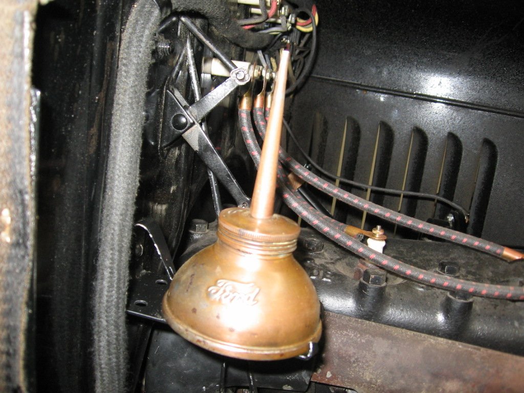

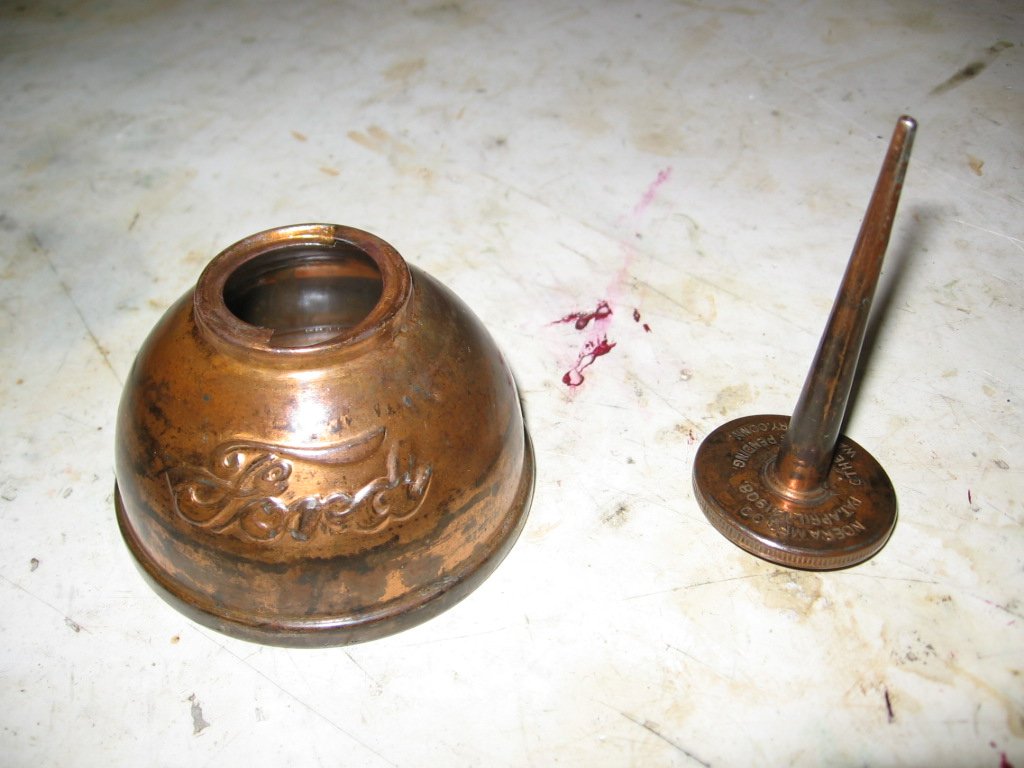

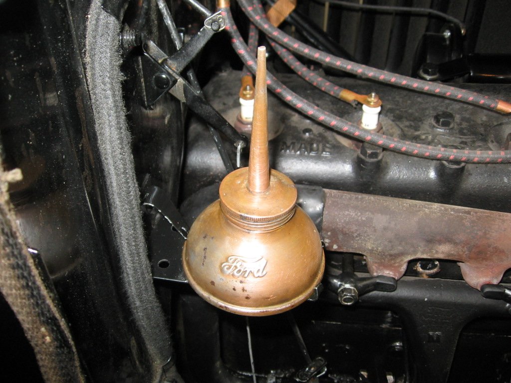

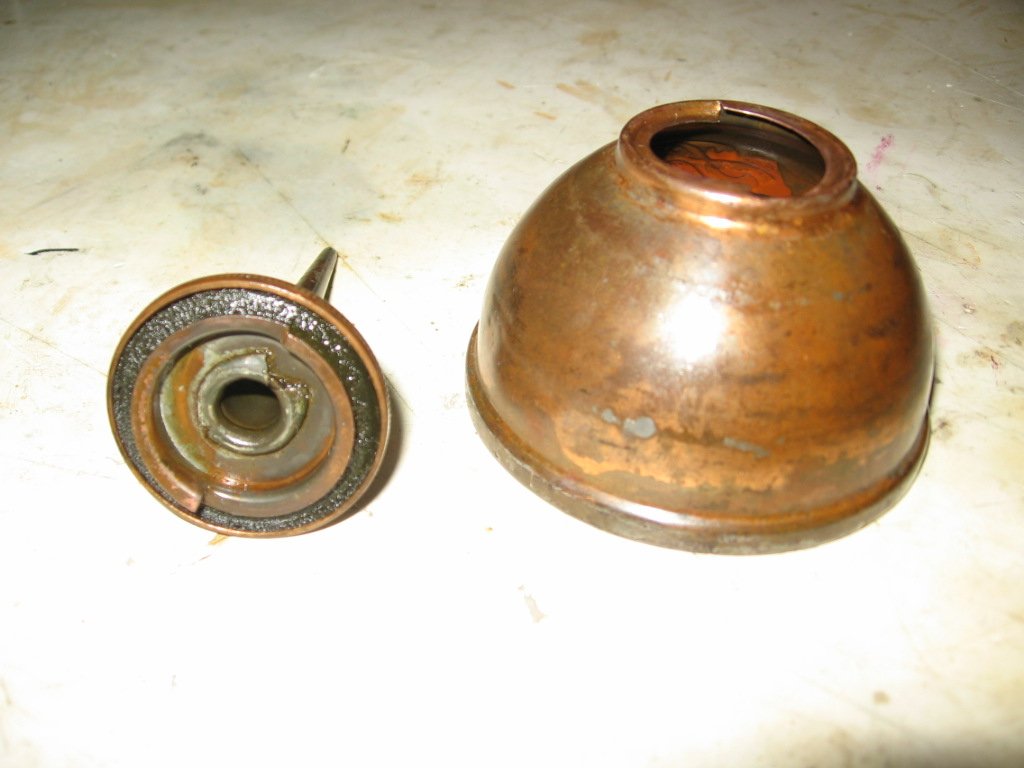

Examples of threaded and bayonet spouts are shown below. I do not have any oil cans for sale at this time.
