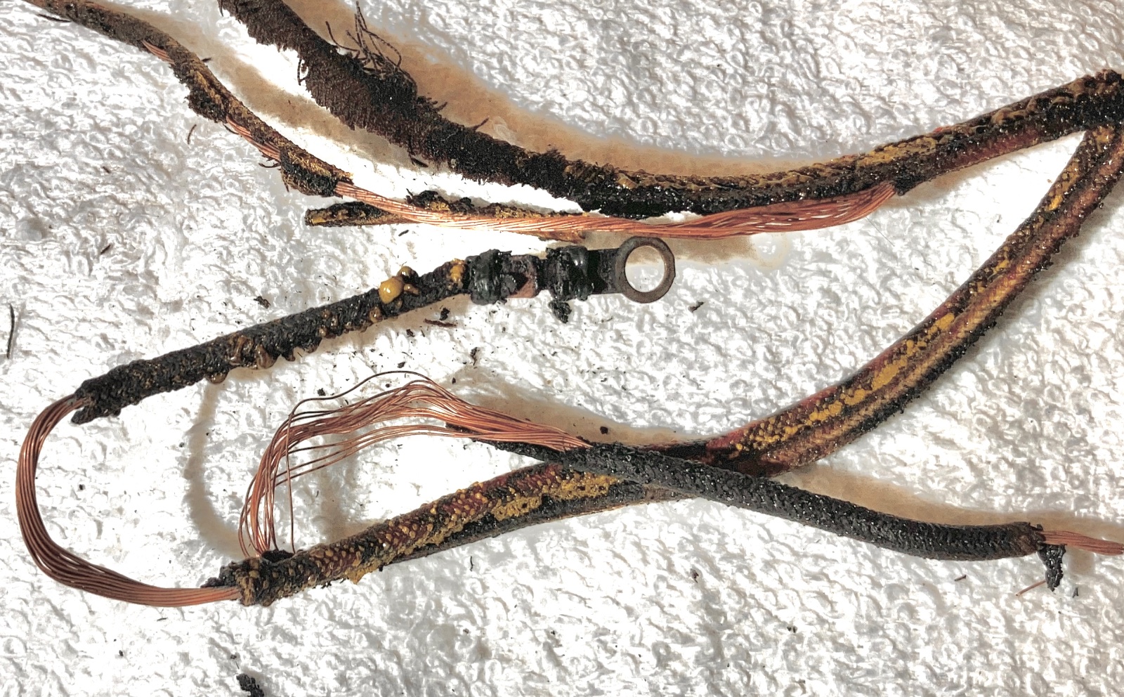

After having my car almost burn to the ground due to a short in the electrical system, I proffer here that it's more advantageous to have an inline fuse located at the battery in your T than not. I'm shipping an in-line 20A in-line fuse to be installed with my voltage regulators I sell, but this applies to everyone, voltage regulator or not.
I submit the following picture of the burned up Model T wiring harness from MY Model T into evidence as exhibit A:

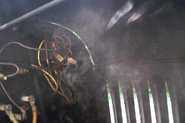

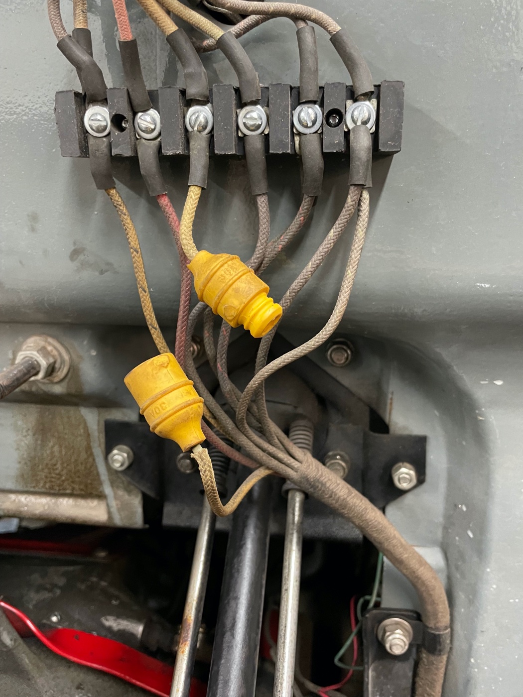

Have also 'smoked' a wire on my Ts, twice! Once was the short ammeter to bat terminal yellow/black wire on the backside of the dash switch, it was fray I guess from age, but smoke poured from under the dash running down the road! Yikes.
Second time I had just installed an accessory dash lamp, the clip on type for 26-27 panel. Fed the wire between the dash and switch, thought there was gap, but no, shorted and found smoke in the garage coming from the '26 pickup! Bad by me, but saved by going back in the garage at luck time to find the smoking T, had there been a fuse, no scare, but that made me sure to add a fuse to all my T's and any friends that I do fix up on theirs too.
BTW, Ford originally put a FUSE in the first electric start systems installed in 1919, but then deleted it. Think that was short-sighted! (Pun intended)

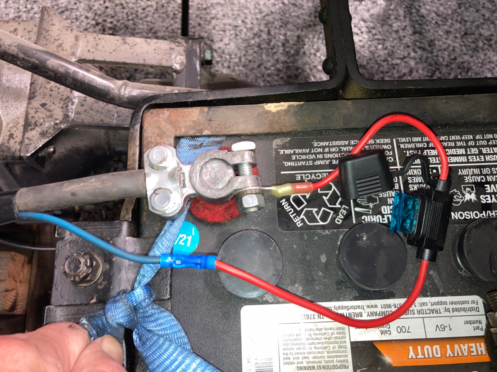

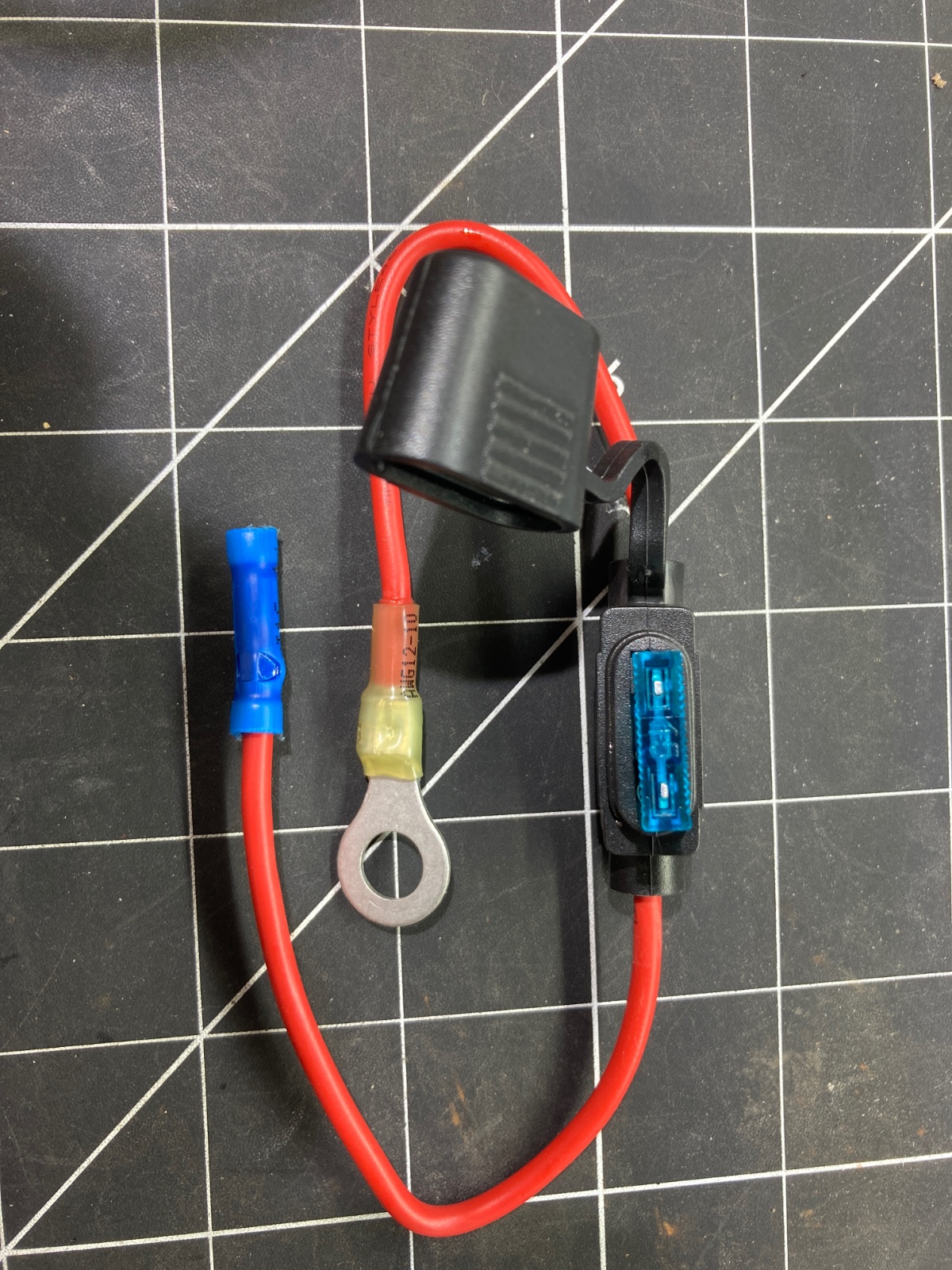

Here's what my inline fuse looks like. 5 minute install. If your power for the car comes off of the starter foot switch, install it there instead.
I'm providing one with every Voltage Regulator I sell. Cheap insurance!

Post by DanTreace » Wed Sep 06, 2023 4:44 pm

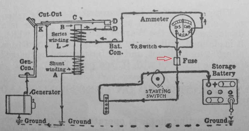

Well, the decade of the starter/generator Model T did provide for safe electric products, note this fuse for Ford.
And a fuse will prevent this:
Engine Fire.jpeg (52.85 KiB) Viewed 3229 times
(photo from a forum poster)

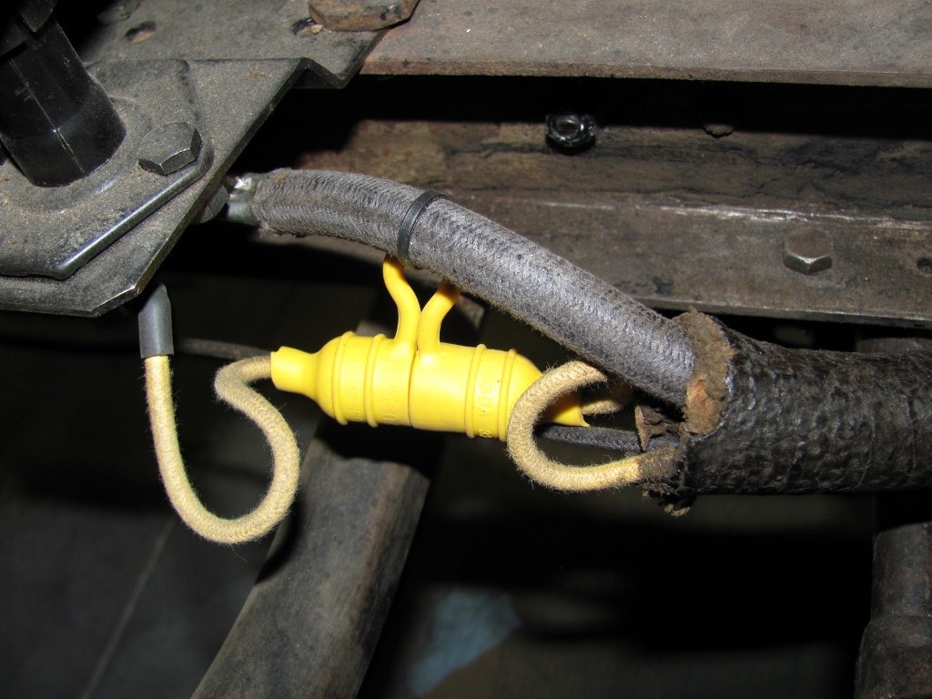

Here is my 'quick disconnect', fuse on the Yellow Bat wire.
Makes it easy to work on wiring or terminals at the switch or other places, removing the smoke making juice from the battery :)
THAT is super interesting. I always wondered when the glass fuse era started. They havent changed much and they are still in use in some applications even today.

Post by jiminbartow » Thu Sep 07, 2023 10:50 pm
Dan. I was looking for a photo I posted of my yellow fuse holder next to my starter when I found a 2012 post, posted by you with a similar picture. Here is an attachment you posted in 2012 along with the photo of the installed fuse next to the starter you have posted on this thread. It shows how to install fuses at the block. Jim Patrick
