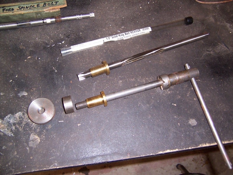

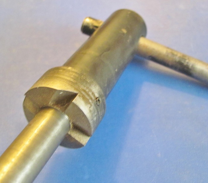

Mine is an older copy version from a out of business concern, of the Stevens unit. Works well. Has a knob at the bottom, fit to a small key and keyway to lock the bottom fulcrum disc, you then turn to tighten the reaming pressure, checking as you go for the amount of material to remove.

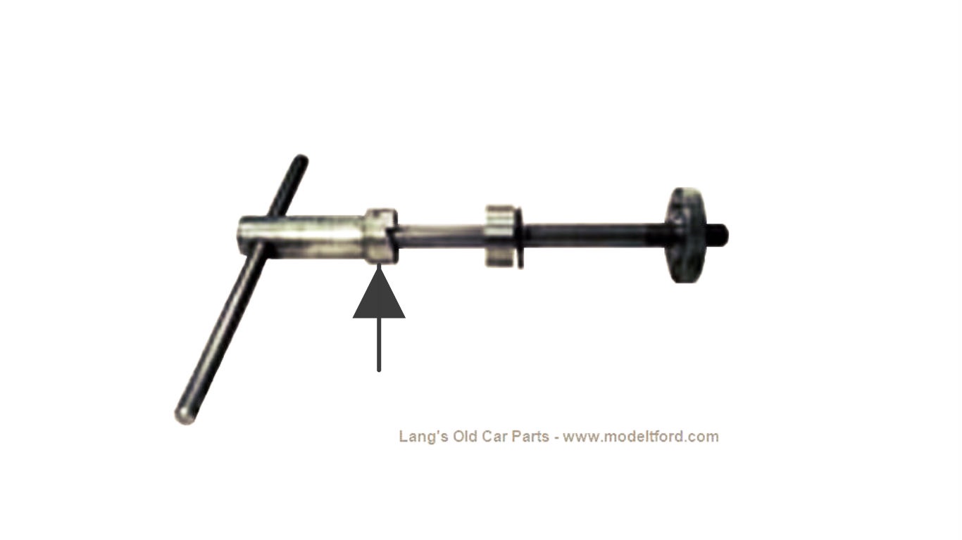

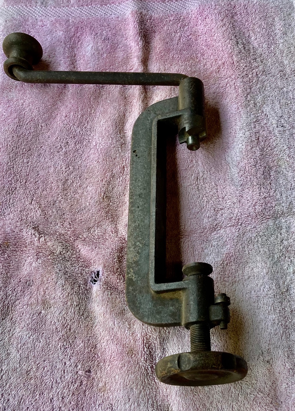

Got this one from Snyders. I used it in my drill press and it worked great!

I have the tool like Arbs has as above. I wish someone would reproduce the Stevens tool like Dan has.
