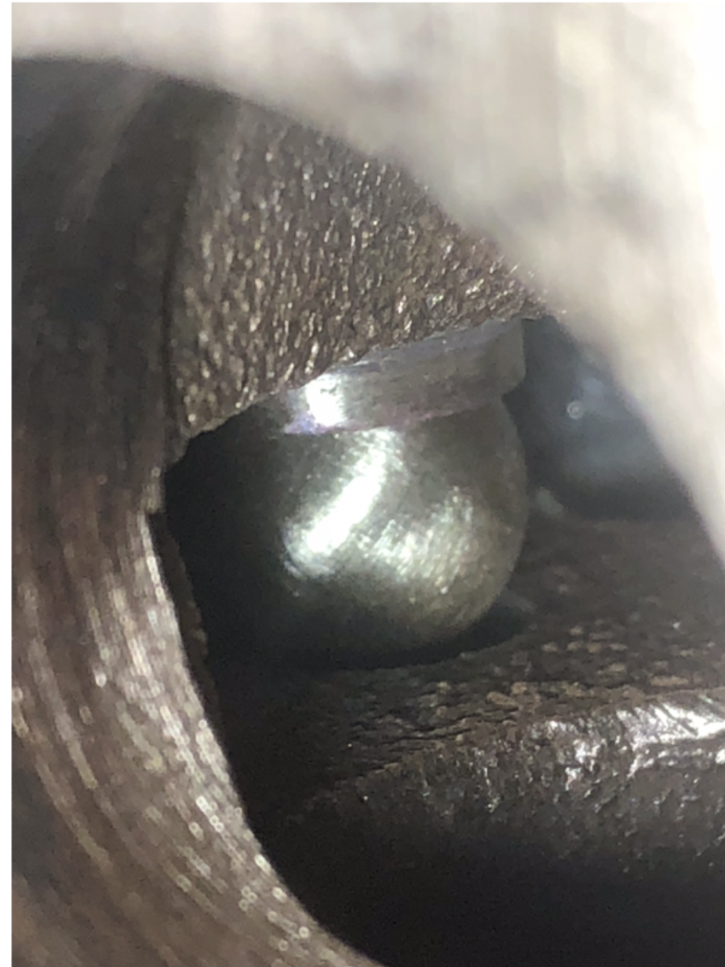

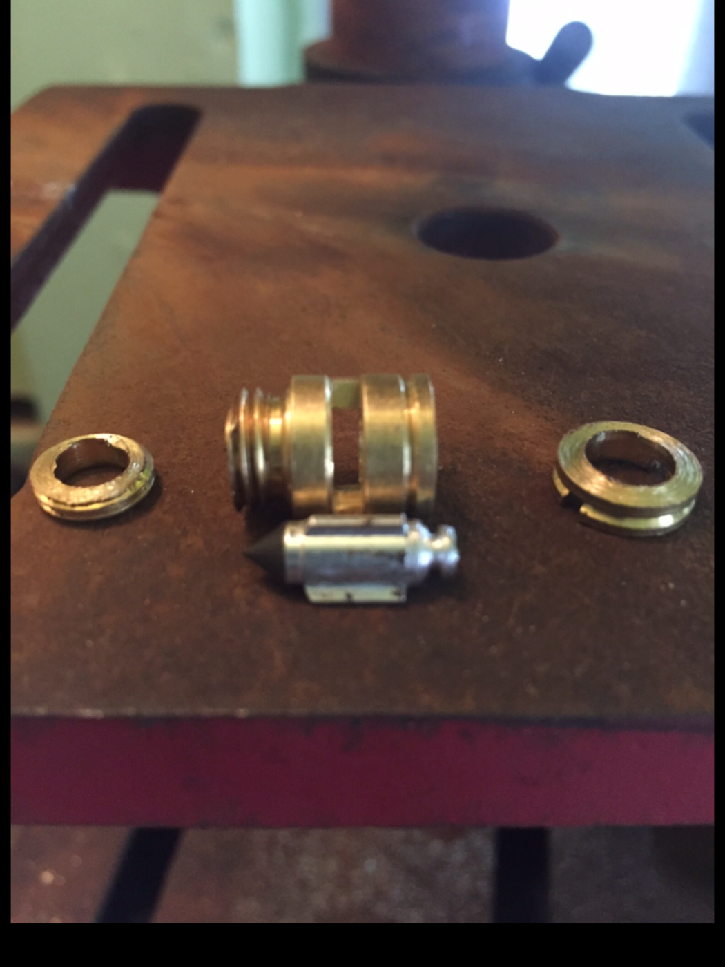

Michael- I bought one for my 14 from Russ Potter in 1994 or 5 and used it exclusively until 5 or 6 years ago. They seem to be good running carburetors, I think the original float valve setup is a drawback but it can be replaced with a modern one.

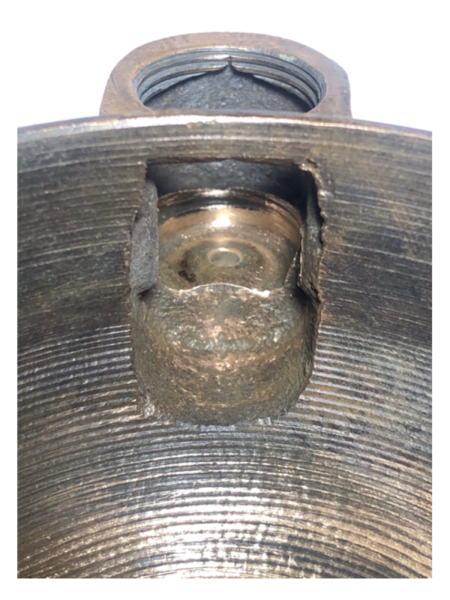

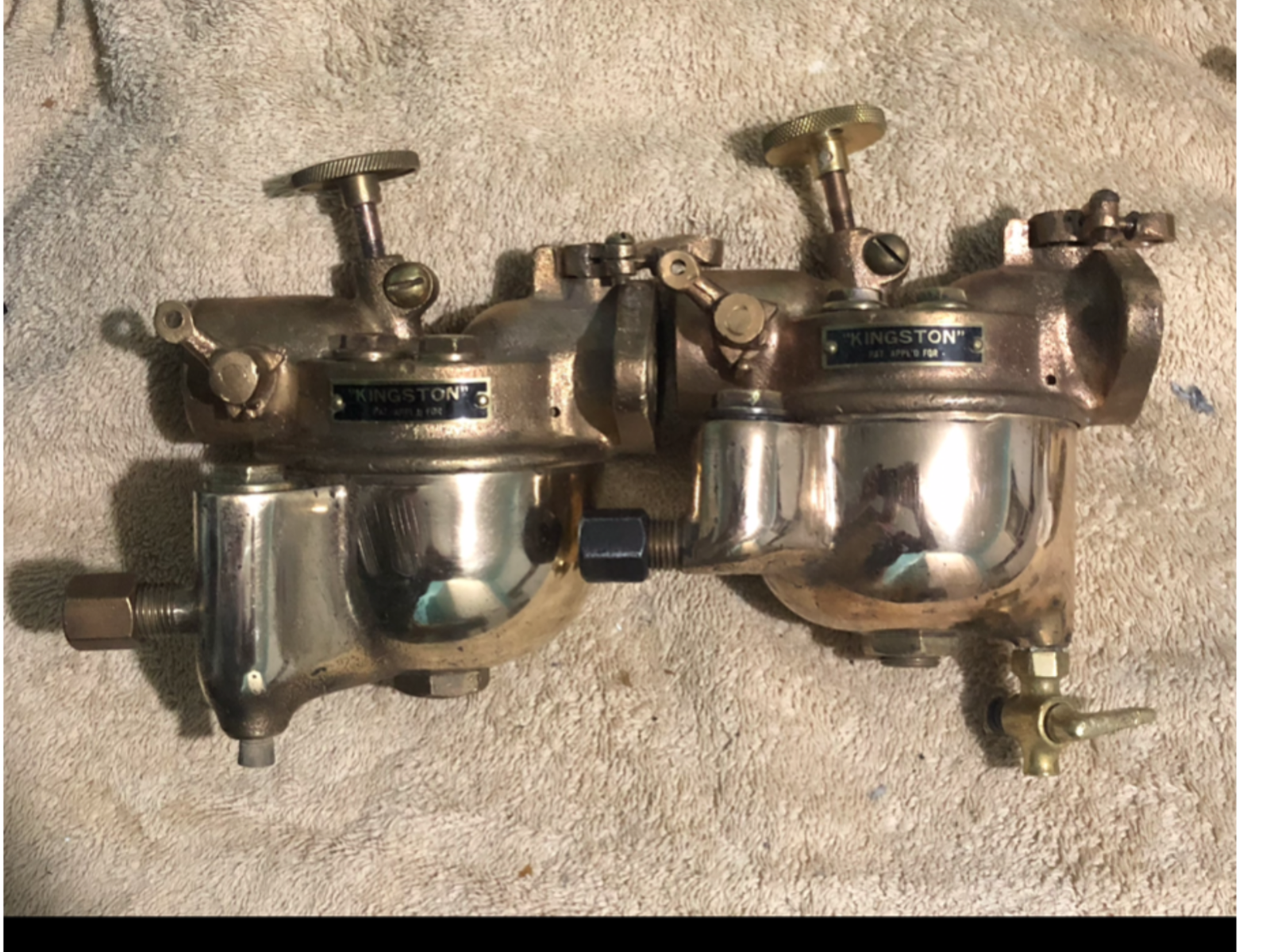

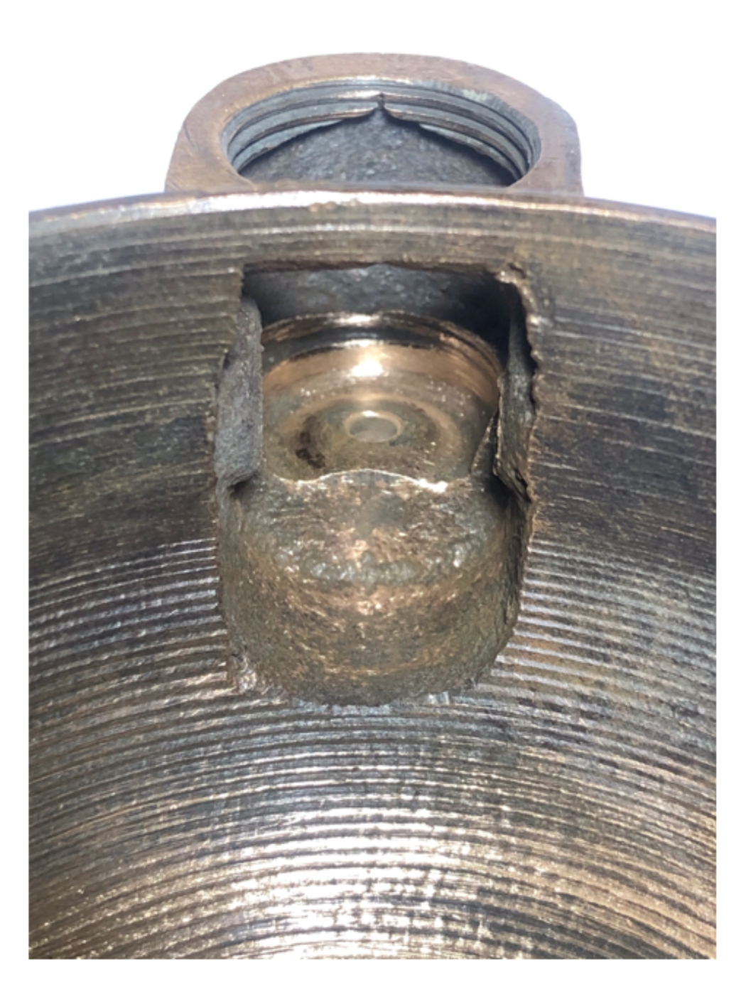

Martynn- I’ve got plenty 4-ball pictures I can post tomorrow. There were 2 different bowl designs. The carburetor on the left has the original Kingston mixture adjustment knob with the slanted knurl unlike the diamond of the Holley. Neither have the correct petcock.

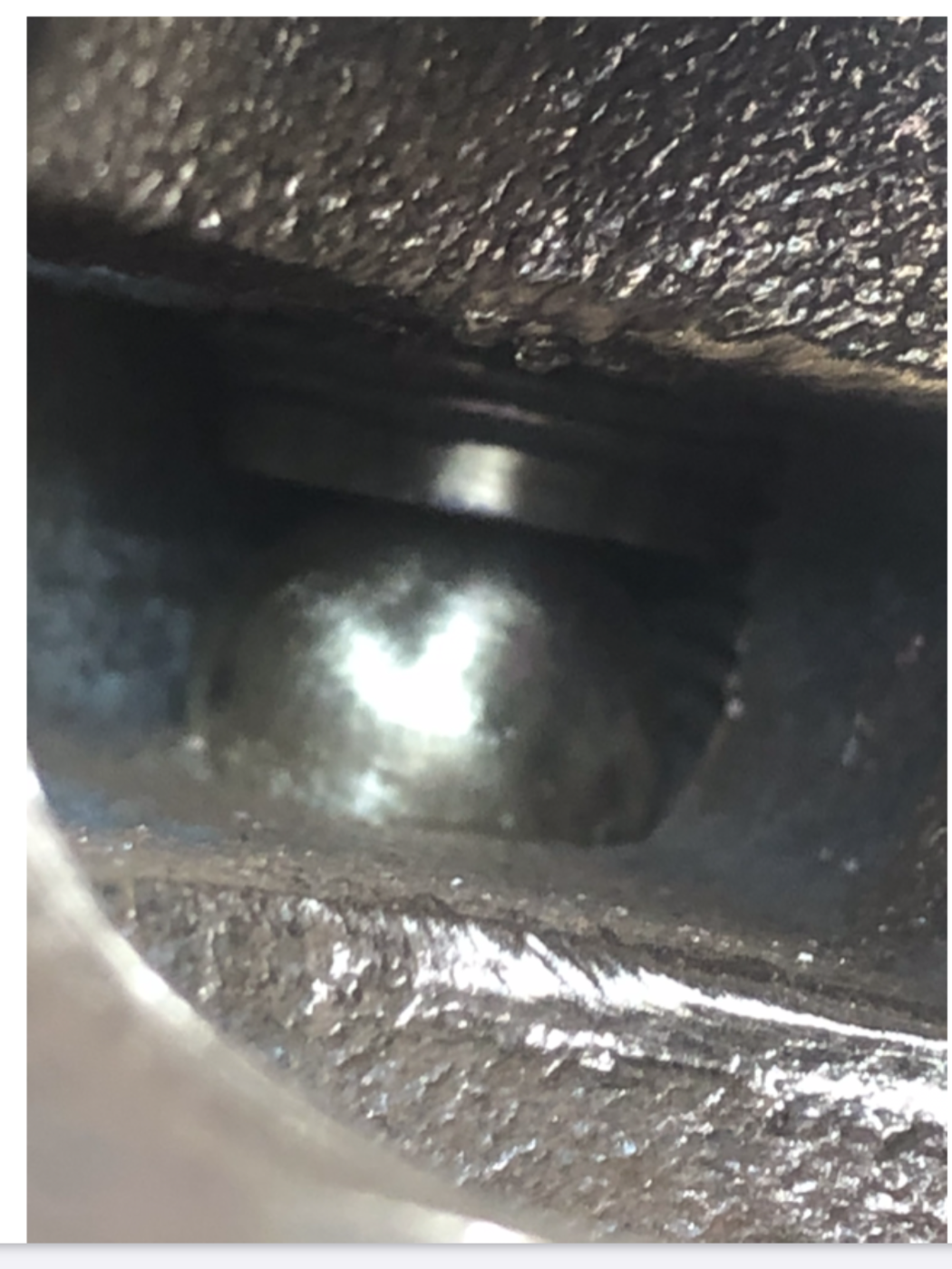

A couple of pictures one of the balls in its seat and in the raised position.

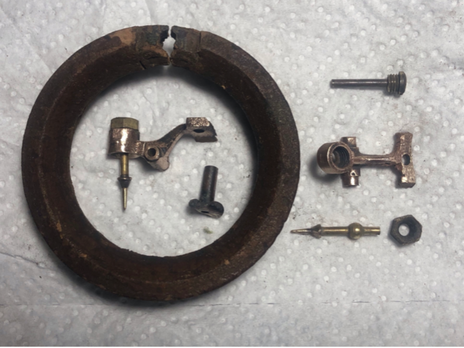

Then the original float with the lever assembly pictured assembled and disassembled.

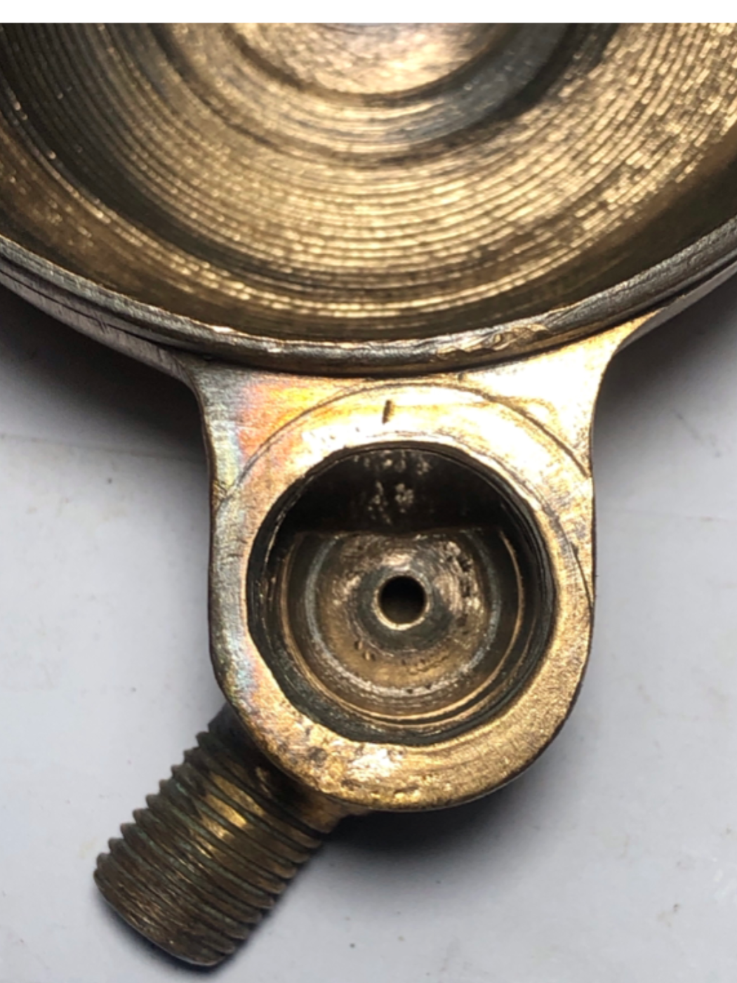

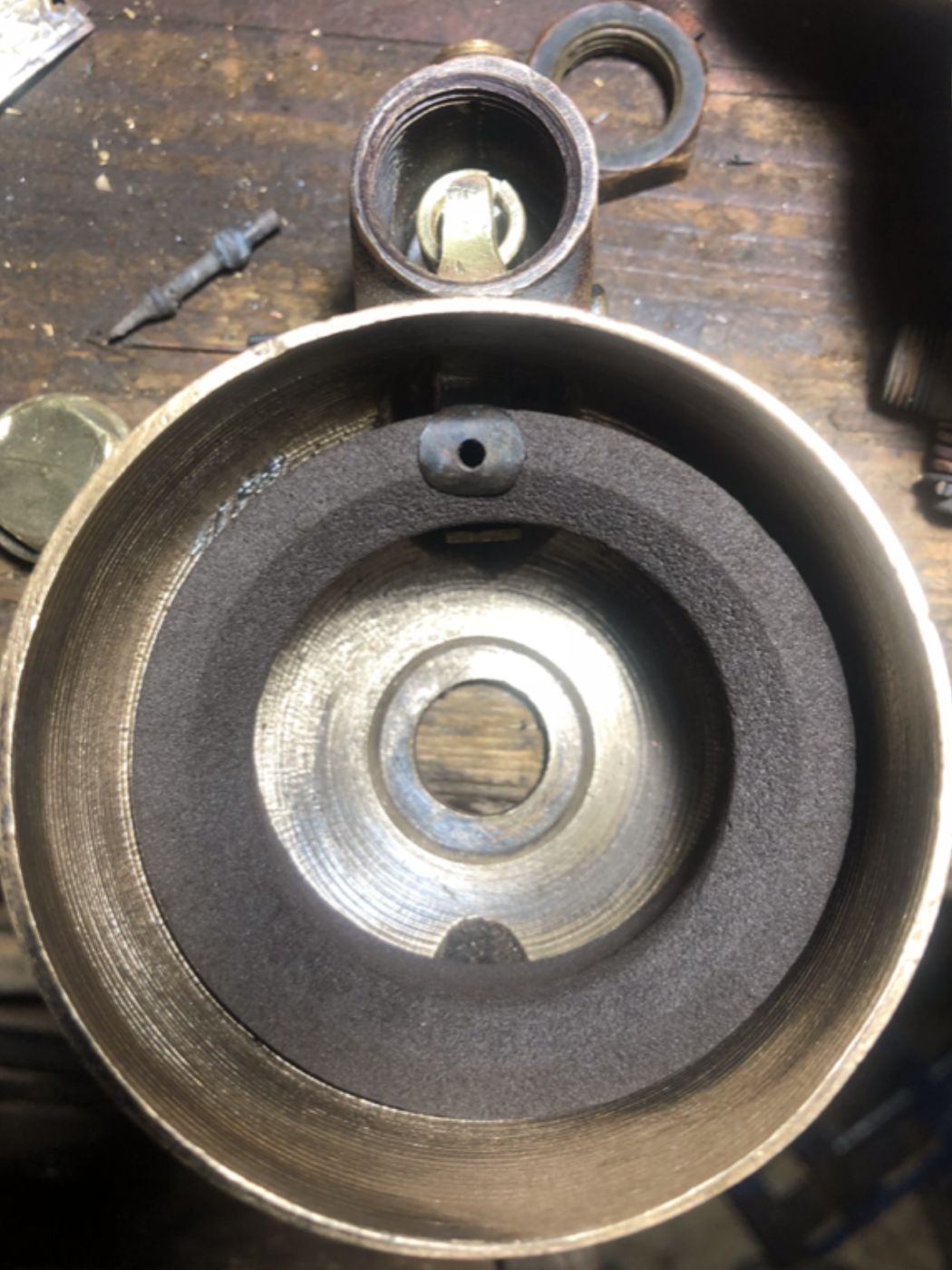

The original non-replaceable seat and how you can modify it for a modern float valve.
