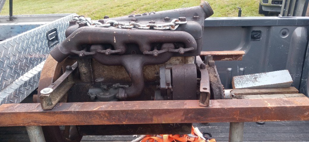

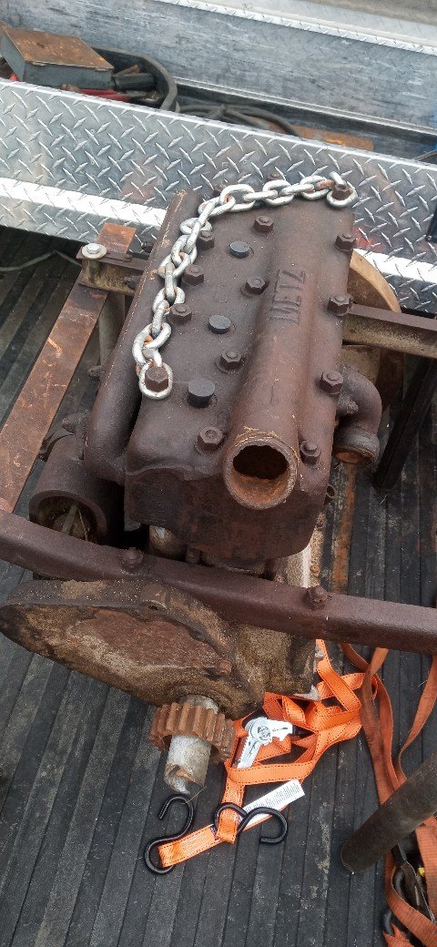

Came across a engine at a swap and from a distance thought it was a Model T.
Turns out it was a Metz very similar to a Model T

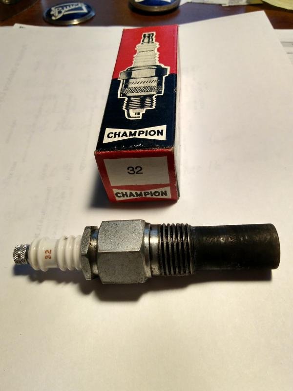

I have heard that a Metz head will bolt onto a Model T block and provide a compression ratio increase. One caveat is that the Metz head uses a very long reach spark plug, like a Champion 32.

Mark that’s a good point on the spark plugs. I’ve searched and need 4 but have not seen any for sale. So what do you do if you have a Metz engine?

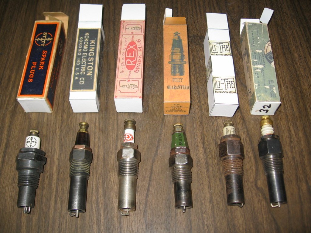

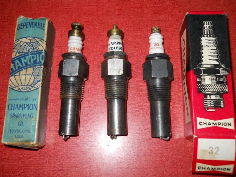

Re: Model T copy Metz engine

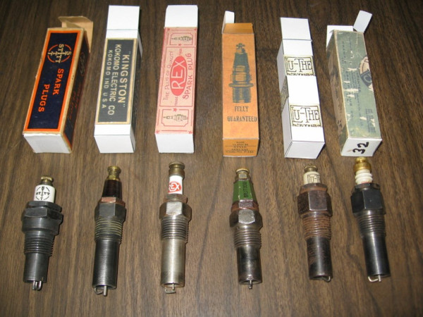

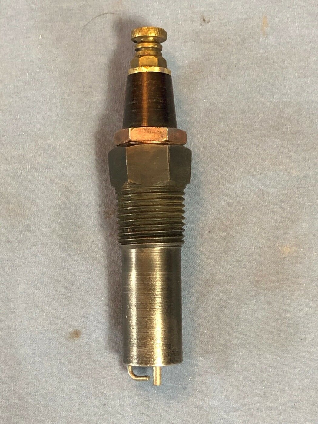

There is one Metz compatible plug on Ebay right now, priced in accordance with its rarity (I have no connection to the ad or the seller):
https://www.ebay.com/itm/175810480672?h ... R6qt4f7YYg

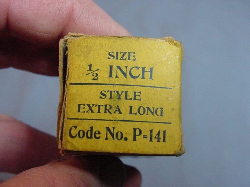

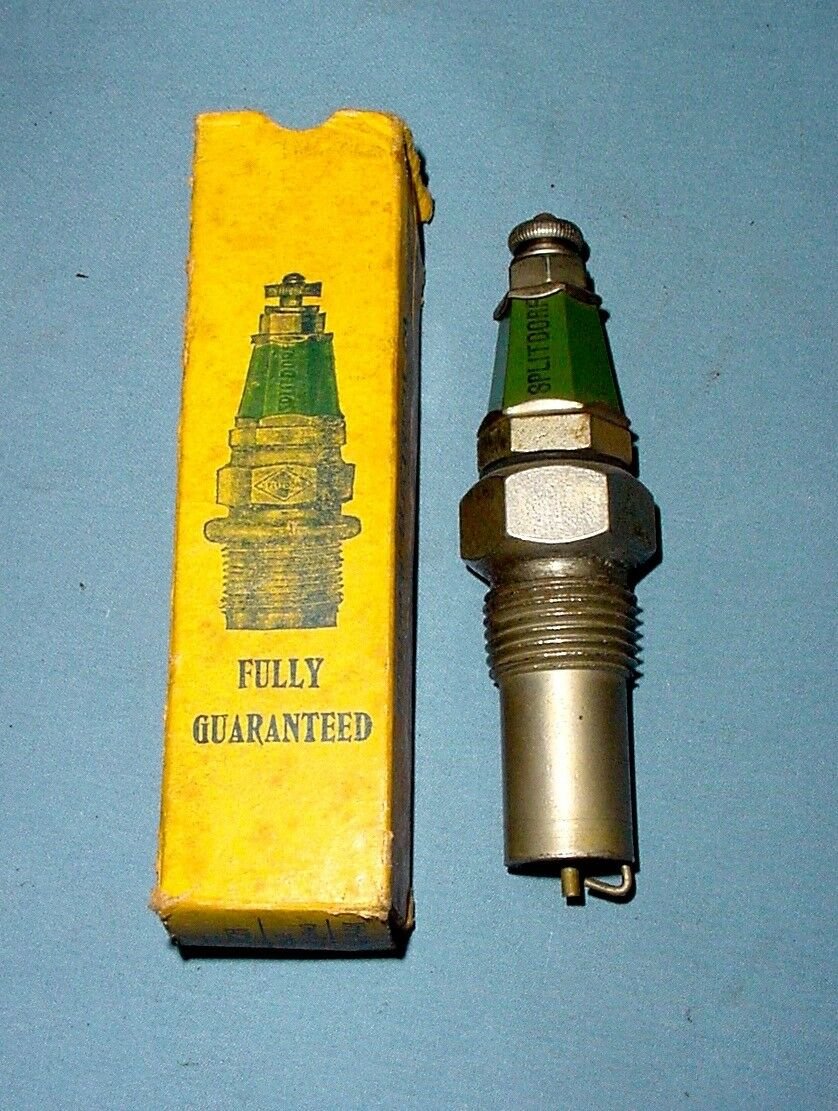

Splitdorf P141 is another Metz plug, as are some of the others shown in the pics. I have owned them all at one point, but sold them and I don't have any left.
Getting a matching set of four of any brand would be a big challenge, you'll likely have to mix & match.

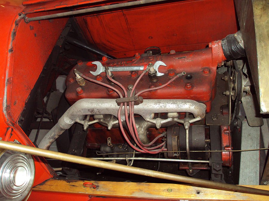

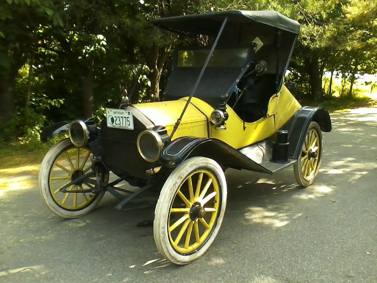

They are pretty wonderful little cars. And the engines are so similar. We were lucky enough to make this one run a few years ago.
A T head on a Metz engine will have lower than stock compression ratio, hopefully it would still run.
Champion 34s and some other plugs that were originally designed for Maytag washing machine engines might work, but their reach is still shorter than the correct Metz plug. I think the shorter reach plugs in the picture in my post are plugs for Maytag washing machines.

Threads are 1/2" pipe, like a Model T. The straight section below the threads is around an inch, I can't say exactly because I don't have any examples any more.

The Metz head is different on two bolt holes, the need sleeved and redrilled to make work, close friend has one on his car, he also counter sunk the plugs deeper so special plugs are no longer needed, it did up the compression a bunch, he said if he had to do it over again he would just run the Hi compression pistons instead!

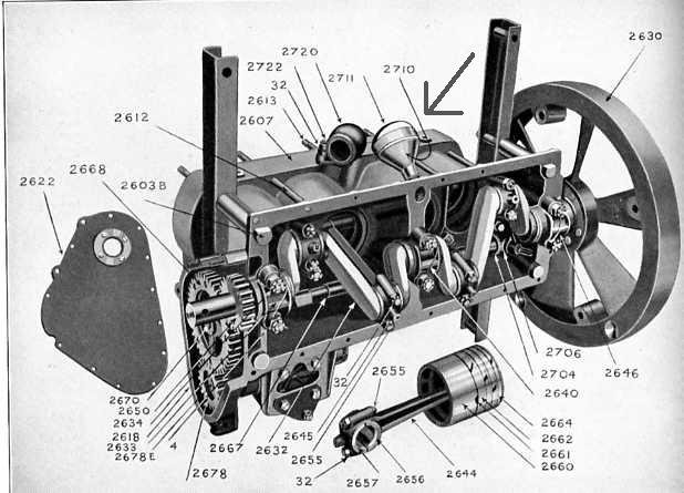

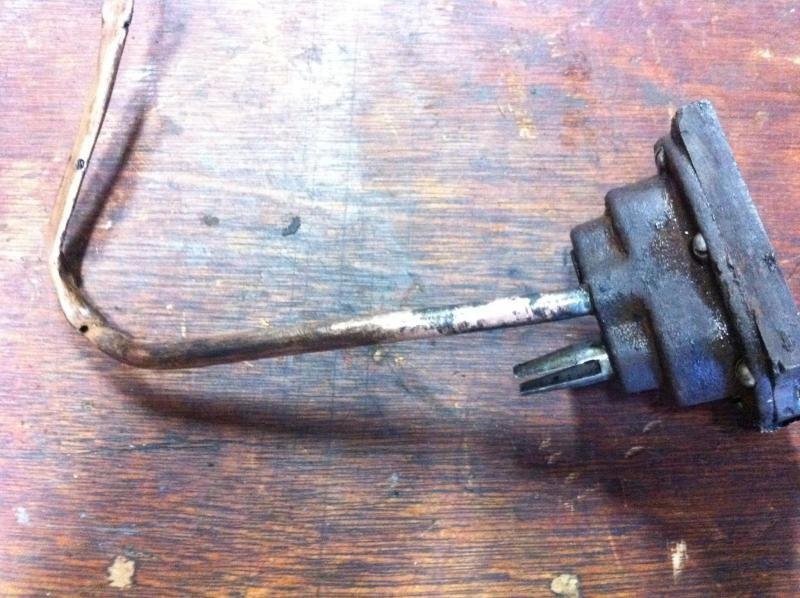

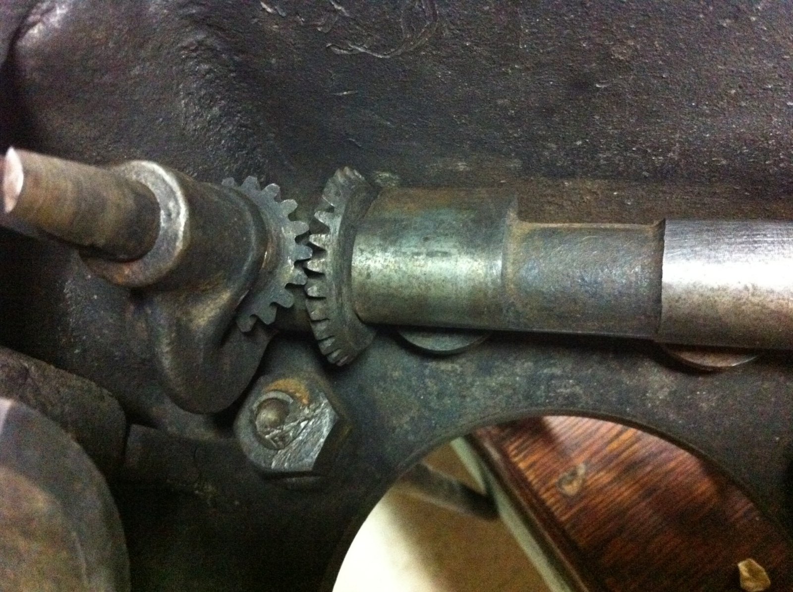

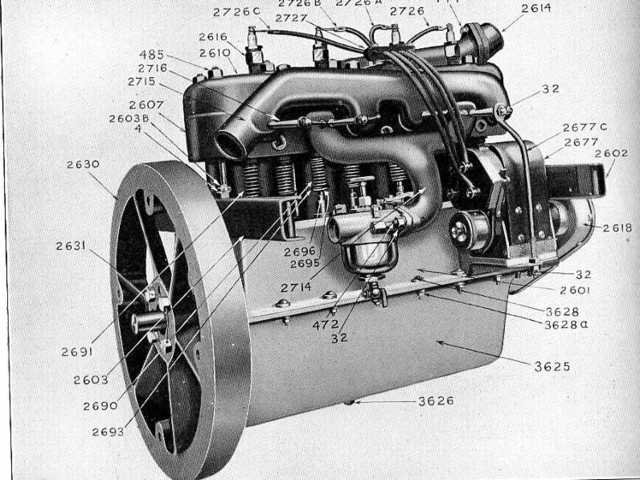

Metz related threads always capture my attention.
I am surprised that the engine in the original post still retains its sheet metal valve covers as they are often long gone by now.
While the Metz engine has a superficial resemblance to the Model T engine, there are significant differences between the two.
The Model T engine is cast en bloc and the Metz has its cylinder casting separate from the upper crankcase.
The head and cylinders are secured to the upper crankcase with studs and nuts.
There is a dipper tray for the connecting rods, much like the Model A.
The connecting rod caps have cast in dippers.
There is a camshaft driven oil pump to fill that dipper tray.
The Metz engine is cooled by thermosyphon, like the Model T, but it does not use a belt driven fan; the spokes of the rear mounted flywheel are shaped like fan blades to draw air through the flat tube radiator.
The Metz engine is rated at 22 horsepower, hence the model number.
There are probably as many "loose" Metz engines around as there Metz automobiles because when the car itself wore out, the engine was salvaged as it is a really good little power plant and easily adapted to other uses.
