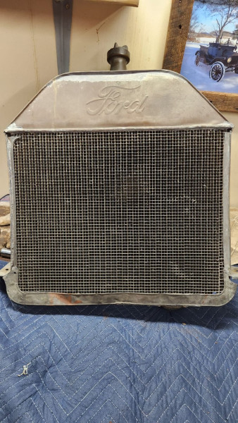

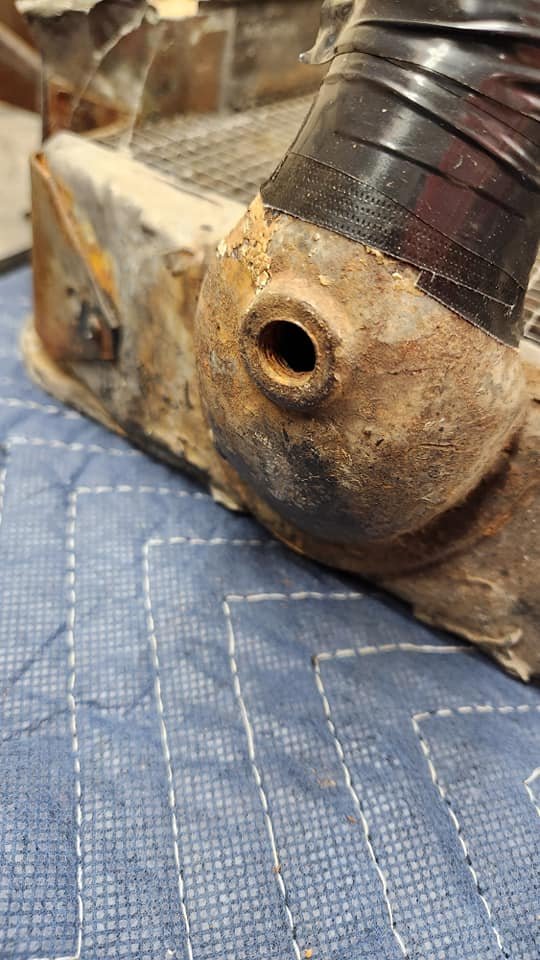

I picked up a decent 1911 Brass radiator just before Hershey. I would like to test it out, but do not know ow the correct thread count and 'bolt' size which would fit in the drain hole where the petcock would go. Is anyone aware of what the size of those petcock threads might be? Thank you in advance. ** Updated with photos **

It is not a bolt, it is pipe thread. Should be 1/8" NPT.

FYI. It is however close to a standard bolt thread, a 3/8 - 24 if I recall correctly. Sometimes, if the tapered pipe thread has been overtightened a bit much, the bolt thread can be started in the hole. Do not do that except in an emergency (like in the middle of nowhere and the petcock fell out back there somewhere), as forcing the bolt into the tapered pipe thread will quickly destroy it.
