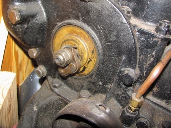

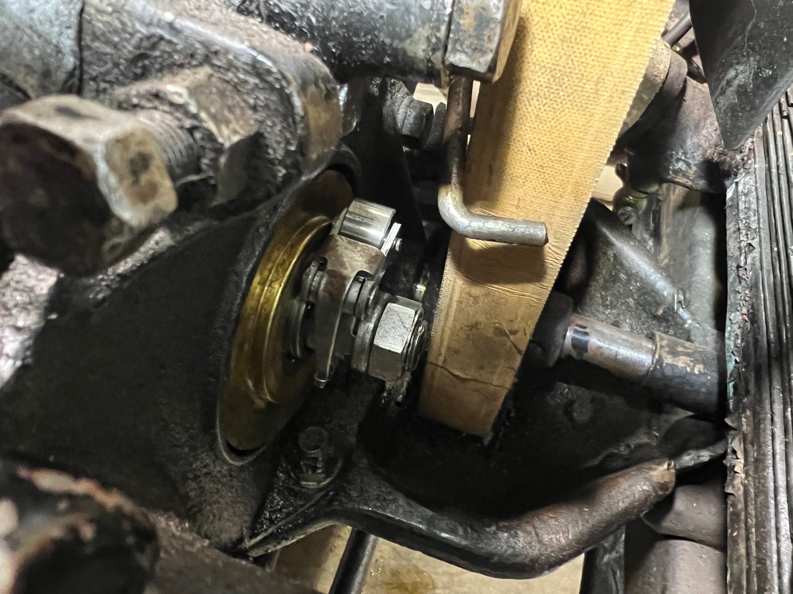

Here's a photo of it to maybe better help! Installed with the cam nut tight, there is no movement to the roller arm assembly at all. Roller moves freely.

Does your engine have a modern neoprene camshaft seal? I have a New Day and I know that when you use a modern seal you don't use the large brass washer / shield over the camshaft.

Remove the brass shield and then see if it frees up the roller. It’s too close from the photo.
If it’s rubbing the roller then remove it and install the modern press in seal.

Looks like the roller body pivot arm is hitting the cam gear nut edge @ the rear.
- Posts: 5582
Re: Timer Brush Installation
Just a "FYI" - that bolt directly below the timer should be reversed - bolt head on top w/nut at the bottom.
John's on the right track with the cam gear hub thickness - photo appears that the roller body is against the cam gear retaining nut !

I think so too. In comparison to the old roller brush, the arms are much largerspeedytinc wrote: ↑Fri Oct 20, 2023 6:38 pmLooks like the roller body pivot arm is hitting the cam gear nut edge @ the rear.

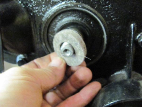

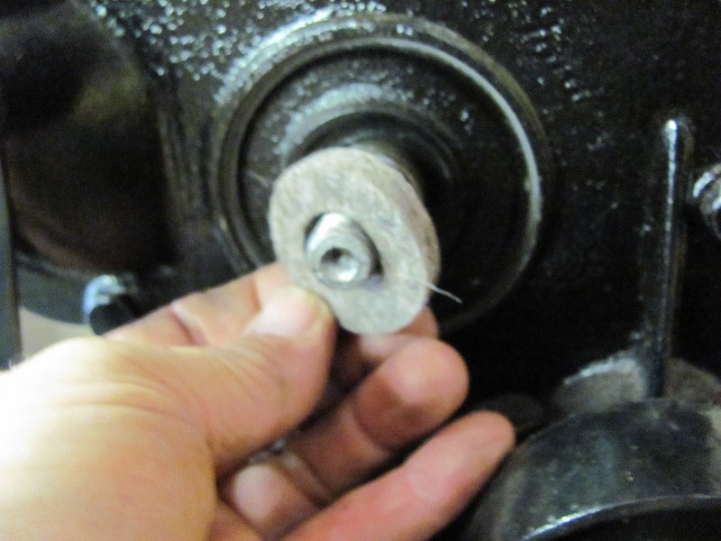

In the photo, the left side is hanging up on the metal ridge. I’ve filed it down to see if it’ll help, but it hasn’t. I’ve got an ANCO timer coming shortly that if and when this one becomes and issue I’ll replace it with that. I’ve just decided it’ll have to do for now lol
- Posts: 4082
Might try again to check the felt behind the brass shield. If the felt is new it will be too thick and push the shield out, so that keeps the rotor barrel from seating fully. Felt should be rubbed with grease to flatten it some for fit. And others have found reproduction shields aren't exactly to shape with the inner cup for the felt a bit too tall.

Consider installing a modern press-in camshaft seal. After removing the felt, clean with solvent before installation. Some guys use a small amount of Ultra black to secure it. As mentioned before, you can then discard the brass shield.

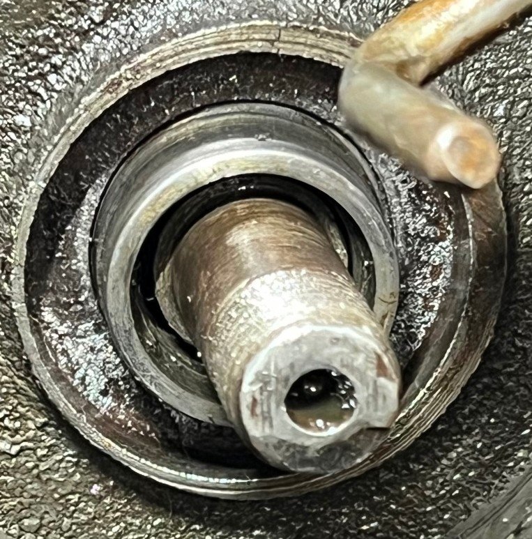

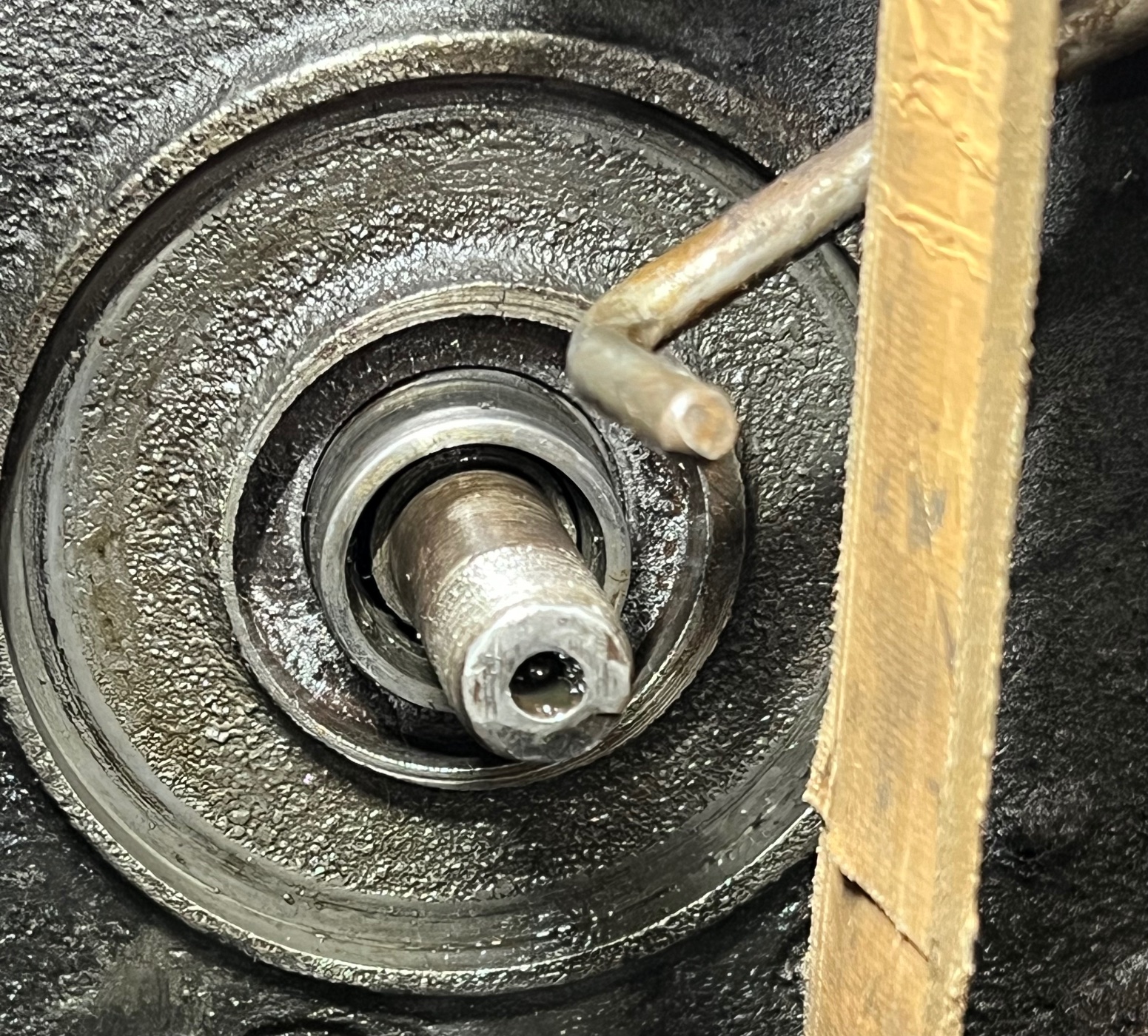

John, I took the radiator off to get a better view of what I was doing. Well, look at the attached photo. There's my issue. Suggestions?John kuehn wrote: ↑Fri Oct 20, 2023 4:01 pmDo you mean the round roller between the two arms isn’t turning?
I think you mean when you installed the roller assembly on the camshaft and inserted the pin that holds it in place you noticed the roller wouldn’t turn easily.
The term brush term is used when you have a New Day timer. It has a brush that presses against the timer case face contacts and is stationary.
Original style roller timers like the one you bought from Snyder’s has the roller which make the contact around the inside of the case. It rolls around.

If I’m looking at your latest photo it sure looks like the timing gear cover is off center?
If that’s the issue of your binding roller timer I wonder how your car ran to begin with.
The cam is probably in the correct position in the block itself but the timing gear cover is visibly way off on one side. In other words the timer itself is “off center” but the roller assembly is correct.
I would get another timing gear cover. They are fairly plentiful and inexpensive. Call Lang’s T parts and they probably have a good one. They keep lots of good used T parts. I can’t recall a cover being that far off before. The cam hole is probably correct but the area where the timer sits is way off to one side.

Thank you, John. The metal sleeve around the cam shaft…is that another part that I’d need? I worry that because it’s so far off that it has ruined something behind the coverJohn kuehn wrote: ↑Sat Oct 21, 2023 3:51 pmIf I’m looking at your latest photo it sure looks like the timing gear cover is off center?

I should also note that the metal sleeve around the cam shaft is also off center itself. The gap around the cam shaft is smaller on the right upper side.John kuehn wrote: ↑Sat Oct 21, 2023 3:51 pmIf I’m looking at your latest photo it sure looks like the timing gear cover is off center?

Is the timing gear nut snug, or loose? It would shorten the distance when loose needed for commutator flapper or roller to fit properly on camshaft.

I have not taken the cover off yet but I am sure it is loose, by the appearance of it. I'm trying to get as much direction as possible before I tear into it completely. I have zero beforehand knowledge on any of this. I'm going in blind!

Looking at the end of the camshaft the number of threads showing is a lot less than in the other picture from another poster. This would show a possibility of that cam gear nut being loose and the flange on that nut is probably grinding on the inside of that timing cover with the two camshaft dowel pins retaining position of the gear. After removing the cam cover and retightening that cam gear bolt, you'll need a centering gauge and gaskets along with that neoprene seal . Removing the radiator will give you a lot more room to replace what's needed .

Where can I get a centering gauge? And by gaskets do you mean gaskets for the timing cover? Just asking for clarification and making sure I have everything gathered up!Moxie26 wrote: ↑Sat Oct 21, 2023 5:02 pmLooking at the end of the camshaft the number of threads showing is a lot less than in the other picture from another poster. This would show a possibility of that cam gear nut being loose and the flange on that nut is probably grinding on the inside of that timing cover with the two camshaft dowel pins retaining position of the gear. After removing the cam cover and retightening that cam gear bolt, you'll need a centering gauge and gaskets along with that neoprene seal . Removing the radiator will give you a lot more room to replace what's needed .
- Posts: 4671
Go to Lang’s Model T Ford website.
They have the timing cover centering tool and necessary gaskets if you need to remove the cover or loosen the cover bolts and see if it will center up.
You can tell by looking at the cover that when it was made the lips where the timer case sits in aren’t the same width all the way around.
Most if not all the cover pictures you can see on the net or the covers that I have aren’t that far off. The ridges or lips that I call them are the same width all the way around. But that’s my opinion and others may disagree.
Try the centering tool first and you’ll know pretty quick if it doesn’t easily go on. Or if it goes on at all.

The question remains.
What kind of timing gear?
It may be the type with too thick a hub, not allowing the cam gear nut to seat deep enough.

Taking into account that you have ordered from Snyder's antique auto parts, they do have the camshaft centering gauge, and They do have the gaskets. ..... and the only thing extra would be a little adhesive over the counter at your local auto parts supply store. You can discuss with Snyder's representative what you're doing and quite possibly they could help you with the installation procedure.

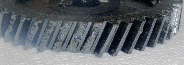

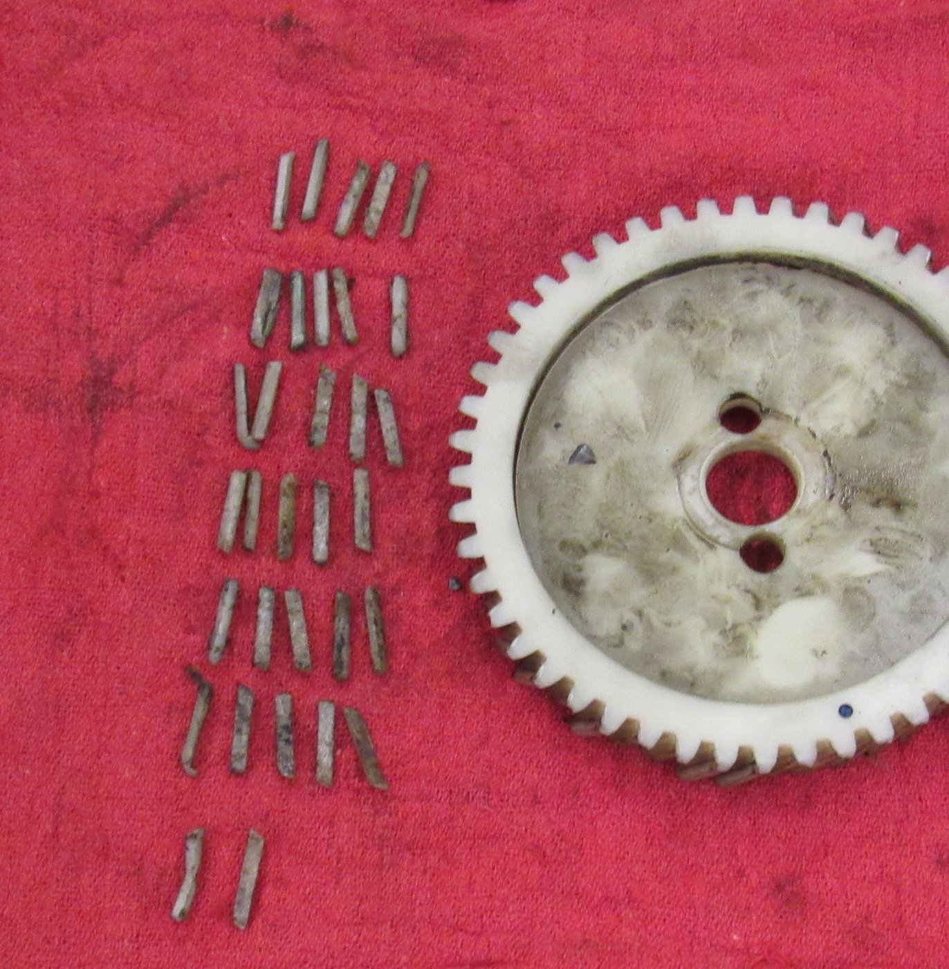

Here's the update on the interesting situation at hand...I removed the camshaft cover. The camshaft lock nut was somehow cross threaded, which caused damage to the cover and two of the threads of the camshaft itself. I'm hoping to thread those, with assistance, of course, to be able to get a new camshaft nut to seat properly. I also discovered that the camshaft gear has been replaced with a composite one. It also appears to be damaged. My plan is to replace that as well. Should I replace it with a metal gear or another composite gear? I'm sure there are a million opinions on that as well but, I eat up suggestions!
Again, thank you all for your help. This community rocks!
I'll look more into the local chapter, the problem I have is that I live in the middle of nowhere. It's nice because it's my great grandparents farm but everything handy is forever and a day away.
Bill Robinson
- Posts: 316
- First Name: Bill
- Last Name: Robinson
- * REQUIRED* Type and Year of Model Ts owned: '21 Depot Hack, '25 Touring Car, '26 Roadster Pickup, '27 Tudor, & another '27 Tudor
- Location: Salty Bottom, ALABAMA AL
This is what happens to both composite gears and nylon gears. If you plan on driving your Model T, then my advice- go with bronze or aluminum. I prefer bronze- some members here say the aluminum ones "ring", but I've never run aluminum, so I can't say.

Just to give everyone and update on this situation so that others may find this if needed in the future..
Could not get the Roller brush to seat properly on the camshaft. After digging, discovered that the camshaft lock nut had somehow backed off from the camshaft timing gear and became cross threaded. It wore a grove into the timing gear cover and the camshaft timing gear itself.
Solution was to fix threads (thankfully able to file them back to a useful state, replaced camshaft timing gear with a bronze Dan Mceachern gear, replace camshaft lock nut, replace timing cover and reassembled the car. Runs like new.
Special thanks to all who offered guidance and assistance through this odd situation that I experienced! You're all invaluable!

The "metal sleeve" is part of the camshaft nut. It is what the modern seal runs on. If it is damaged/ pitted, the old felt seal may be the better option.
The cover does look to be installed off-centre. Do not be concerned about the machining in the cover being offset to the casting. This is common. The answer may be in removing the cover and re-installing it with a centering tool to set it up correctly. With the cover off, you could install a new cam nut with a smooth seal surface.
Hope this helps.
Hope this helps.
