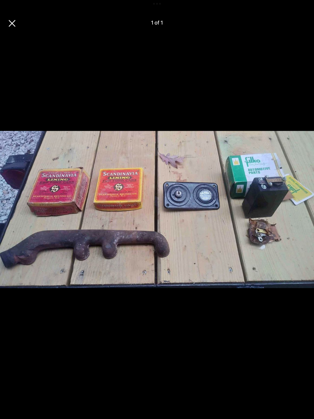

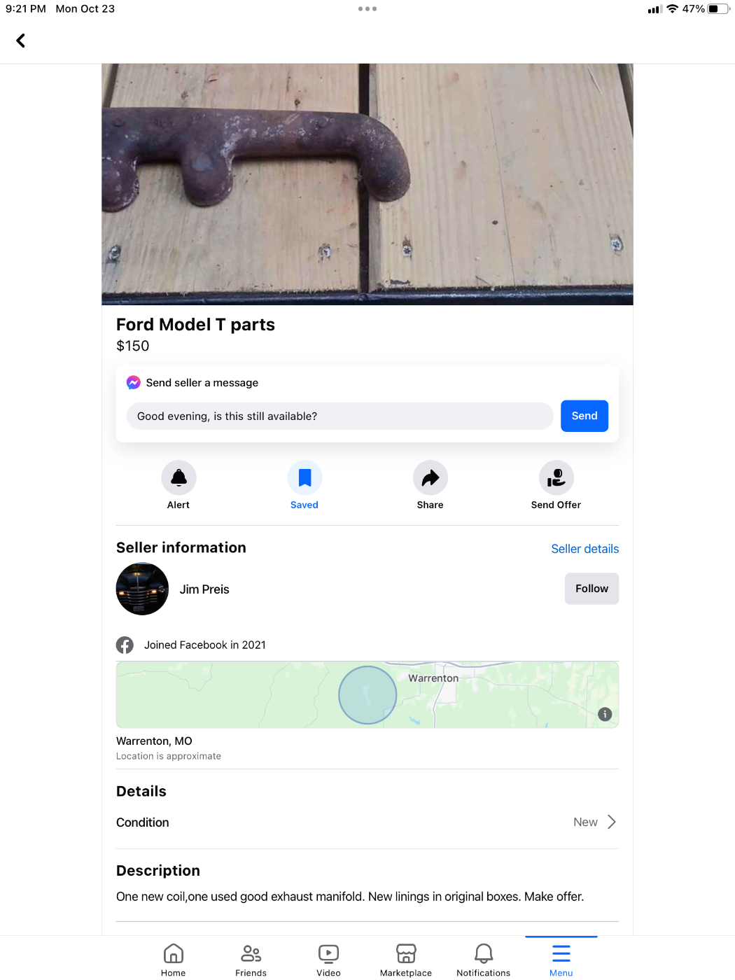

Post by Unprr » Mon Oct 23, 2023 10:24 pm
I have no connection to this seller. They have two sets plus other parts for $150 obo

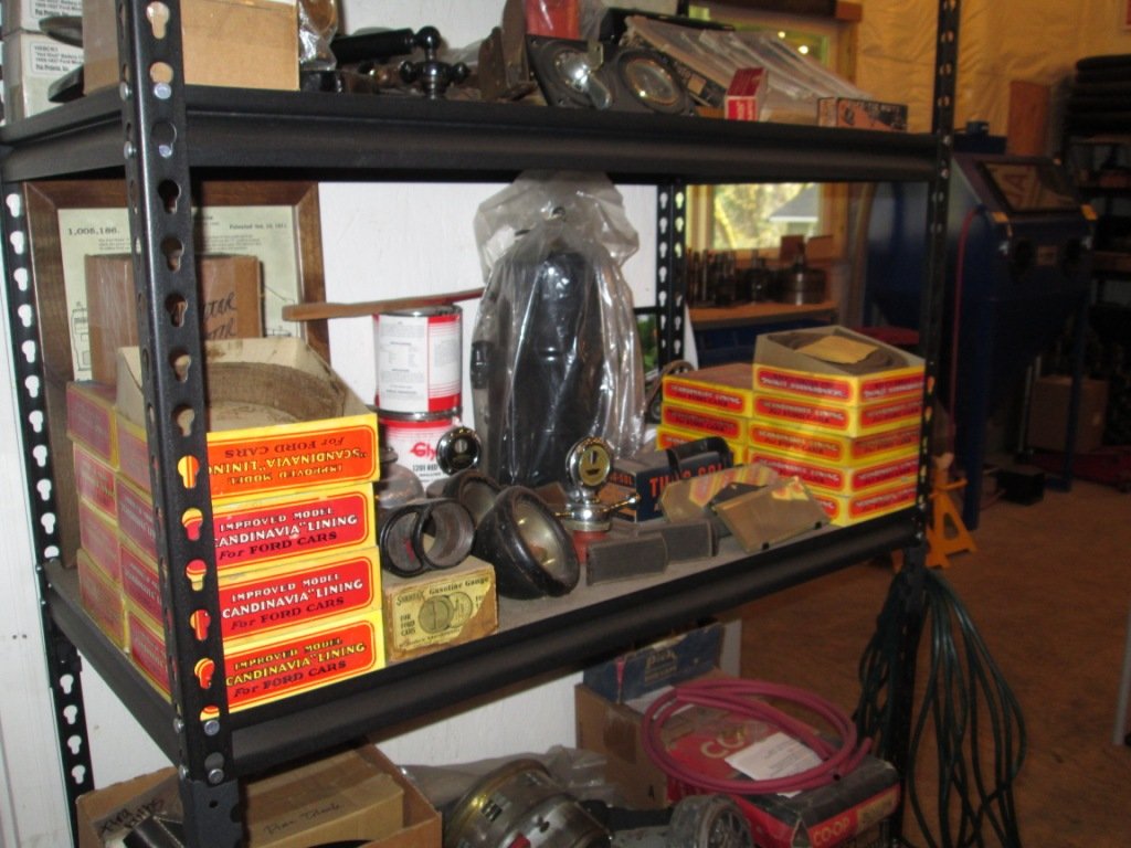

Tim - I respectfully disagree regarding your "deteriorate" comment - perhaps a set of original Scandinavia lining that had been stored improperly could become mildew attacked but properly stored, they will last quite a long time - they were factory treated. I don't believe heat breaks down Scandinavia lining - normal driving does. I've run Scandinavia linings for many years in all but one of our T's - Grampa's TT runs wooden lining. I don't recommend Kevlar linings to anyone novice or not I.M.H.O. - I've rebuilt too many transmissions running Kevlar that had broken drums.
When Cantex took over the "Scandinavia" lining product, I believe back in the 70's, they still produced a good product - same weave pattern, just not "treated" as original were - still brown colored. Sometime later, the length was shortened up by approx. 1" (more lengths per roll ?) for a time then the weave changed and they were then treated with an asphalt type substance which we in the hobby referred to as "tar babies" back then - those I cannot recommend.
My apologies for commenting in the Classifieds !

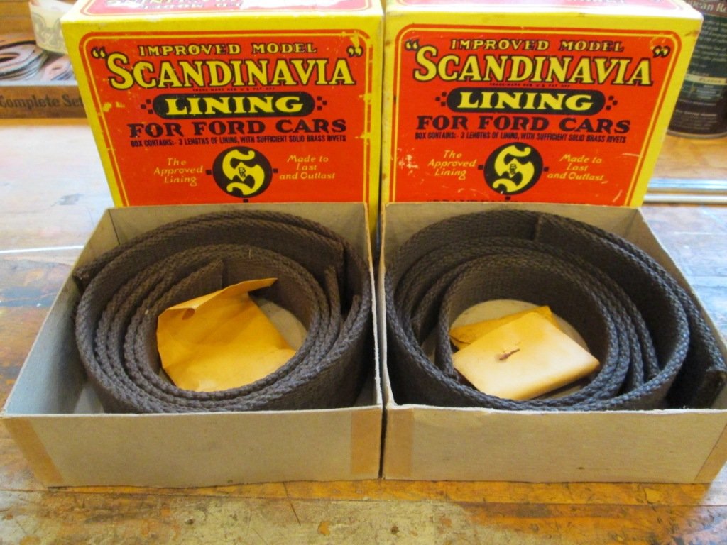

Addendum: I would be happy to send you a couple wide brake linings - original Scandis ! Drop me a note through the Forum.
My apologies - I misread the header - let me look & if John can't supply, I most likely can.

Thank you for sending this over! I decided to go with this seller because they are local. Very much appreciated!

Hailey - the correct length for any band lining is 23 & 1/2" !!! Have the seller measure them and don't purchase the "black" colored ones !
