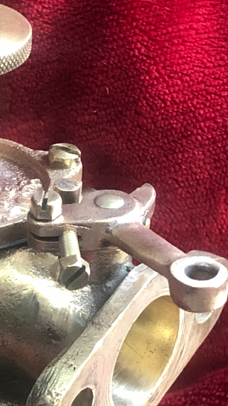

Re: Holley G Changeover Question
I was looking through some pictures and I found this. I got this one this way, I’d say it’s an early 1915 based on that it still retains the Pat’s Pending mixing chamber cover but has the first version of the T shaped spray needle which has the brass crossbar threaded on and pinned. It also uses steel round head slotted screws for the idle adjustment and locking screw instead of the earlier brass hex head/slotted combination screws. It has a steel bowl. Now all those parts could have been changed in 100 years but probably the bowl if anything was the only part replaced since the brass ones crack but I would say this was an original from the transition period.
