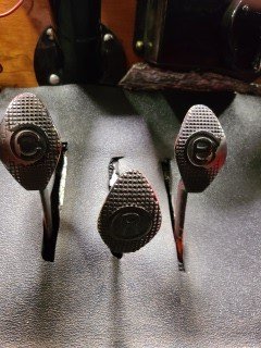

Looking to put RM brakes on our family's 1913 T. My dad put a later model engine in it for a starter and generator. the block has no serial number. any idea by looking at the pedals what year the engine/transmission is? i want to order the correct RM pedal. Thanks in advance.

According the the Model T encyclopedia that on this website the lettered pedal were discontinued in late 1914. The encyclopedia has a history of the transmission covers from 09-27 and has more information you might want to check out. Hope this helps. It’s not surprising to find different year parts on Model T’s since lots of parts would interchange. Not all but some parts would.
As far as the engine is concerned if your engine has a starter and generator it could be as early as a 1919 engine which had 2 valve chambers ( 2 valve covers). In early 1920 the engines went to the one valve chamber (1 valve cover).
Without seeing a picture of you engine that’s the way you can tell what you have.
Others will comment too.

Early lettered low pedals won't work with electric start so your Dad might have welded repro lettered pedal heads on at least the "C" pedal. The early pedal's slo-speed connection arm is straight whereas the electric start pedal has a right "crook" in it to clear the Bendix can.

The low pedal arm for which you speak, can be bent a bit to clear the bendix cover.

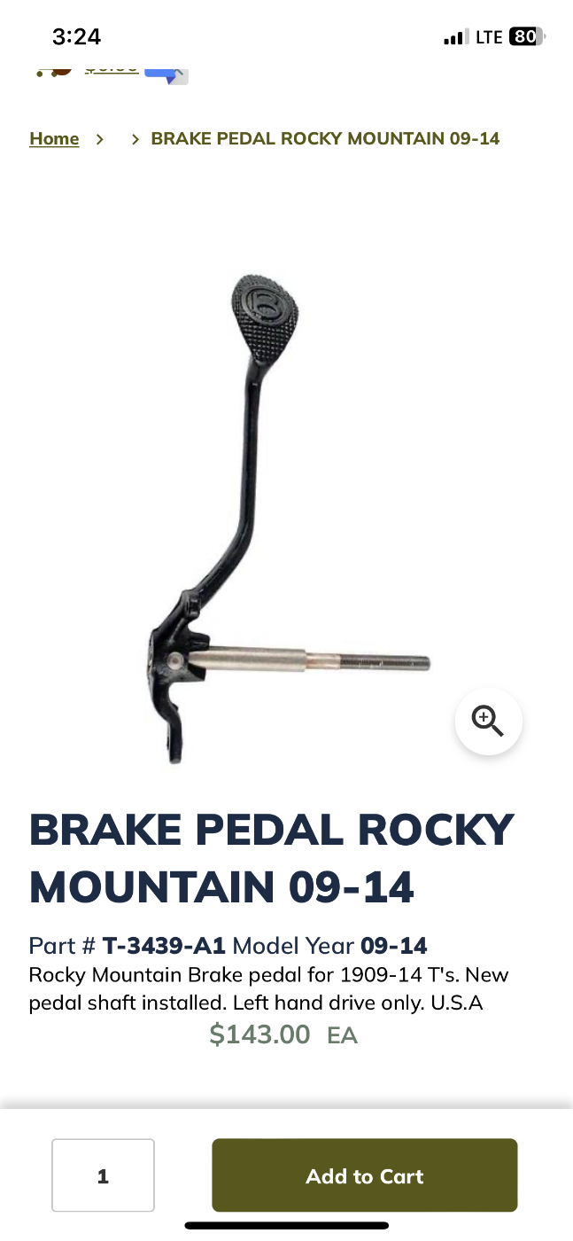

I believe there is a letted brake pedal available that will work with outside brakes.

Snyders offers all types, the early diamond pedal with the “B” or you can get similar with ribbed or Rocky Mtn cast on the pedal face. All brake pedals interchange ‘09-‘25 so will work with later hogshead with starter.

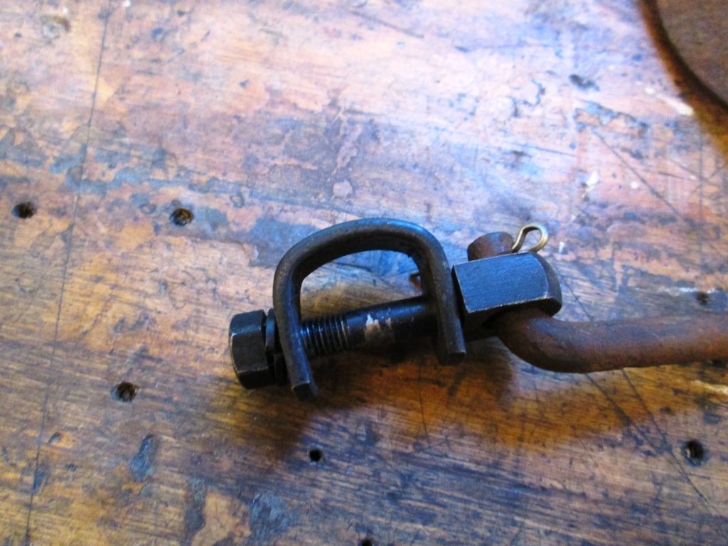

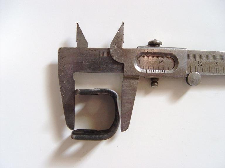

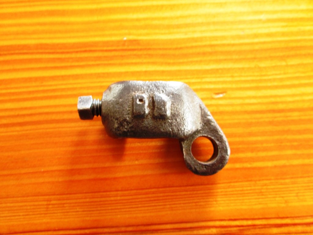

I've not seen an original Rocky Mountain brake pedal. To my knowledge they made a clamp to go around the original brake pedal.

Agreed Larry - I believe I do have a complete original R.M clamp somewhere here ! I have a Bennett & a Pikes Peak original brake pedals also.

I believe this to be an original pedal clamp for R.M. brakes - I have another one that is cast steel.
