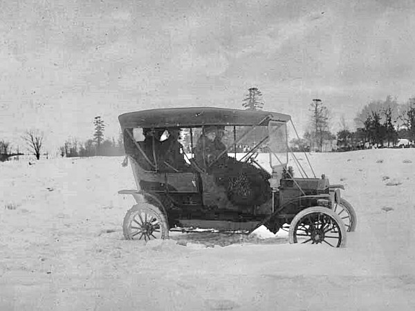

Hi all,
In looking at period photos of T's, so many have a dull paint finish. Few are really shiny. Is this something with the paint chemistry? Or just dust and dirt? Or lack of car wax? Or time to use the wax?
Just curious.

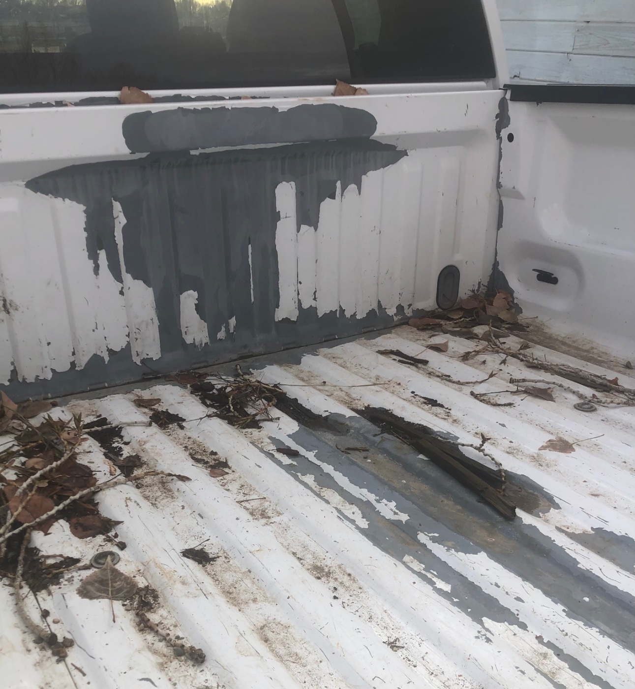

"Better paint". Much depends upon the purpose and the application. Here's the better paint on the bed of my 2011 F-150.
"Paint" is an elusive subject. For some reason, those of us who have reasonable success with coatings that we have no knowledge of the materials and processes involved in their manufacture feel qualified to hold forth on the composition and nature of "paint" - not only currently, but well into the past.

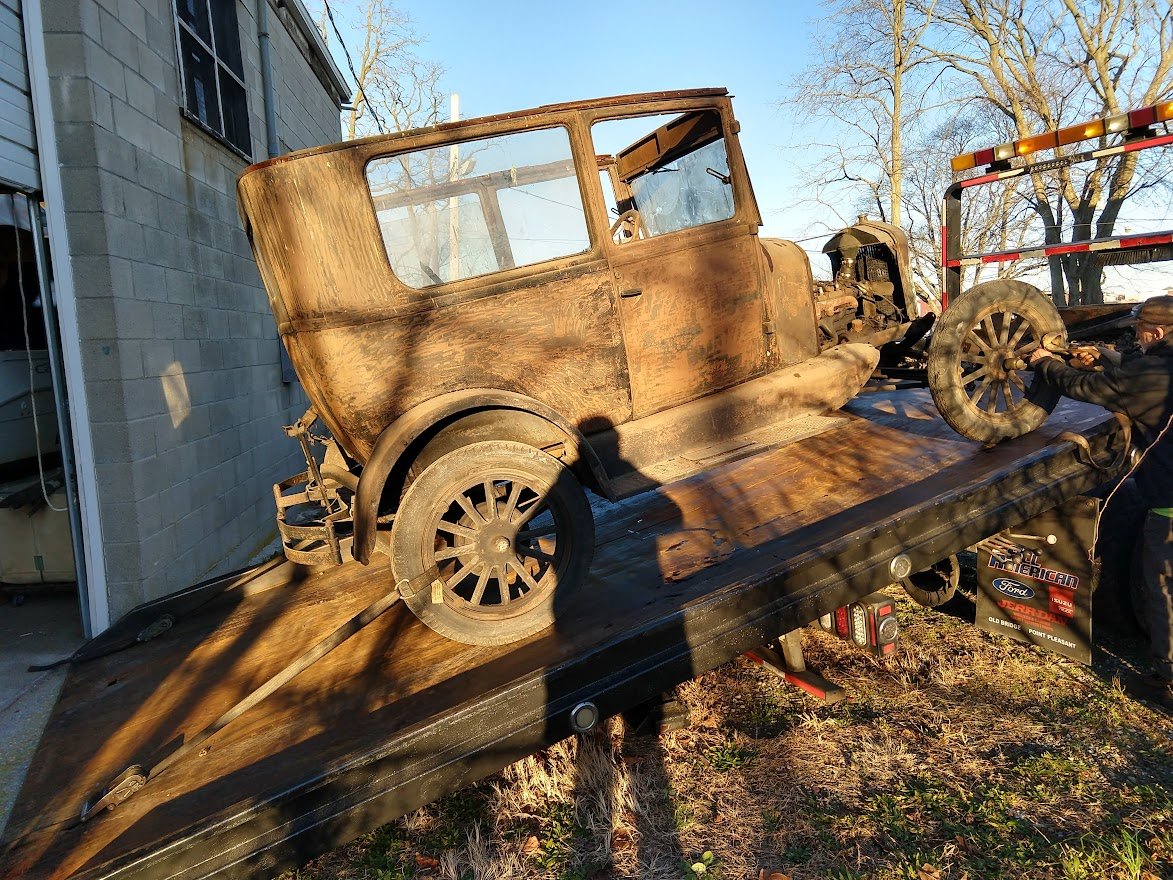

Here is a photo of my 27 Tudor the day I pulled it out of a warehouse.
Note the streaking of the original paint and rust lines. Seeing this at first I wondered how someone would have painted the car. This forum has images of how it was done: using sprayers that wiped/sloshed/smeared the paint on.
I guess the original paint didn't take long to lose the glossy finish due to poor quality chemistry. Tar doesn't stay shiny for long.

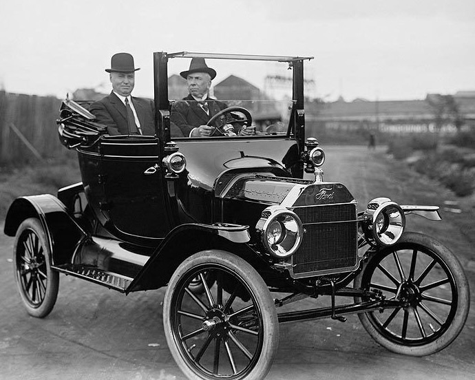

Here’s a shiny one from Tom Rootleb’s (Dollisdad) photos. Note the reflection of the rear fender on the side. Probably brand new. It didn’t take long for the gloss to disappear when parked out in the harsh elements, but they did look good for a short time. Jim Patrick

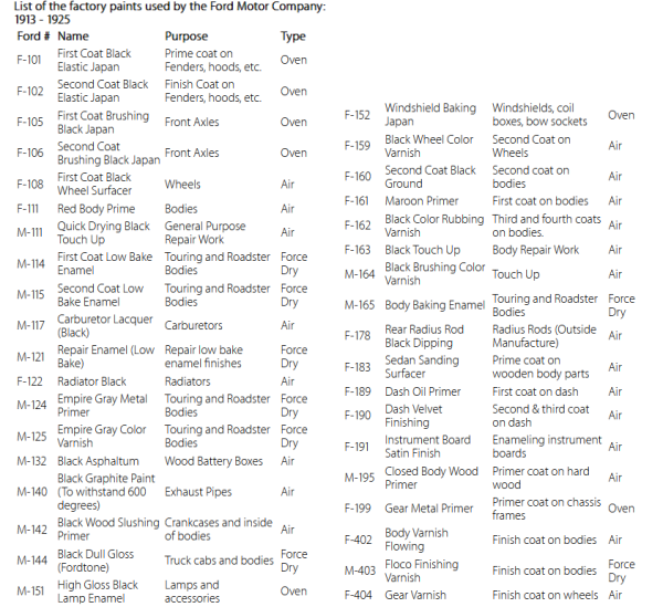

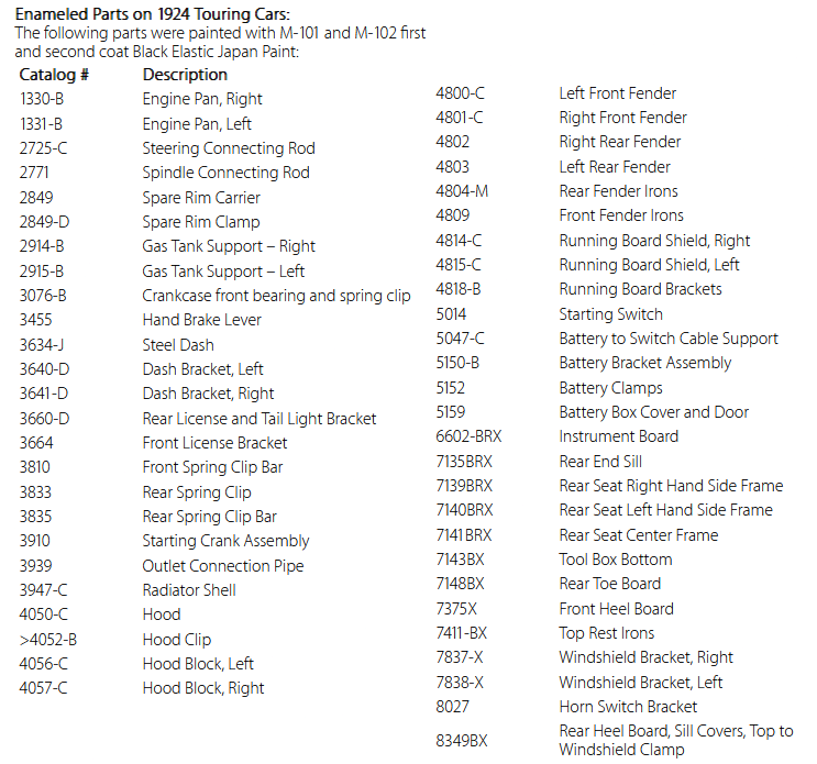

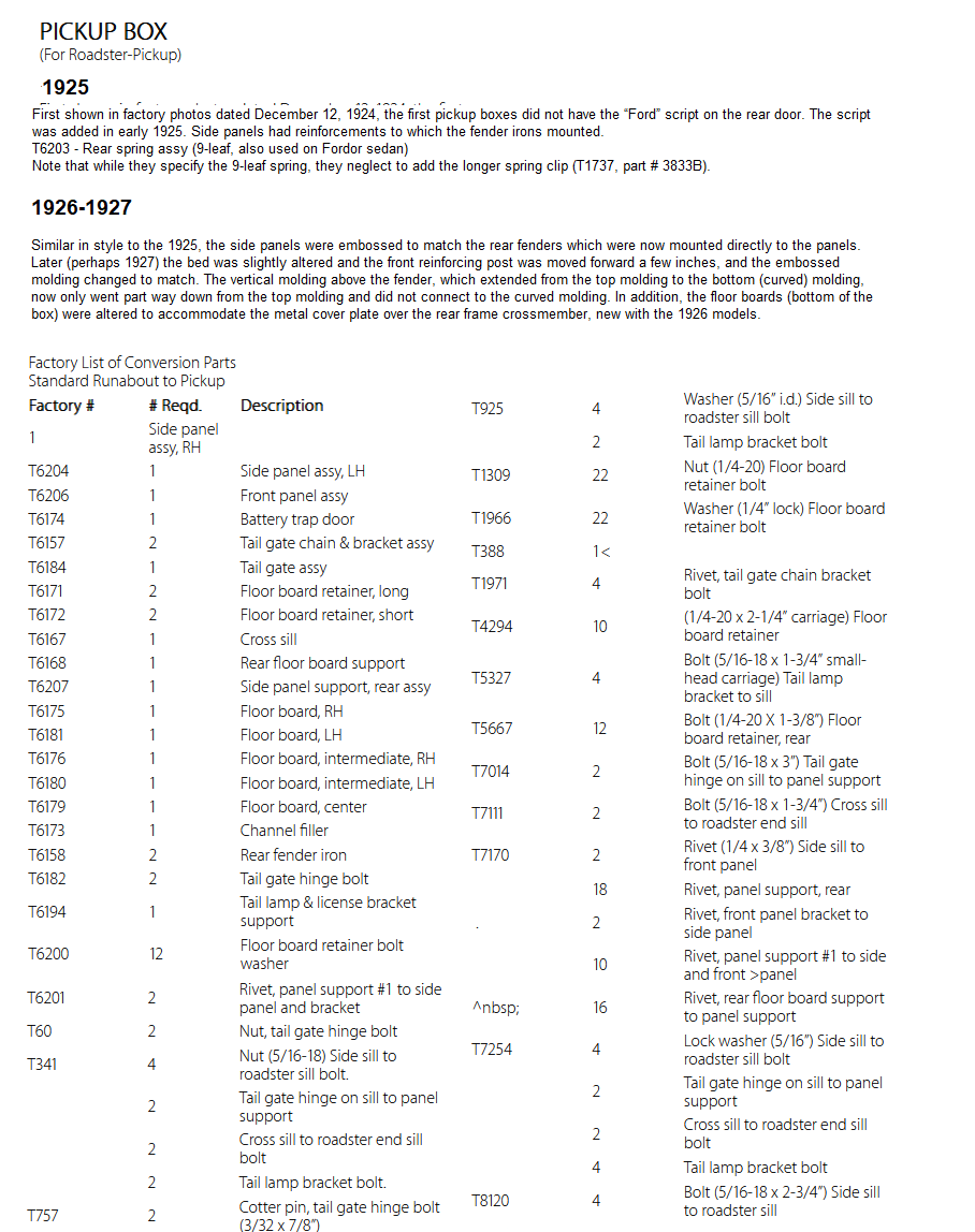

A most interesting , very detailed, investigation to Model T paint & what was used where. https://www.fordmodelt.net/m/p-r.htm
CONCLUSIONS (of facts presented from the study)
There are four main conclusions to be drawn from this investigation. First, the paints used on Model T's during the black era years of 1914 to 1925 were really color varnishes. These types of paint bear little resemblance to the modern automotive finishes used today when restoring a Model T.
Second, over 30 different types of black paint were used at the same time to paint Model T's. The different types of paint vary according to the means of drying them (air versus oven drying) and were also formulated to satisfy the different means of applying the paint to the different parts.
Third, Model T's during the black era were painted using the techniques of brushing, dipping or flowing the paint on. Paint spraying equipment for finishes did not come into widespread used in the Ford factories until 1926.
Fourth, the color black was chosen because it was cheap and it was durable. Black paints, especially those containing asphaltum, were noted for exhibiting better damp proofing properties than other colors during this period. The claim that black was chosen because it dried faster than any other color is not supported by the Ford engineering documents, the contemporary literature, nor by the first hand accounts of Ford Motor Company employees.
What was painted with what black paint
