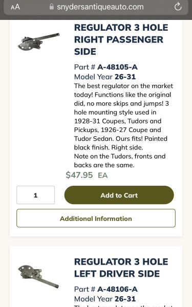

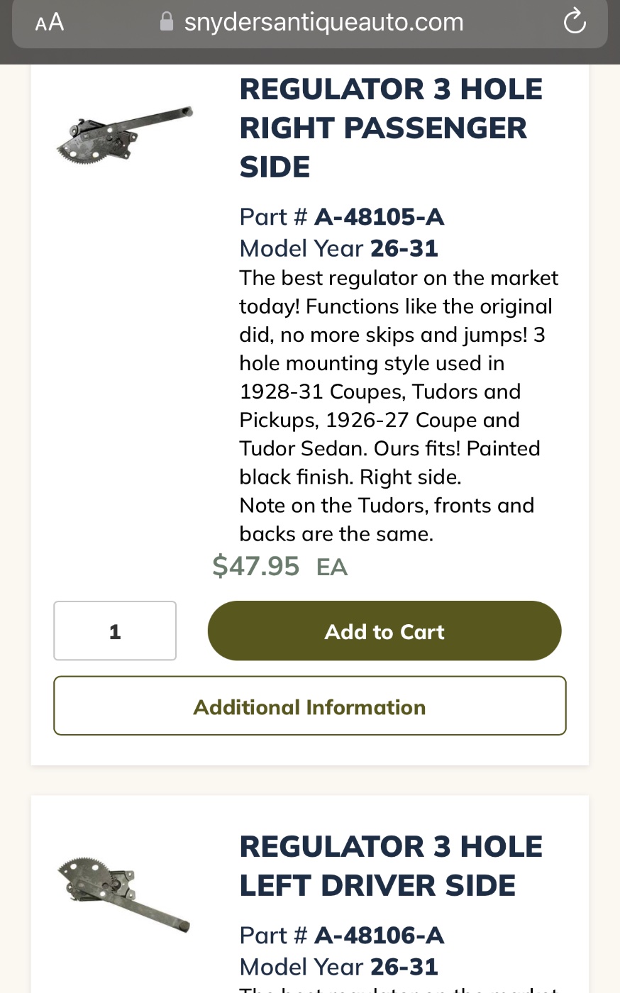

They have the replacement risers, but I was hoping to use their repair kit which is a lot less.

As you’ve found out, the repair kit can be disappointing. If you had to file your gear and the spring isn’t doing its job, then it isn’t worth the low price.
I’ve installed several of these from Snyders and they are excellent quality. Replace your window glass with safety glass at the same time if you don’t already have it.
