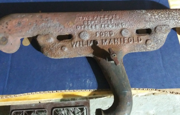

I have this Wilmo Manifold. Anyone have any info on these?
Plan on using my NH carb and a HC Head and was wondering about the performance of these if anyone knows the info.
Wilmo Manifold

My unrestored '17 roadster has a Wilmo - it was installed by the original owner.

One of my dad’s cars came to him with a Wilmo one-piece manifold on it. It makes installing the manifolds very easy and the car has always run great with the one-piece manifold. With that said, I believe both the intake and exhaust ports on the Wilmo manifold are noticeably smaller than the factory Ford manifolds.
