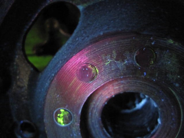

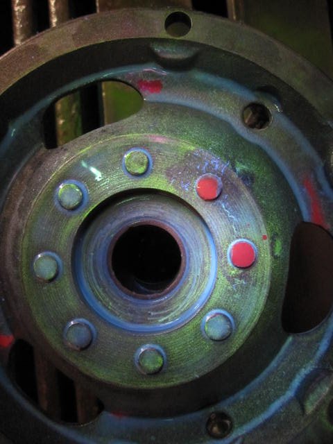

Check the drive plates carefully as we have seen alot through the years that the iron of the plate is crumbling around rivets and forms a crack between them. May not be the rivets that failed it could be the plate itself.
I was not able to see your images but wanted to point this out as well.
As with anything this old, i would strongly suggest getting it crack inspected as i have shown in the pictures.
