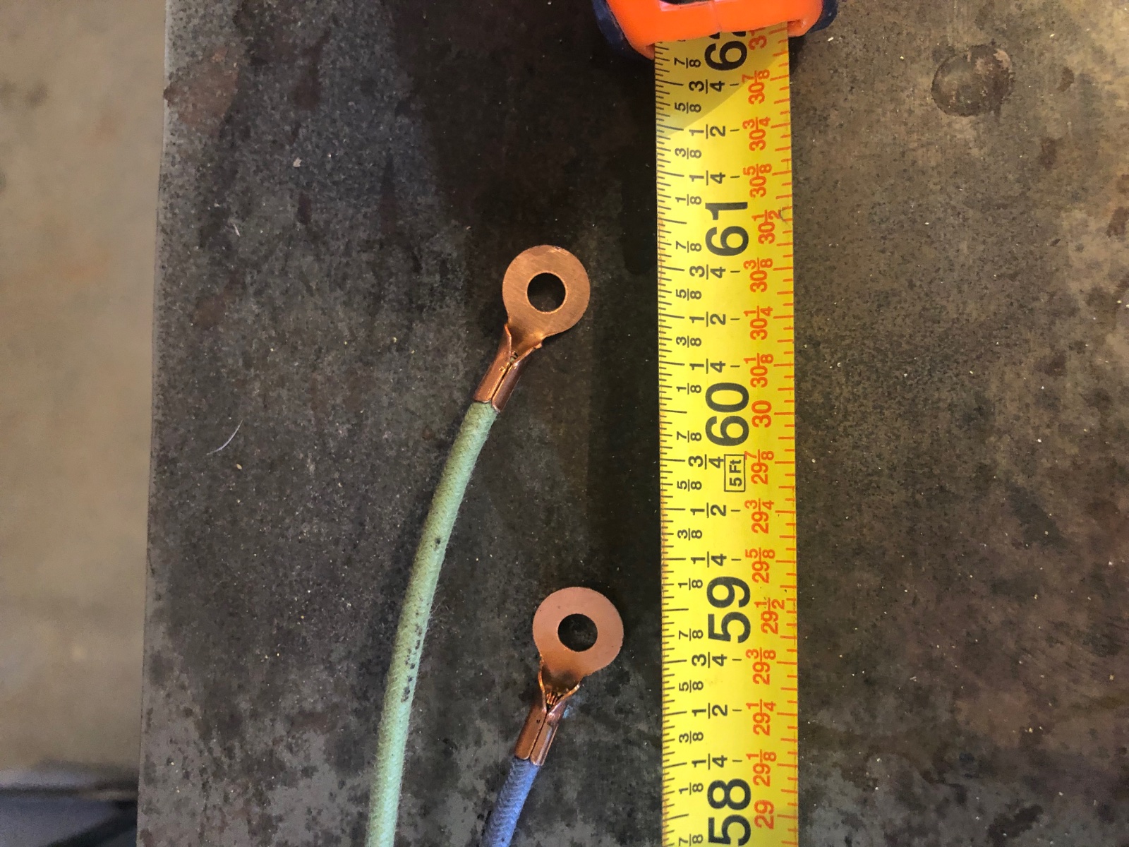

Both the new loom and the old one measure the same - approximately 61" for the longest (green) wire in the set. Kim, can you measure your new one to compare ? Thank you !

My Green wire end to end is 57.5".

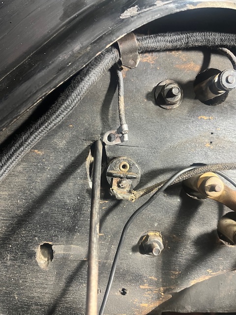

I realize your coupelet has its original firewall so the clamp is in its original location.
On the 1917 Rip Van Winkel Ford, that clamp sits lower on the firewall. I believe on my unrestored '17, it is also lower but I'd have to go out the garage and look.
Also note that the headlamp wire is stapled to the firewal (two staples)l. Note the evidence of that on your '16 firewall. The firewall on my unrestored '17 also has the holes from the two headlamp wire staples.

I didn't stretch it out tight, why I said approximately. I believe I'd gain a bit if it were pulled to an accurate measure; any road, your loom is over 3-1/2" shorter. Would that be enough slack to install correctly ?

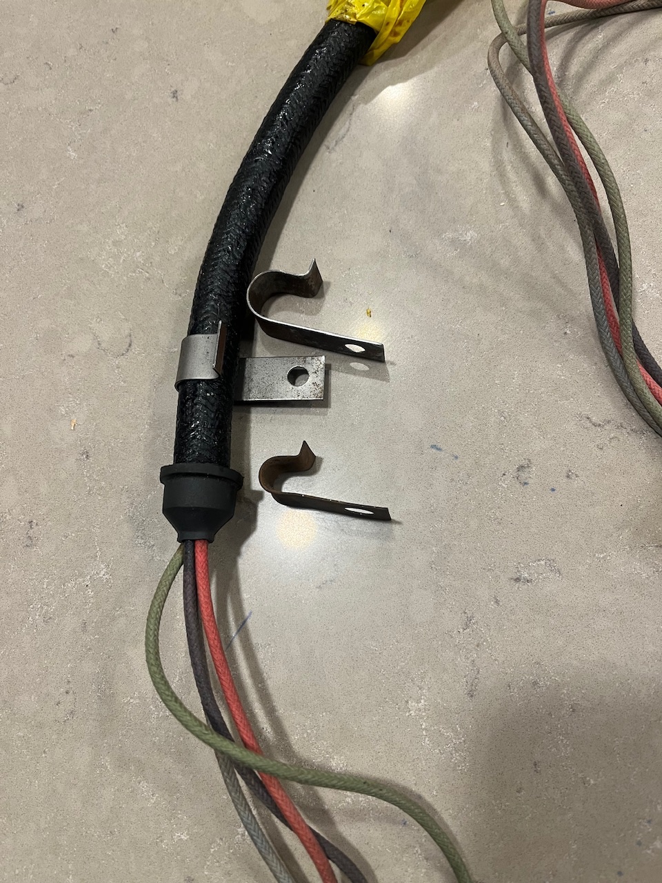

While we're at it, I see the clip I have is not correct, unless it was a different item in 1913. Does anyone have photos of the hood shelf loom retainers ?

Rich, here’s a picture of the loom retainers used 1909-14. The smaller one started in 1915.
