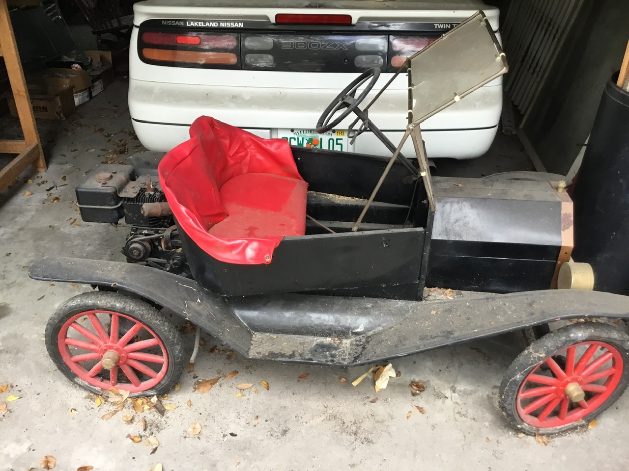

Just picked up an old Shriners Model T car. It doesn't have an engine. I know nothing about them other than what they are. I'm looking for any information on them. I'd like to get it back up and running if possible. Any photos, what engine it took and so on. Thank you.

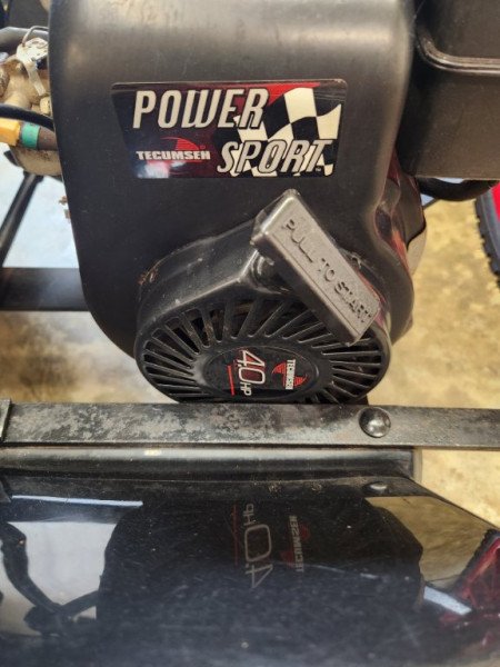

The motors are commonly replaced with Harbor Freight Predator Motors.

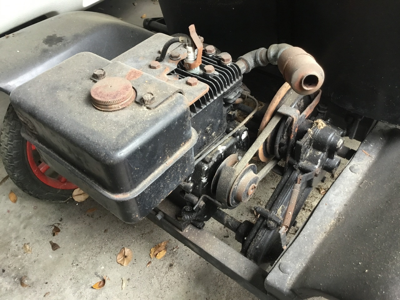

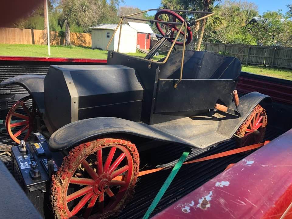

Here are a few pictures of my Model T Go cart. While our family was driving through Bainbridge, Georgia on vacation in the early 1964, my Dad happened to see it at a filling station as he was driving over an over pass. He took the off ramp for a better look and wound up buying it for $50.00. We drove home, 316 miles to Brandon, Florida with it tied down to the roof of our 1957 Ford Fairlane. At 12 years of age, I got it running and restored it to the best of my minimal experience and it provided me and the neighborhood kids with many years of fun. The last time I drove it was in 1970 when I bought my 1926 Model T coupe and began spending all my time and money restoring that. I turned 70 in November and plan to, one day, restore the go cart to mint condition if I am able to live that long. I hope the pictures help. The Briggs and Stratton engine and running gear are original and can be easily restored to running condition. Jim Patrick

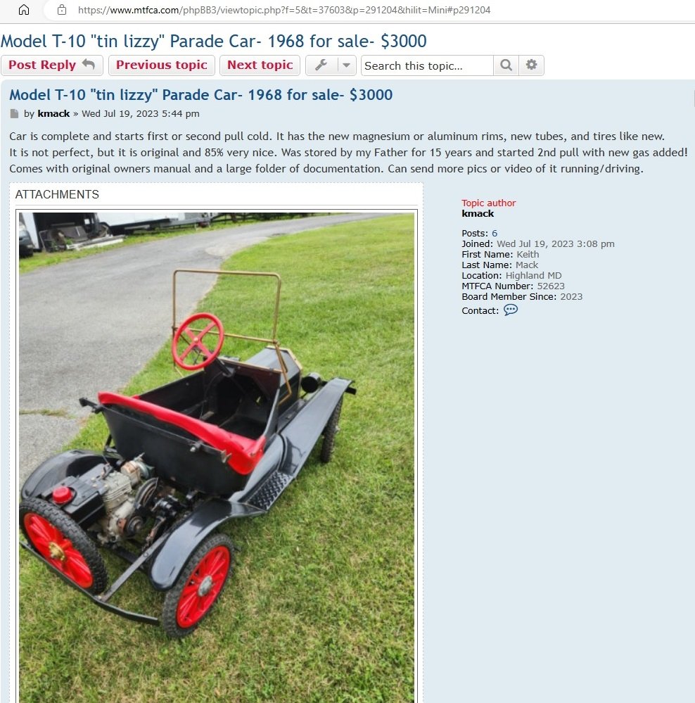

I don't recall the company name, but I still have their catalog.
Rumor had it the 16 inch plastic wheels exploding caused the company to shut down.
The small volume of air required to fill the tire tube and too much air pressure caused a disaster.
They did come out with aluminum wheels later on.

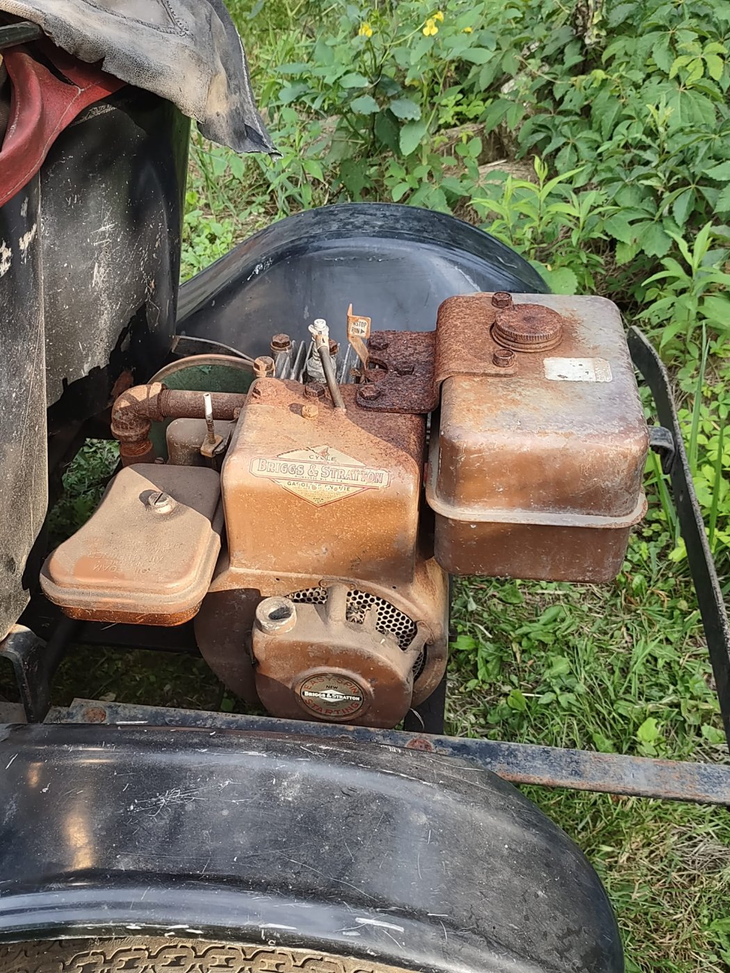

A friend recently still had this one for sale.
Mini T Engine.jpg (56.68 KiB) Viewed 2987 times

You just purchased a 1959~1965 McDonough Tin Lizzy. If you look on the back frame of your car (left side) and you will see an aluminum nametag with stamped 6-digit code. That code will help tell you the exact year it was manufactured.
The original engine that came on early cars like yours was a horizontal shaft, 3hp, Briggs & Stratton "81302". Also, there is a active Facebook group with people that collect and restore these half-scale Model T's. That group can help you find any missing parts needed. On Facebook search for a group called "McDonough Power Equipment Tin Lizzy and Buckboards". These little cars are a great way to get kids interested in full size Model T's.

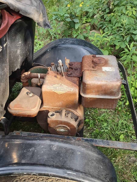

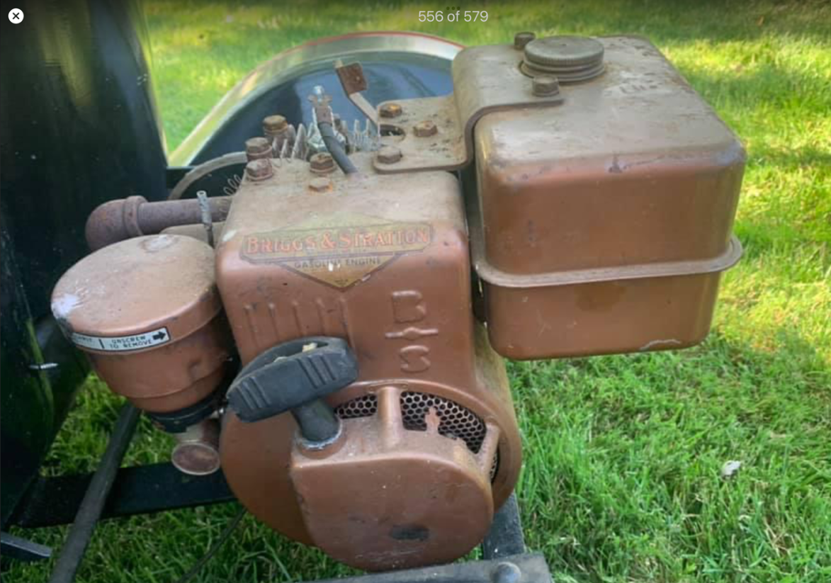

Will, as requested here's a photo of the what the original engine on your car would have looked like (3hp Briggs 81302). Notice, Tin Lizzie's built before 1963 used round Oil Bath Filters. Tin Lizzie's built after 1963 with 3hp Briggs engines used kidney shaped foam air filters.
