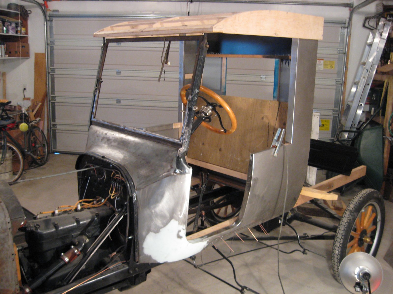

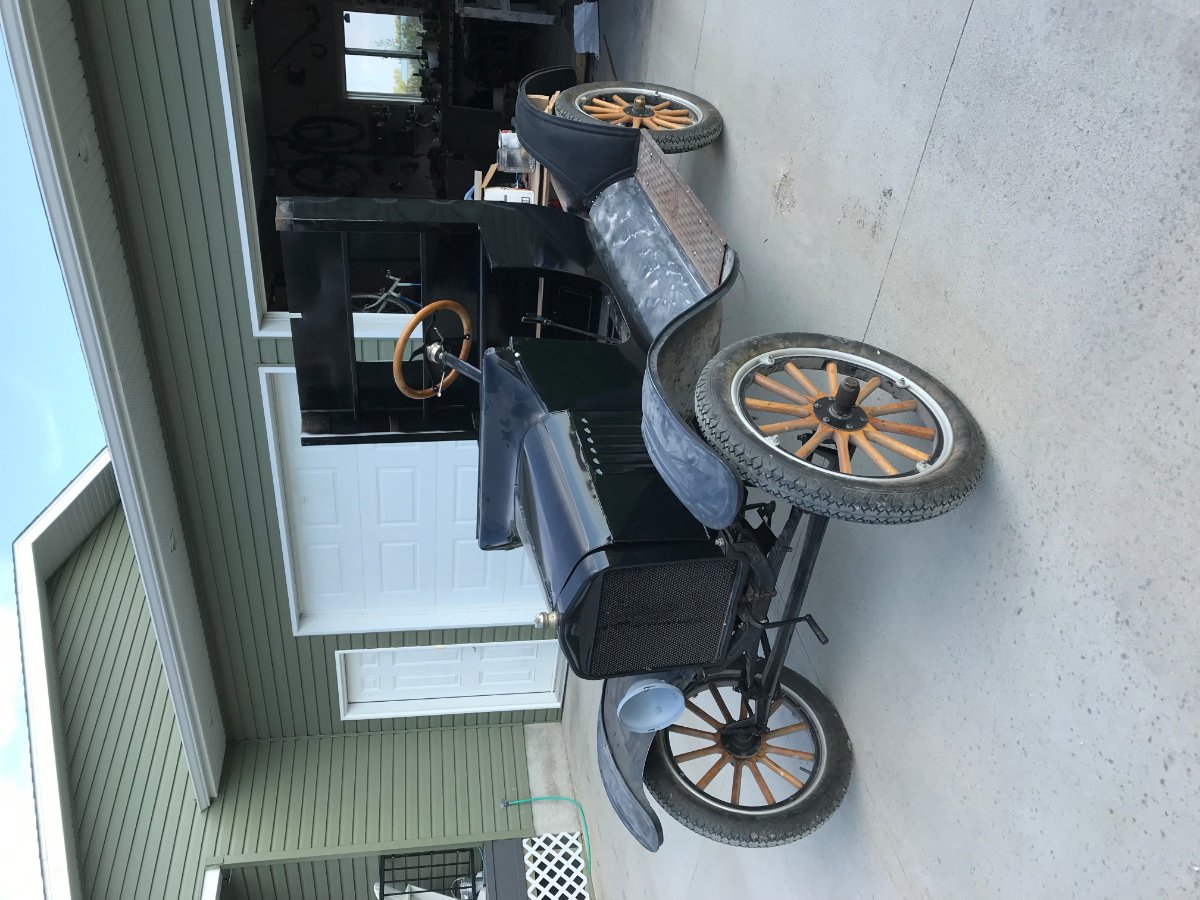

Hello Forum, I haven't posted in a very long time but I'm finally making some progress on my T. I bought it about 20 years ago and got the chassis running about 15 years ago, but life, career changes, moving etc kind of put a stop to everything and it sat in a barn for the last 8 years. it was almost to the point where it would qualify for a "Barn Find". I have it at home now and have been doing some work on it again. Here are some pictures:
Homemade cab
Homemade cab

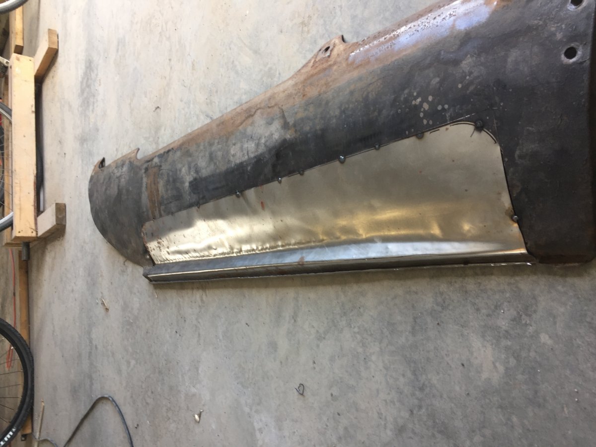

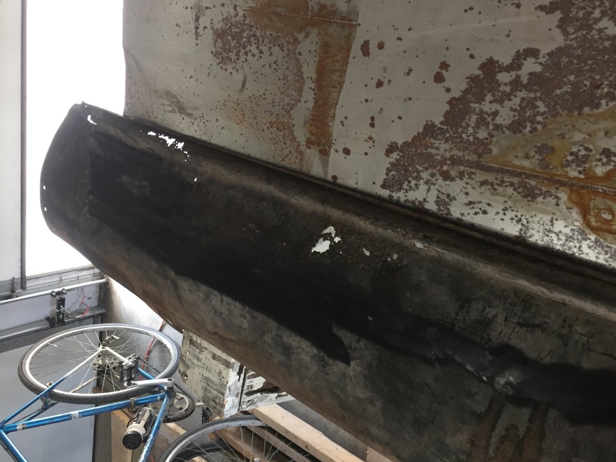

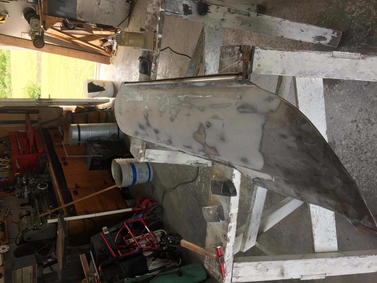

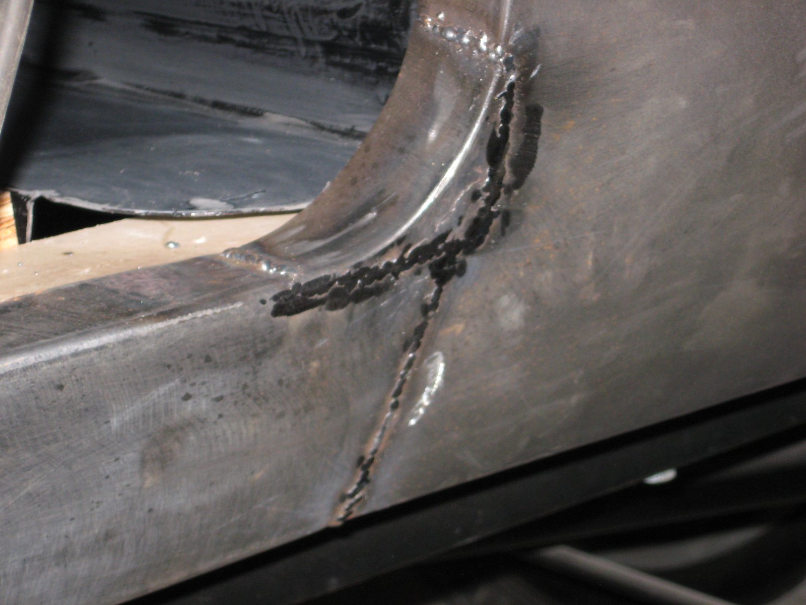

it was a cut off touring, but the wood was all rotten and the metal unsalvageable (by me anyway) so I built a cab for it. I plan to make a wooden pickup box at some point. I've been slowly hacking away at the body since bodyworkl isn't my forte, but I like making what I can. here's the repair of the drivers splash apron. I know I could just buy one, but what's the fun in that!

filled and sanded
filled and sanded
patch tacked in
patch tacked in
rusted out apron
rusted out apron

You have been busy! Lookin good. Nice job on the cab also.

I'm impressed with the way you "formed" the rear of the cab. Usually a cut off touring looks like...........well, a cut off touring! Your project has a "factory" air about it. Good job.

Thanks for the encouragement! everything in the cab except the cowl is new metal and new wood that I built. I mocked it up first with cheap spruce and plywood to get the dimensions and concept.
mockup
mockup
Then I made a frame out of maple and covered it with metal. Lots of little pieces hand formed and welded together.

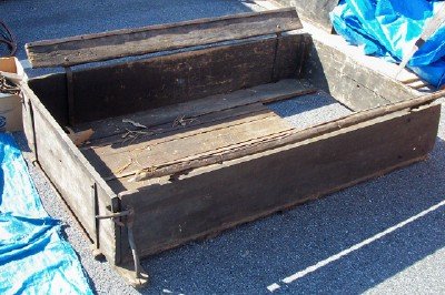

I hope the proportions look right when I'm done. I've seen some very nice pickup cabs, and some hideous ones! I hope mine will be the former. Does anyone have plans for a wooden box? I'd like something like this:
