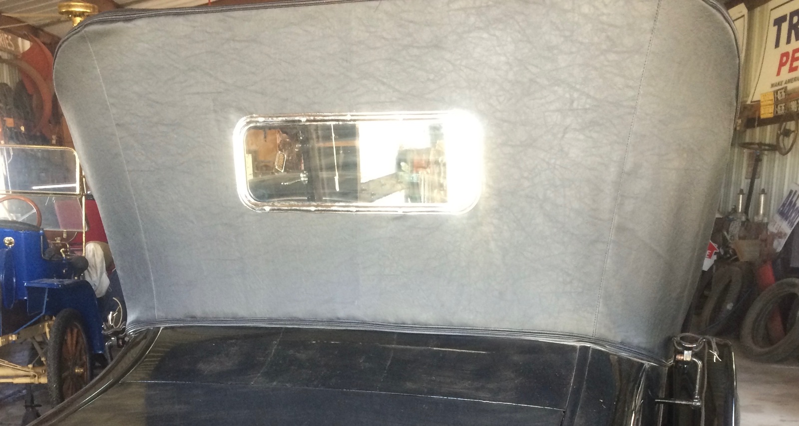

Install accessory metal framed glass rear curtain "lights."
Below is a photo of my dad's 1917 touring with Hastings rear curtain lights (he installed the top in 1951).

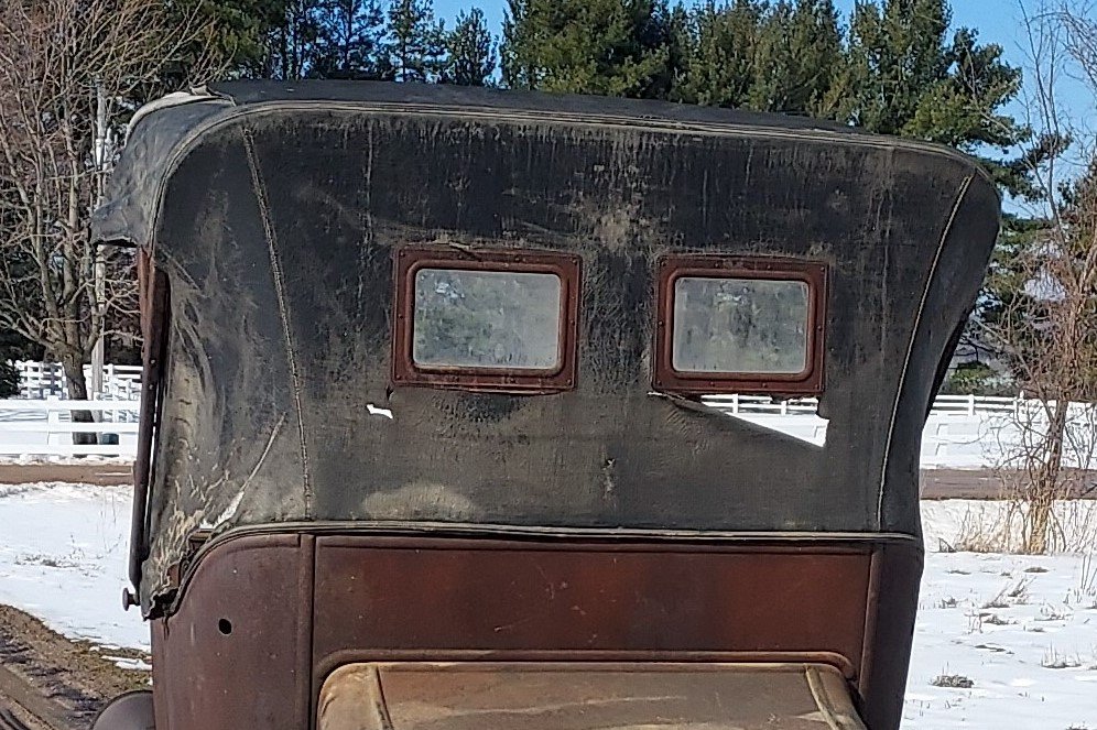

I agree with Erik. This is my original 1924, the rear plastic windows had been replaced sometime in its life with accessory glass windows. In my case the rear window outlasted the top. The metal frames with glass are available NOS at many swap meets, Ebay, etc., and come in different sizes for the various window configuration changes for the model T body changes.
