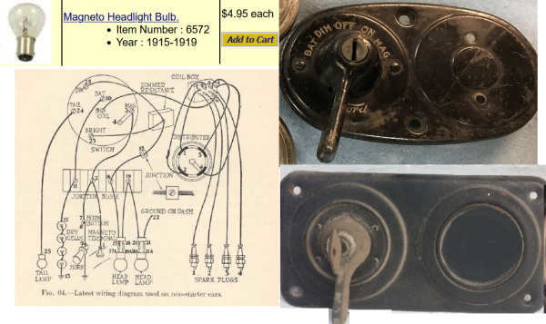

Posts: 6395
Re: LED Light Bulbs and Magneto
Post by TRDxB2 » Sun Jan 28, 2024 2:05 am
DHort wrote:
Sat Jan 27, 2024 10:22 pm
Correct me if I am wrong, but aren't the lights, horn, and starter on a DC circuit?
The magneto is only wired to the coils on an AC circuit.
So LED headlights never get a taste of AC current.
Non-starter cars (no generator too) depended on magneto. A dimmer was located behind the blocking plate where the Ammeter would have been. Models with the ignition switch on the coil box had a dimmer on the firewall

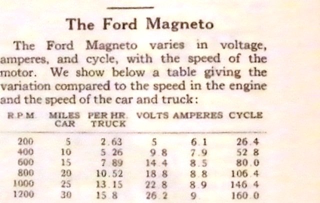

The magneto voltage also varies with engine speed. Would be interesting to see how a variable voltage, AC/DC LED would react
