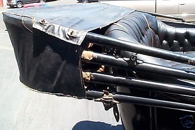

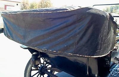

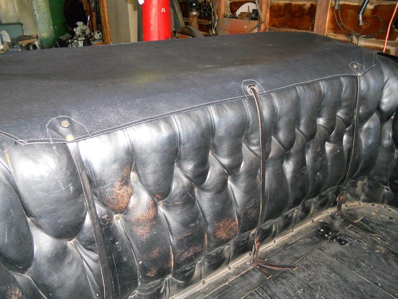

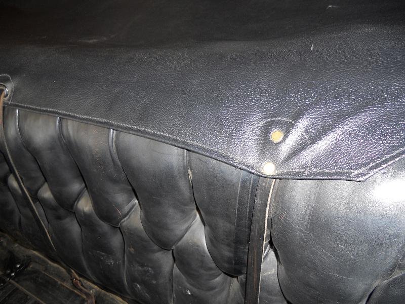

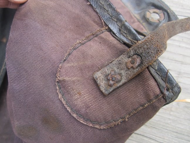

There is a question on the classified for information on 1912 top boots. I have some pictures to share of an original 1913, which I would assume would be similar. Note the straps, and the common sense fasteners were riveted to the boot. I didn't do this when I made mine, and shall correct it should I have an opportunity to do another. I did rivet the straps however.

Hey there Larry! Thank you for posting those pictures. Very helpful for those of us considering the making of a top boot.

I have many more photos to share if anyone wishes to see them. For some reason, I don't believe anyone has ever done the proper research on them, but I have tried! 1915 is the final year for the side flaps. In 1916 they went to the later style with no flaps.

I'd like to see more pictures of the '13 top boot to use for our '13 T. I agree with - why make it incorrectly when it can be made as it was originally?

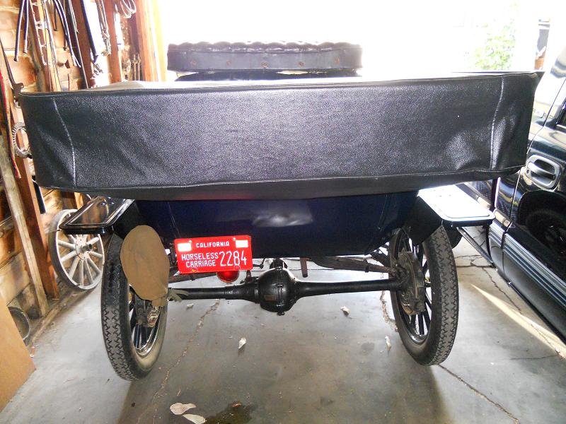

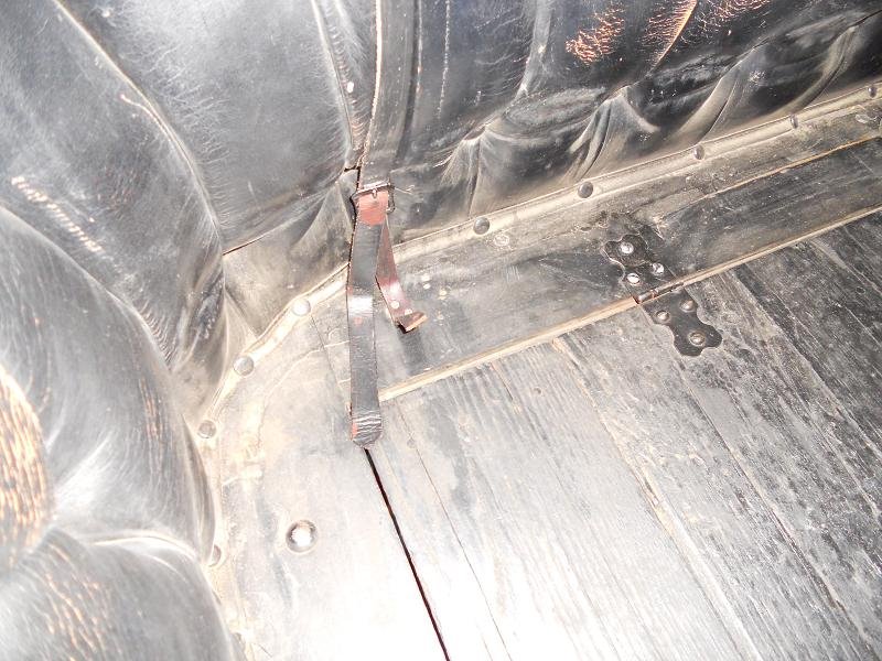

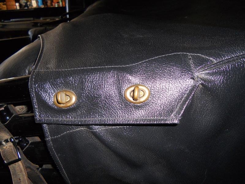

Here are more pictures.
1913 Top Boot.jpg (31.68 KiB) Viewed 5119 times
13 Top Boot 11.jpg (27.19 KiB) Viewed 5119 times

Thanks again Larry! I have bookmarked this thread so that if I ever get my '15 runabout far enough along, I can make my top boot at least something close to right. My car will never be perfect. But the closer everything is to right, the more I like it.
