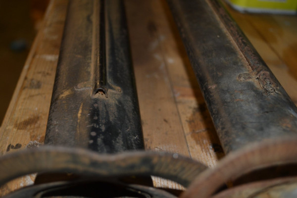

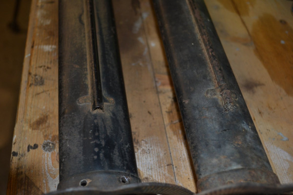

I have 2 steering columns I have been told are for 1916. They both have the two mounting holes for the horn button, but one has a U shaped channel for the horn wire while the other has the small round tube for one wire. Which would be correct for a 1916 made in December, 1915?

Here is what the Forum Encyclopedia states
1916
STEERING COLUMN ASSEMBLY: Pressed steel, brass-plated, quadrant, Brass-plated spark and throttle levers, with flattened metal ends, appear to have been used, although black painted rods have been seen. Gear case was brass, one piece assembly. Wheel was 15’’ outside diameter, wood, and painted black. The wheel spider was iron and painted black. Horn button was located on top surface, below the steering wheel.
1915-1917
Similar to previous type but small tube added for horn wire. Horn switch mounted on the top surface, just below the steering wheel. The horn bulb, when used, clamped to the column. Quadrant was painted black. Factory blueprint, dated February 26, 1916, indicates that the horn wire was changed from a tube to a steel stamping, welded to the column
So the tube

I've had both types of columns with the small horn tube - I'm going to venture a WAG that the single wire round tube was earlier than the simple single wire U-channel - simple economics perhaps ?

I agree with Steve. The tubular horn wire is held on with separate spot welded retainers. Then they found a way to do it more cheaply with the U shaped channel, which was later made larger to take two wires when the battery horn was introduced.

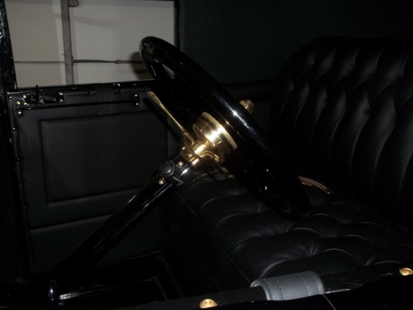

Here is the steering column on my 1916 coupelet. The car is a January 1916 car. The brass rivets holding the brass plated quadrant are a bit large, but the spark and throttle rods are original and brass plated steel. I hope this helps, Russ Furstnow

What type of horn wire tube is yours Russ ?

My 1916 column has the tube for one wire. Russ Furstnow

The gear case on the one column still has nickel plating on it, so not 1916? Interesting though, that the quadrant and levers on that same column do not have a speck of paint showing, while the column itself is still black. Suggesting long gone brass plating which would have "fragile" and prone to wear and corrosion. Also, notice that the quadrant neck is much longer than that on the other column. Notice too that the quadrant on Russ Furstnow's column also has that same longer neck. The odd nickel plating aside, my guess is the upper column may be 1916?

Jerry, I restored the column for my 1917 coupelet (May 1917), and it has a nickel gear case and cap. The quadrant, which is identical to my 1916 column, is painted black, and the spark and throttle rods are nickeled. The horn button remained on the top of the column as my 1916. Russ Furstnow
