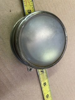

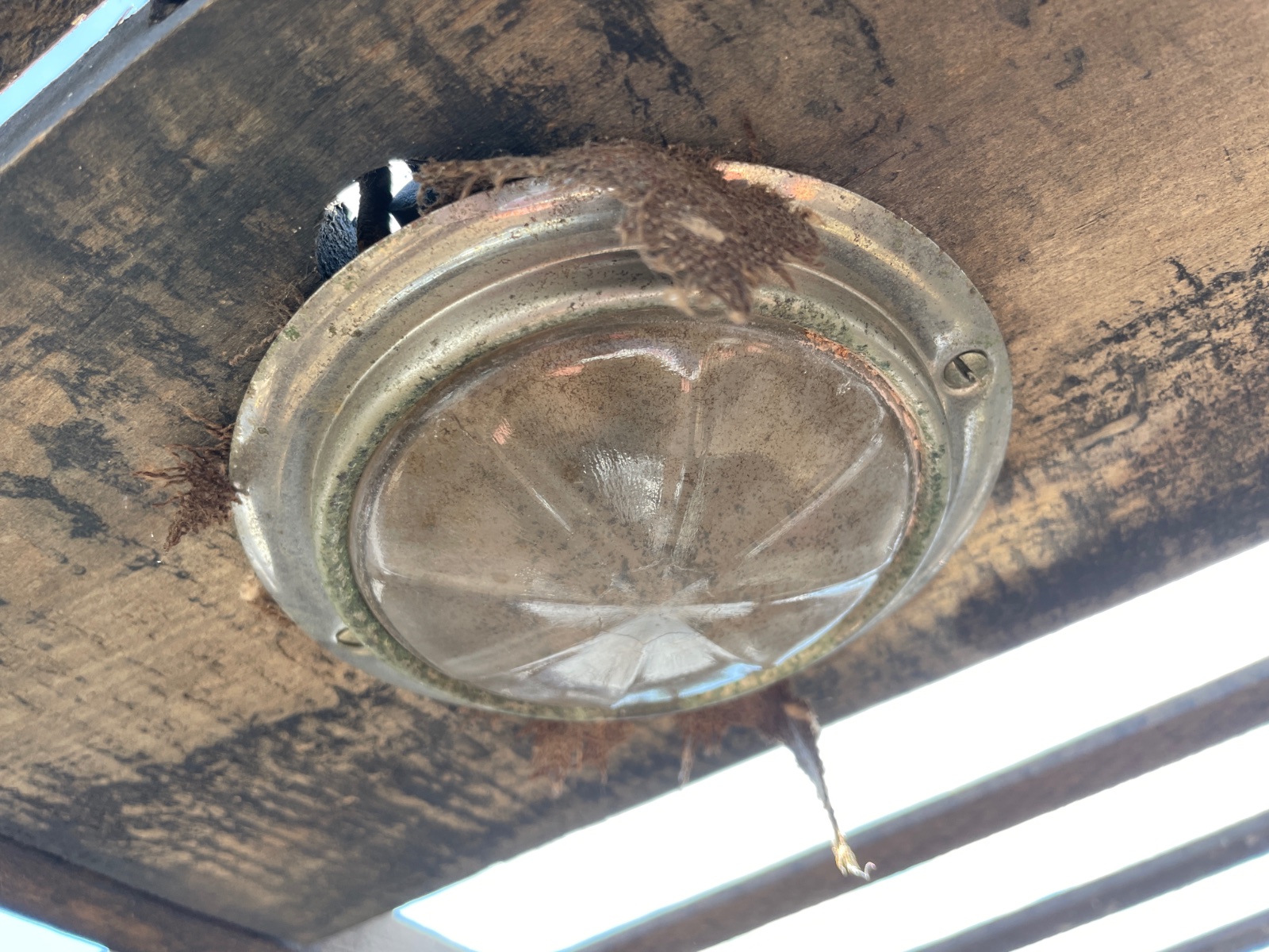

I bought a dome light but it does not match the mounting holes in my car. Maybe someone can identify it for me.It is 3" round and the mounting holes are 3 5/8 " apart. It was supposed to be for a "T". The mounting holes in my car are 4 1/8" apart. Thats the light that I need . Anyone have a picture of it. Thank you

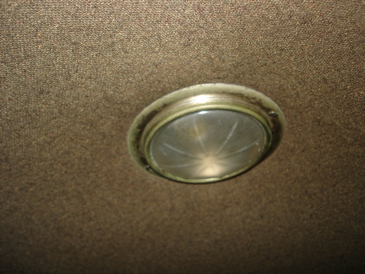

This is the proper dome light...
Sorry for being a bit out of focus. It was something of an ordeal to even get to it.

The above pictured dome light is the proper one for a fordor. I don't know if it was used on fordors prior to 1926. The glass lens with what I call a "star" shaped pattern to it is correct. The metal part should be nickle plated. I have seen glass lens that were plain without the "star" pattern that will fit the bezel, but they are not correct. BTW: Vernon, Be Very Careful when buying parts from sellers who say parts fit this or that. Knowledgeable T owners who you see on the Forum will steer you straight, but "Joe Blow" who just collects junk and at best has one or two old cars which may or may not be Model T's, probably doesn't know his ears or nose from a hole in the ground (cleaning up the old saying).

Thank you for the pictures and info. Now I know what to look for

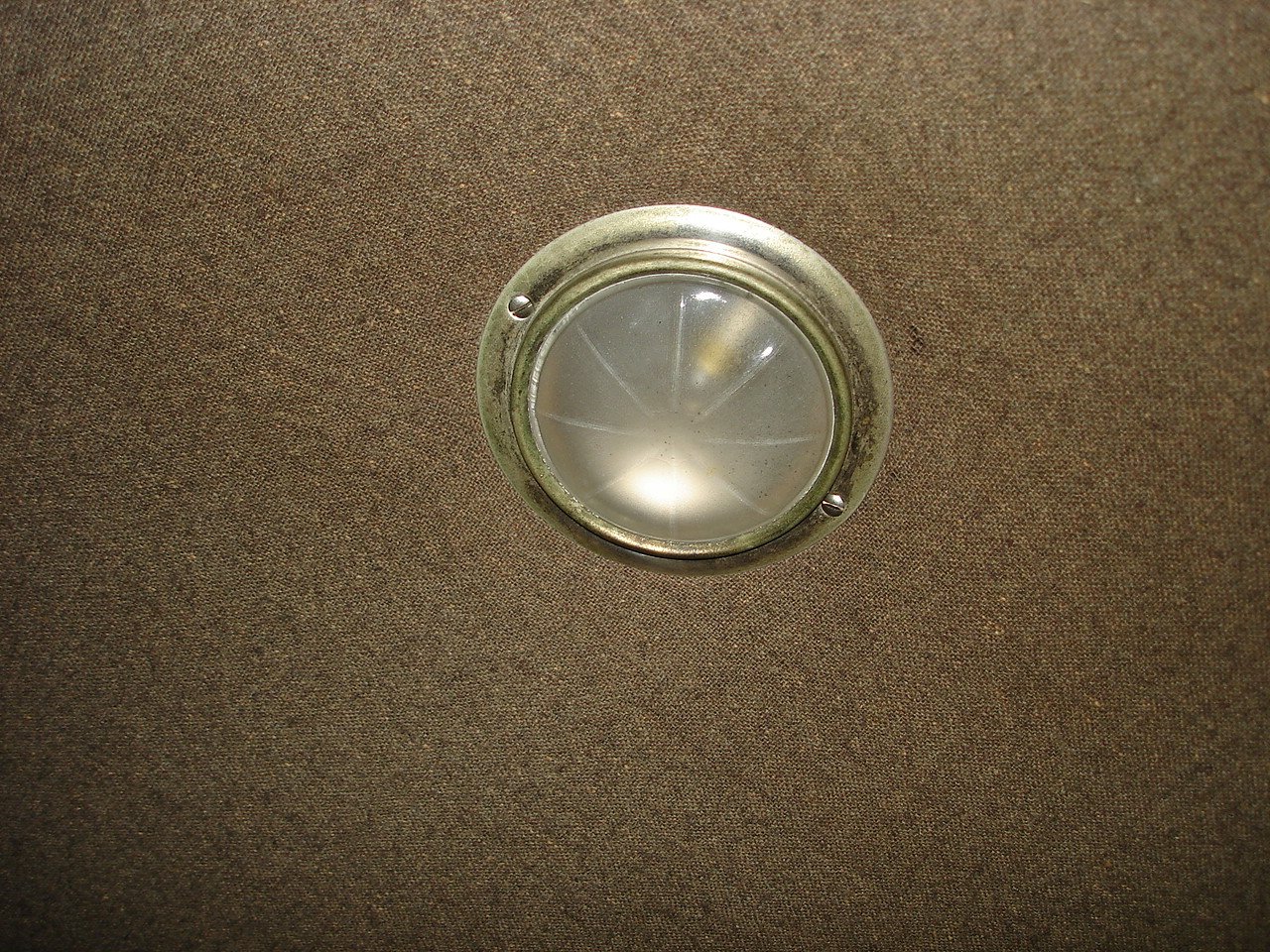

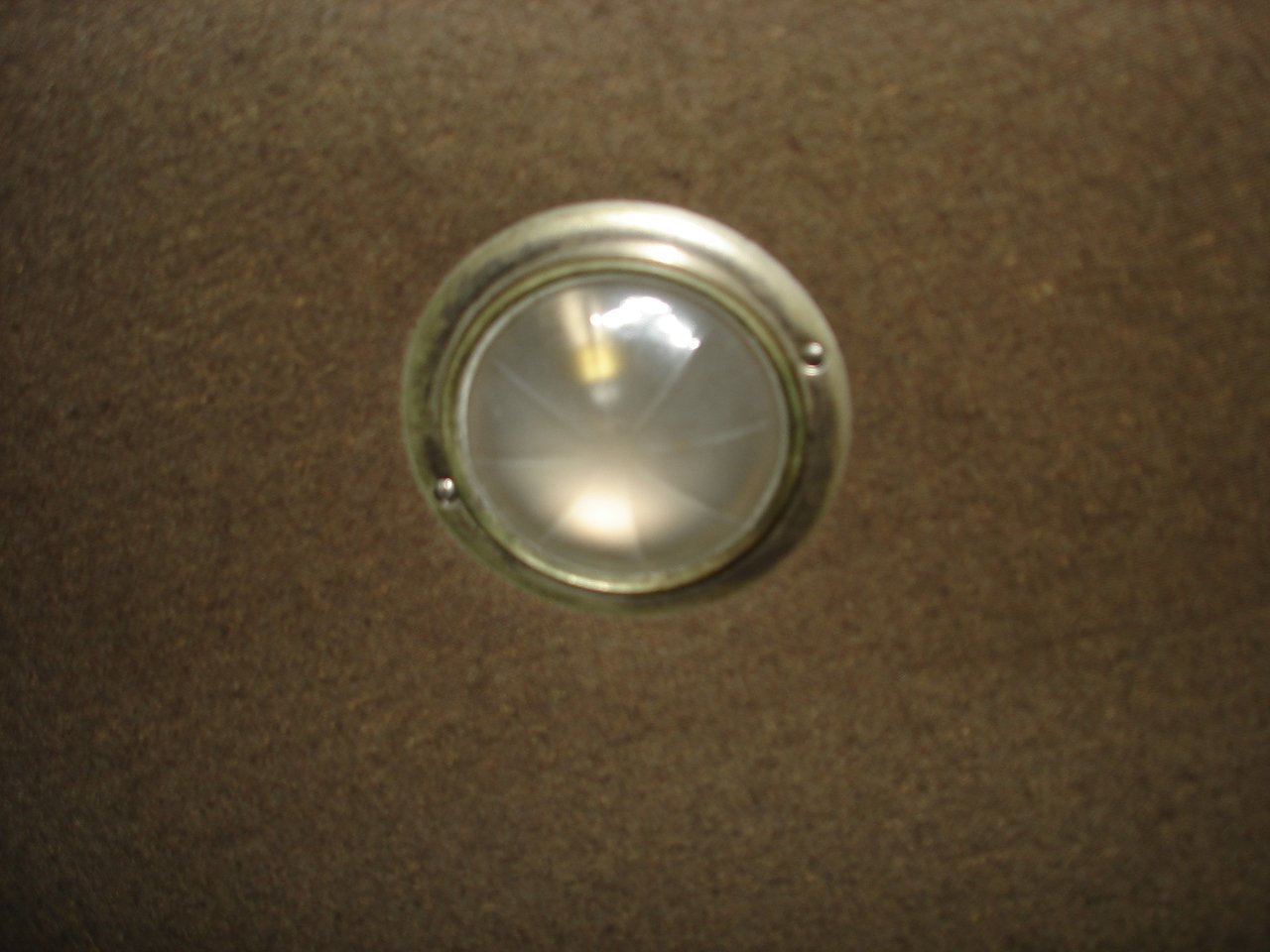

Joe Bell found one in his T collection!

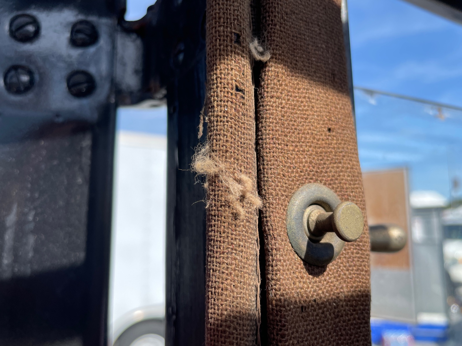

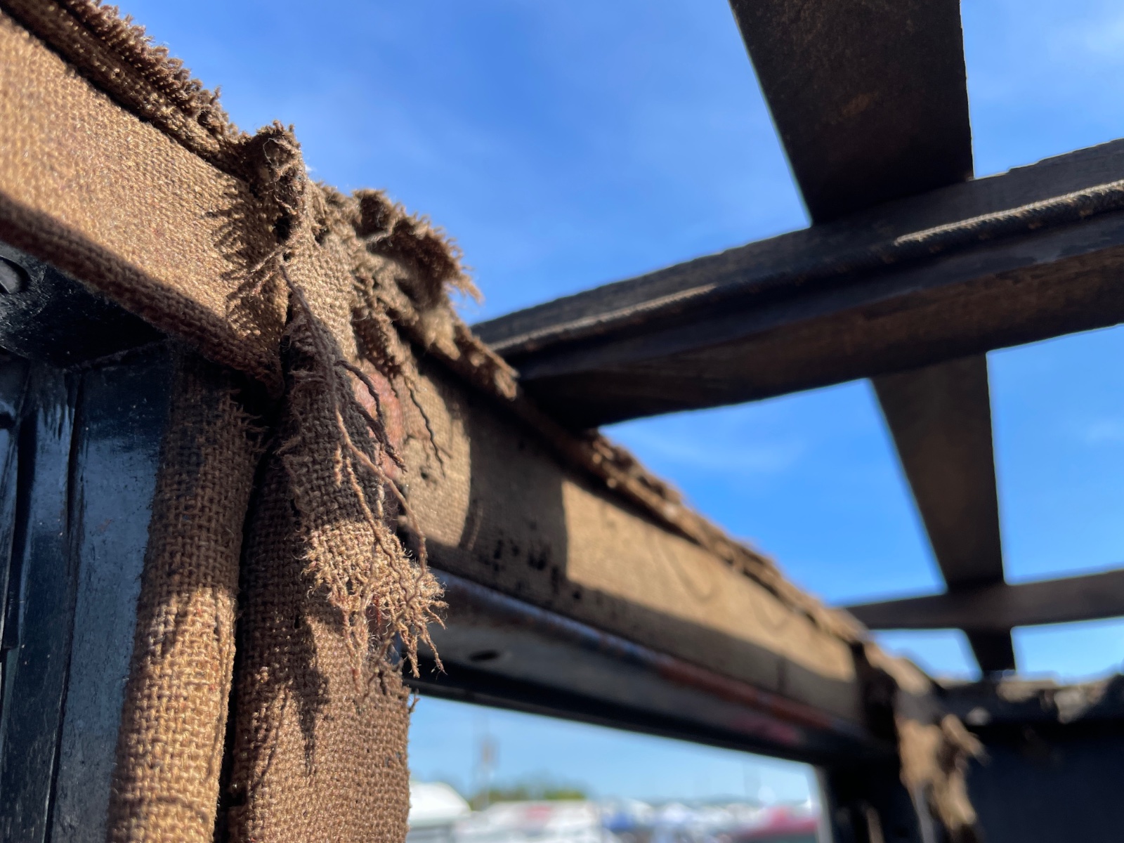

A few pics of an original Fordor roof lamp and wiring and pillar switch.
