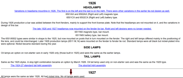

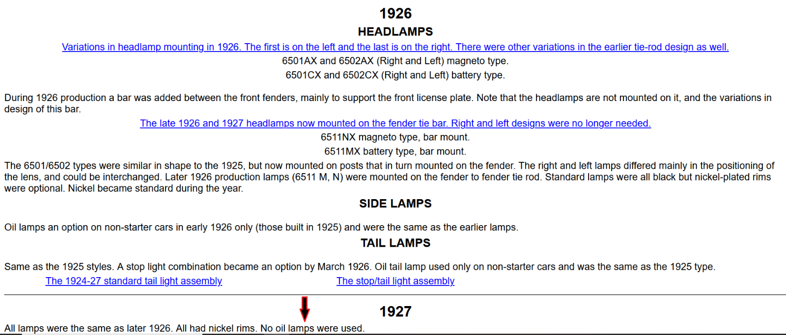

Posts: 6395
Re: kerosene lamps eliminated in touring cars
Post by TRDxB2 » Mon Mar 18, 2024 5:21 pm
From the MTFCA Encyclopedia https://www.mtfca.com/encyclo/I-O.htm#lamps
No oil lamps in 1927
