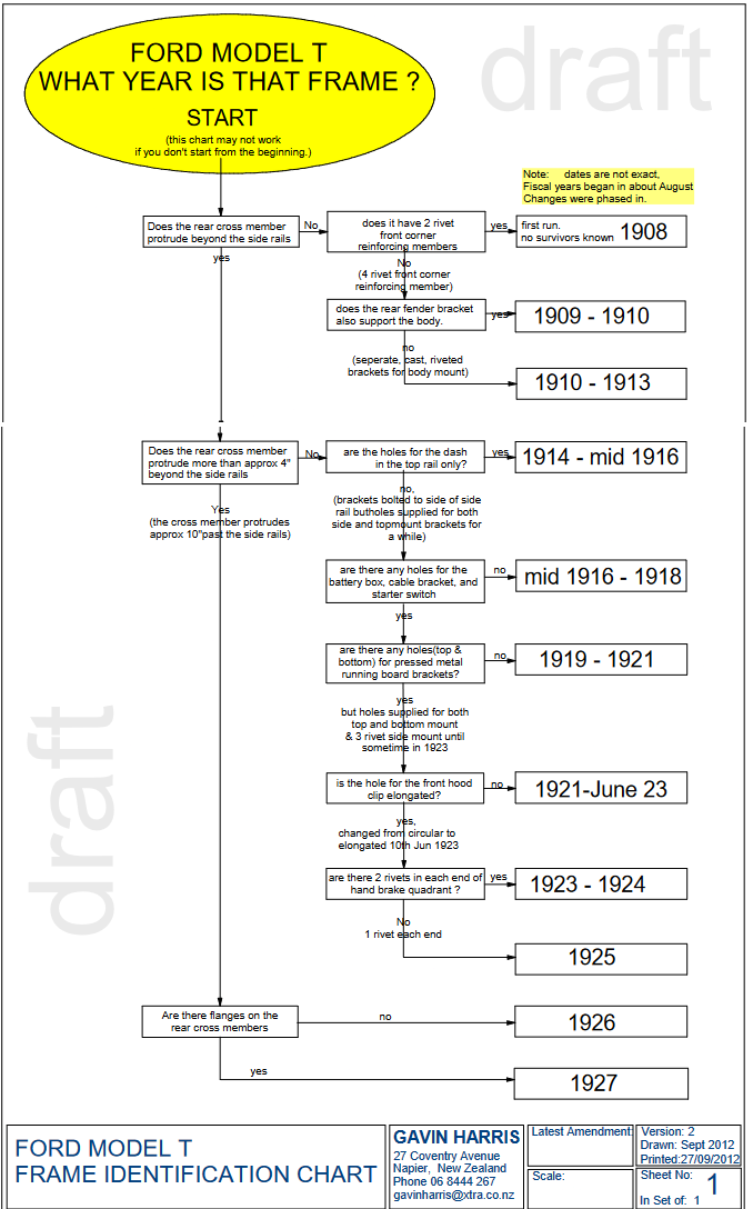

Post by TRDxB2 » Sat May 04, 2024 12:59 am
A lot of the responses reference frame differences. Have you identified the year of your frame?

Frank. I have seen that. But the rear crossmember was trimmed and there are many holes in many places on the frame so without a diagram of frames marking what holes are what and where they are located it's a daunting task. Some holes are square, and some are round. Little was attached to the frame so I would not know what was attached where.

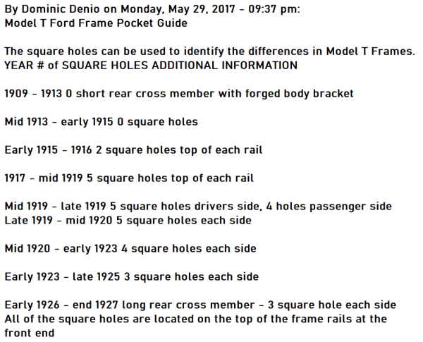

Some more info. Square holes are not usually a DIY

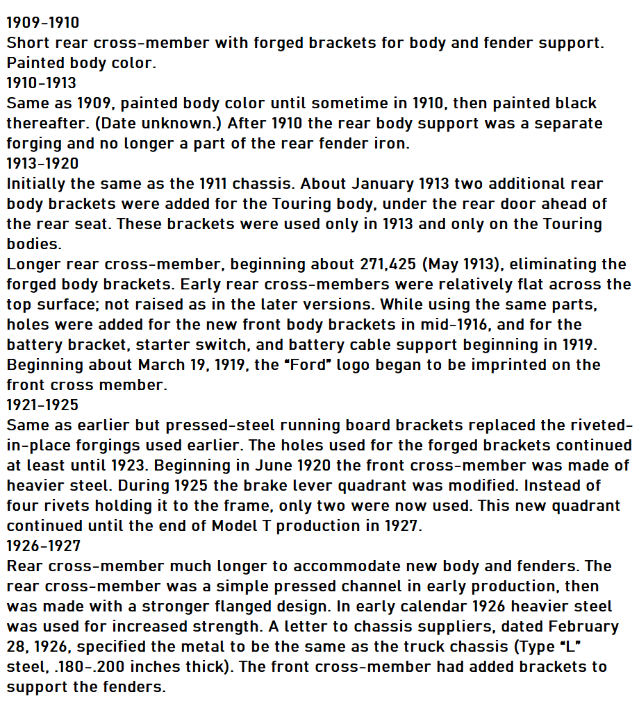

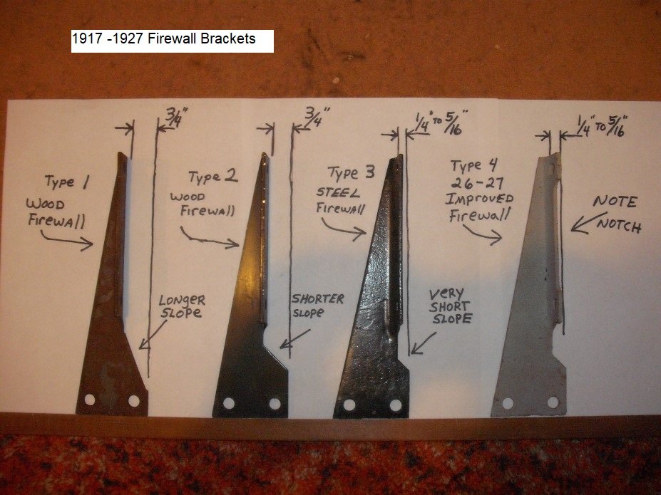

Encyclopedia
