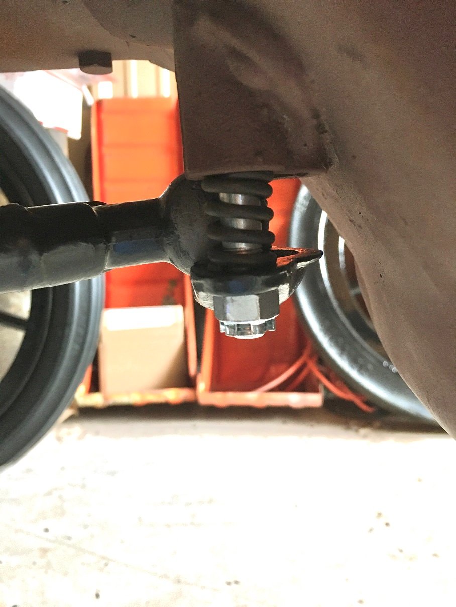

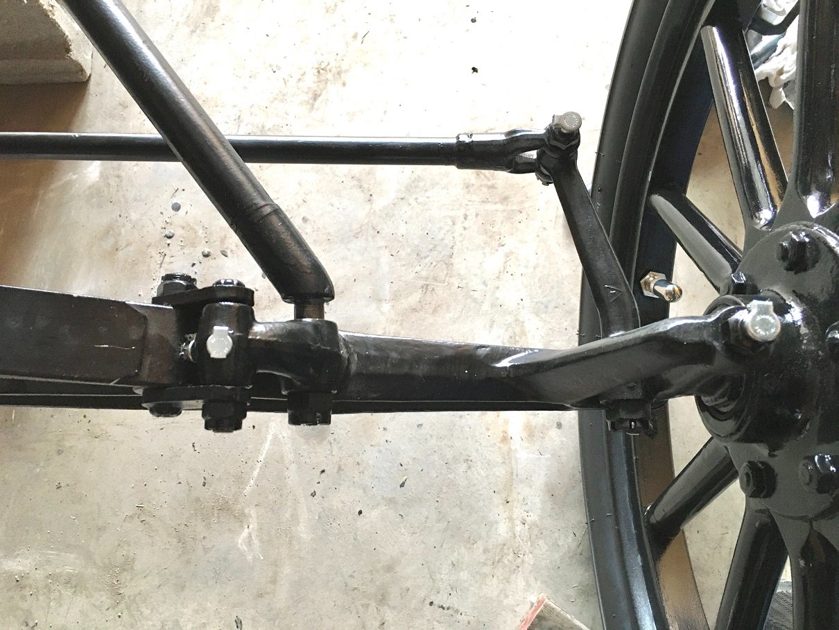

I’m building up a 1918 TT chassis and have the front end done with the wheels attached. Now I’m at the point of being ready to installing the rear end assembly and look forward to having a chassis that I can roll around. With the long driveshaft tube of the TT, I placed an oil pan with transmission cover on the frame to give the forward end of the driveshaft tube its proper support. Being a pre-1919, the front radius rod is type mounted above the front axle, and thus needed to be installed before I placed the oil pan on the frame. But… I find myself unable to attach the radius rod ball in its bracket on the oil pan – it doesn’t want to reach! I tried loosening the nuts at the front of the radius rod to scoot it back a little, but it’s acting like the radius rod is too short. I know it isn’t, so what do I need to adjust to get everything to fit?
For background, most all the brackets at this point are still loose so the fit has some wiggle room. The front motor mount allows the springs to be lifted up and down on each side and spring shackles swing up and down easily.
The photos below show how the front radius rod ball doesn’t want to seat back into the support bracket on the oil pan even after “moving” the radius rod back by loosening the front attaching nuts as far as I dared knowing I’ll need some threads protruding when the time comes to pull it back into place.
Have any of you had this dilemma and found what was needed to get the front end to fall onto place?

Hard to tell from the dark picture, but it looks like your front axle perches are on backwards. The boss on top should be offset to the rear.

If Jeff is correct, you can just reverse the placement of the axle. Remove the two steering arms, the wishbone, the spring to frame clamp(s) and turn the whole axle 180 deg. Trying to remove and reverse the perches is difficult to impossible. I've seen this situation before......on a National show winner 1913 touring at Hershey....

I noticed the same thing, Jeff

To the best of my knowledge Rich; a TT never had an ‘above the axle’ wishbone. Much has been written on this Forum on techniques to insert the wishbone ball into the pan socket. My technique is wrapping the center of axle with leather glove or rubber mud flaps and adjust a large pipe wrench over the material. Having your wife step on the pipe wrench will move the axle to usher the wishbone ball into the crankcase socket. And the axle will have the correct ‘rake’ when everything is removed…Is that a 30x3 tire in your pic ?

From your picture I can’t tell if the 1918 type spring perches are on correct side or not. But in the past with the later 1919 type front end I have had to put some weight on the front to compress the spring some to get the radius rod attached. Ford first used the 1919 type spring perches and radius rod on the TT truck because of the better front end geometry. I remember something in the 1918 Ford service bulletins about all trucks using the below axel radius rod and new , (1919 ), type perches.

Correct. This is not an uncommon thing. It can also be caused by the front crossmember being a bit bent and by the spring being installed a little out of alignment. Loosen your front spring clamps a bit and see if it helps by allowing you to draw back the wishbone until it enters the socket. When it's all buttoned up, confirm that you have a negative caster angle.kmatt2 wrote: ↑Wed May 29, 2024 8:37 pmFrom your picture I can’t tell if the 1918 type spring perches are on correct side or not. But in the past with the later 1919 type front end I have had to put some weight on the front to compress the spring some to get the radius rod attached. Ford first used the 1919 type spring perches and radius rod on the TT truck because of the better front end geometry .

but the root cause may be different. The first thing to do is to make sure the perches are on the correct side. The boss on the top of the perch should be towards the rear of the car. The easiest way for the early ( two hole) perch is to look at the radius rod hole. Also make sure that the correct nut is used, easy to use the later nut when the perches are facing the wrong way.

If you do take the axle and swap it end for end rather than swap the perches, you will need to consider the spindles also.
The left hand thread spindle goes on the right side, and vice versa.
The spindle arms go into holes in the spindles set up just like the holes in the perches in the previous post. The arms have a slight radius behind the shoulder and the hole in which they fit needs a corresponding chamfer/relief to allow them to seat properly.
This correct fit of the spindle arm dictates the spindle required at each end of the axle.
This is a long winded way of telling you that just swapping the arms will not work!!!!

I too had considered that I made the mistake of having the spring perches swapped and I actually disconnected the shackles on one side and withdrew the perch and made sure the angle tipped the axle forward. It did.
In the end I think Kevin M had the correct idea which was the need to add weight over the front spring. With the spring compressed the vertical distance between radius rod and the oil pan would be reduced, and thus less swinging up the rear end of the radius rod to mate with the bracket on the oil pan. I placed an engine block on the pan which did compress the front spring a bit. My spring is a standard seven leaf spring, but still sits fairly high above the axle. I guess I’ll have to wait until I get the wooden cab on the chassis before the front radius rod will be happy.
