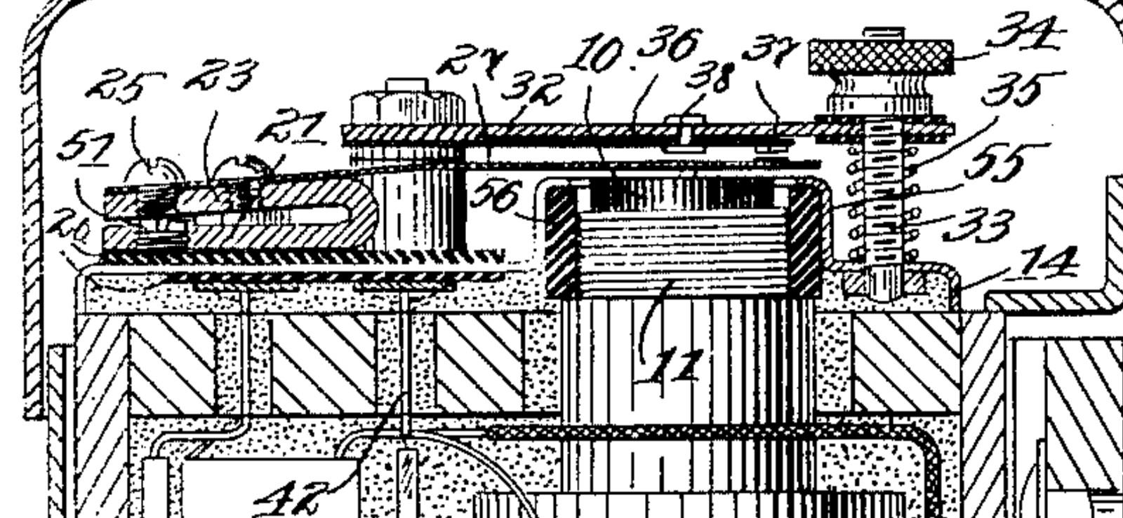

So everything I’ve read regarding points starts with the geometry but then drops off at fill in the dents left by the stand off with a shim or washer but the point set and two stand off bits don’t even work on the surface plate.

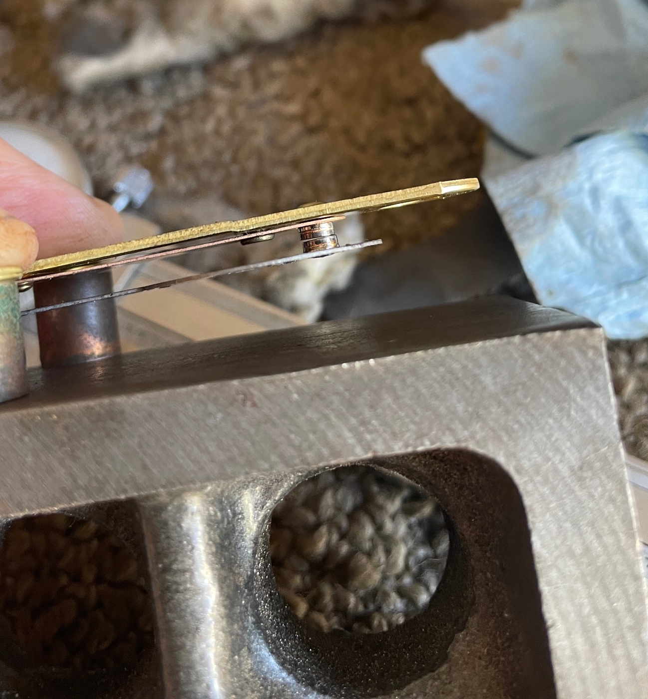

The points that I bought are missing the bend in the spring steel that allows the two components to run parallel.
Posts: 5604
Re: Points
Post by RajoRacer » Sat Jun 01, 2024 11:53 am
The illustration you posted is of the "early" style of points - not used on later coils.

Post by Moxie26 » Sat Jun 01, 2024 11:59 am
Also,... The illustration is of a early brass top coil..... There is enough movement available of the vibrator and bridge point mounting studs/ nuts to allow movement front, back or sideways so the points may be installed point on point and then tightened down.

'The points that I bought are missing the bend in the spring steel that allows the two components to run parallel.'
Both 'arms' of the point set will be flat before assembly. After assembly the lower, movable (armature) point support will be flexed as shown in the drawing you posted. This will be the case for both the brass top and plain wood top coils. The 'flex' of the lower contact cantilever spring produces the force to close the contacts, then the increasing magnetism in the coil core eventually overcomes the spring force to open the circuit. Tuning the coil is the process of bending the lower spring support bridge up or down to decrease or increase spring force to resist the pull of the electromagnet until desired conditions (Time delay, primary coil current, etc) are reached and the contacts open, firing the plug. Have fun! jb

So my original question is more about the quality of the currently available parts and if they meet design intent.
The contacts are NOT parallel as shown in my attached photo on a controlled surface. Ironically the impressions in the coil top wood actually provide better conditions.

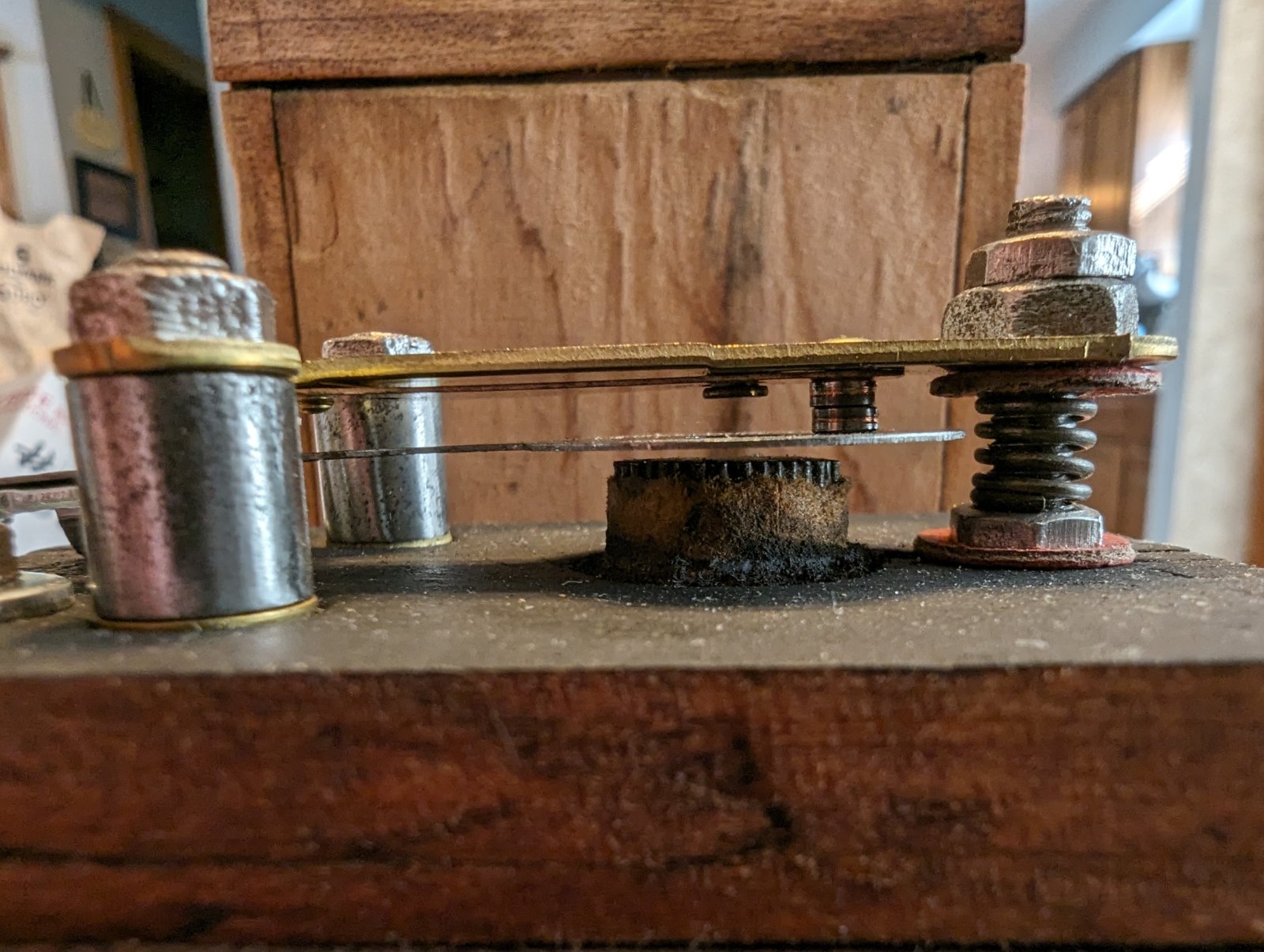

Once you install your points, see if you could physically adjust as in the pictures. With the bridge adjustment , adjust between vibrator and cushion spring points at 0.030"...... But as far as today's coil point manufacturing quality, the ones that are currently made and available at Snyder's or Lang's are QUALITY.

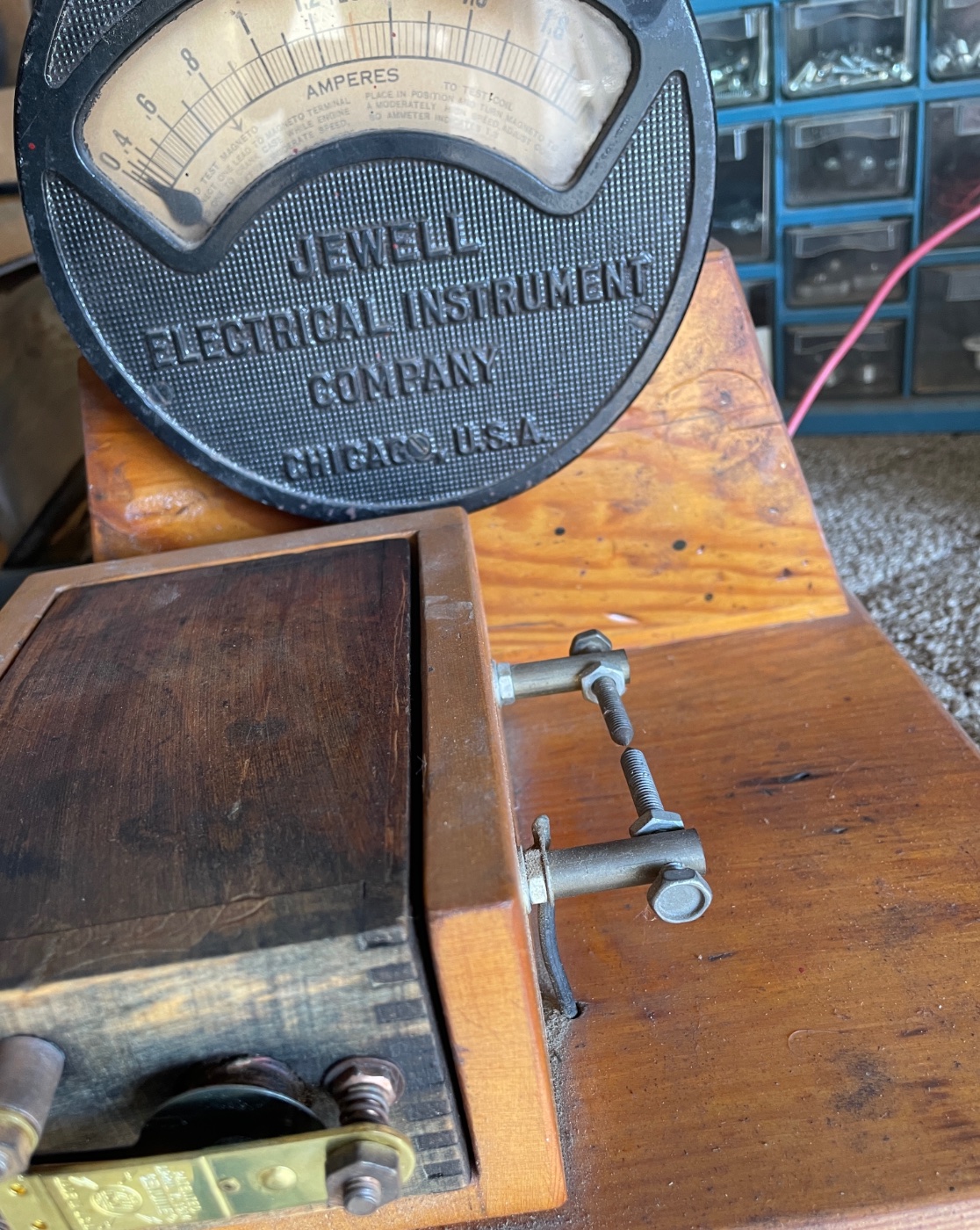

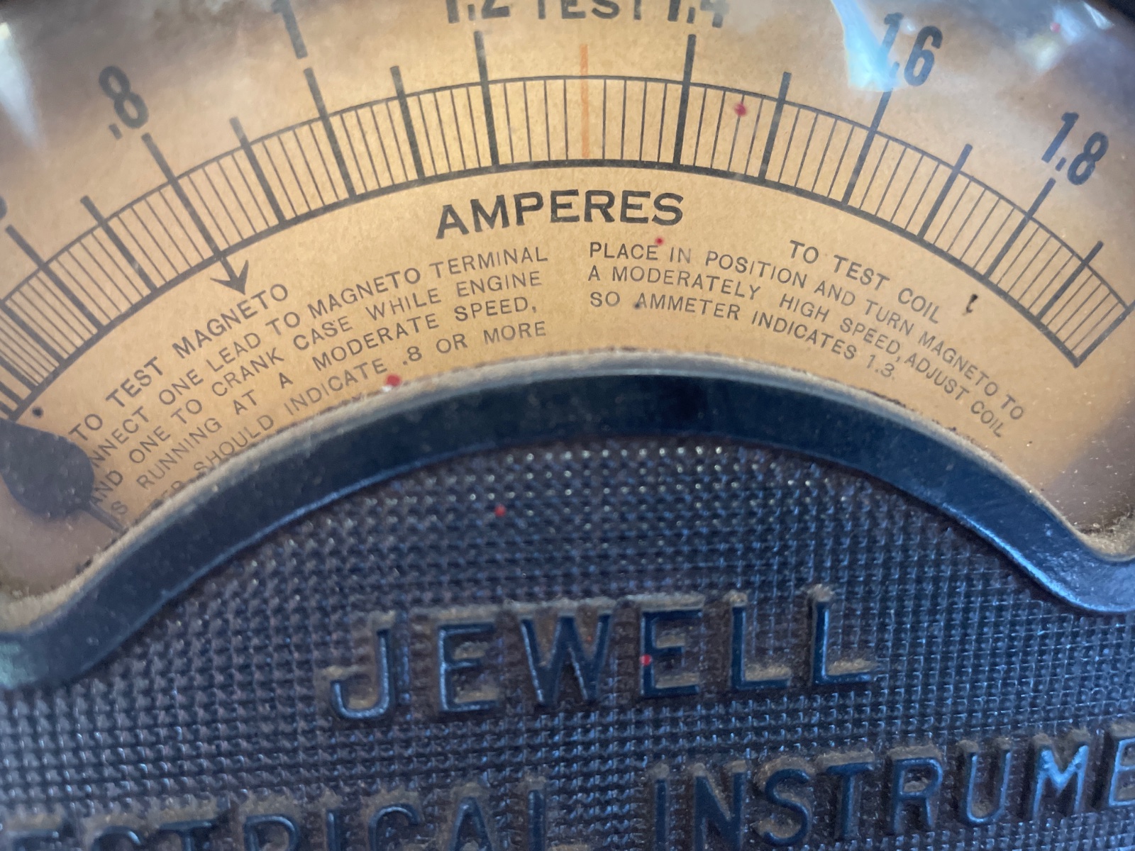

The meter I have tests the magneto AND allows the coils to be adjusted but the caveat is that you need an extra coil so the car runs while you adjust the coil. I don’t know if I will be able to detect the number of pulses.

I see. You need an external power source(magneto) from your running T.
You need a better tester.
You basically have a buzz box set up with no power source.
Take your coils to a local member with an ECCT unit.

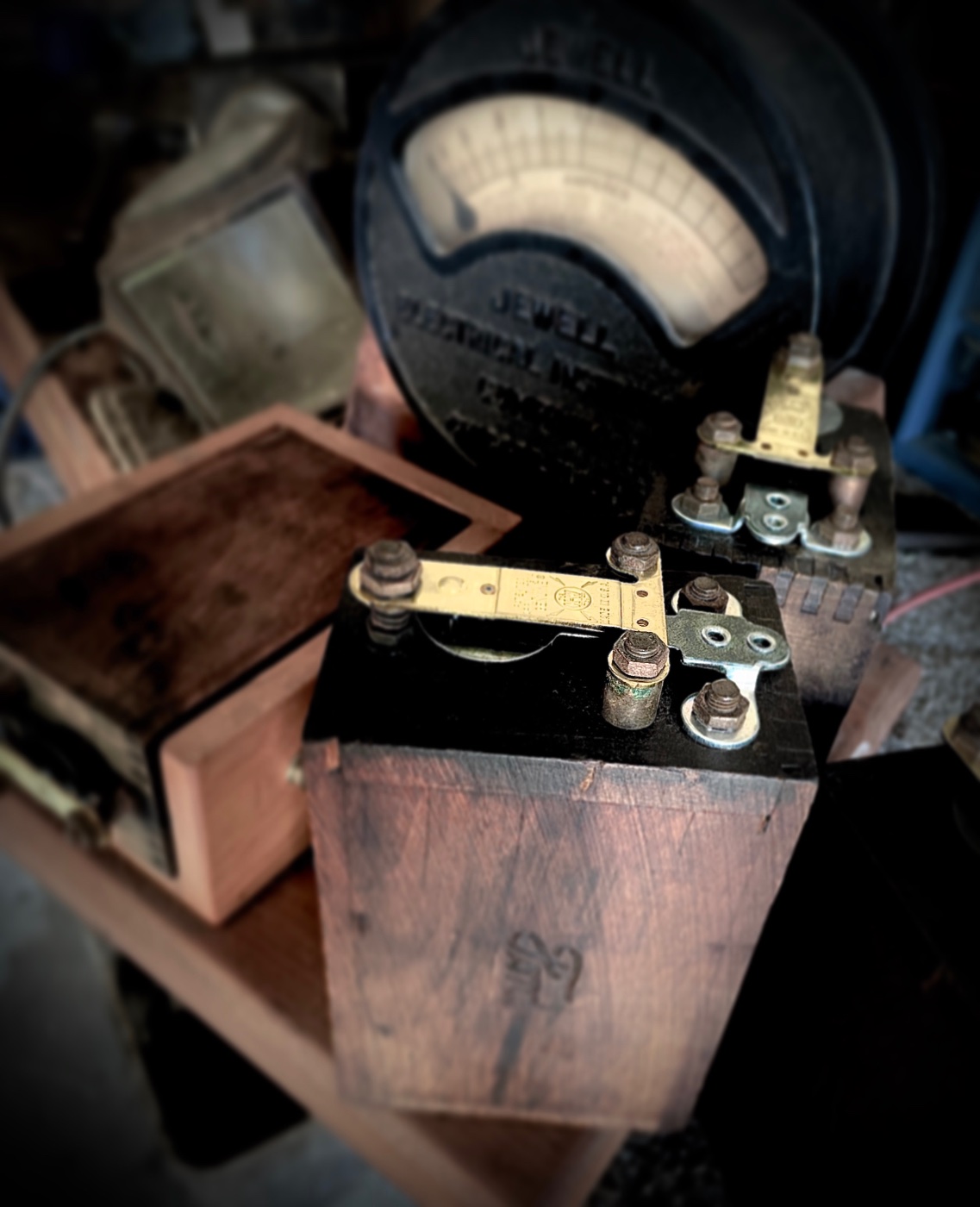

I flattened the coil box tops with two part filler, installed the points sets; each set was slightly different the the rest with one being not even close. The top cushion springs seem to be consistent but the base from which the bottom springs are mounted are all over the place. The two “feet” weren’t even parallel to each other and the amount of spring pre-load or the angle at which they are set at initially varies. I reworked the latter but have yet to see if the tension produced is anywhere near what is required or matched between coils. The tungsten bits are as close to full contact as possible and I’ve got the .030 +\- .001

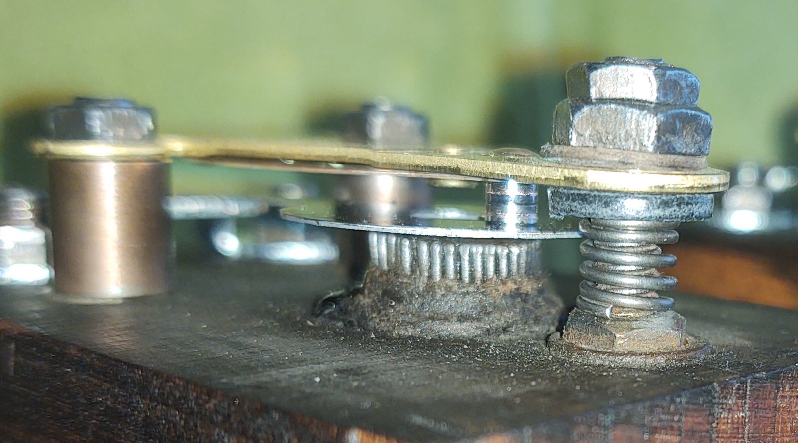

This will help with point alignment. I rebuild a good amount of coils and found early on I was wasting a lot of time shimming the recessed wood top especially under the two spools that hold the bridge. One side maybe be .040 and the other side .020 or the top was warped. These coils are definitely showing their age but still very functional.
So to help I made a point pad that provides a nice flat surface for both points. I have found point alignment is much easier to archive which will allow the contact surface to wear more evenly.
If the recessed area is more than 1/16 I recommend to back fill them with some putty to help support the pad. If not that they are over tightened it could crack the pad.

Post by Woody23 » Thu Jun 27, 2024 8:37 am
Hello, the pad will not change any settings when adjusting points.
I have found the pad actually allows the points to be more perpendicular to the core vs without it sometimes the points are at an angle to the core. This translates to more stable point performance.
Not all coils need them but I use it on most of them I rebuild. I also have used them on brass top coils, again not all but sometimes found it to help with point alignment.
The better the alignment the more even the points will wear.
