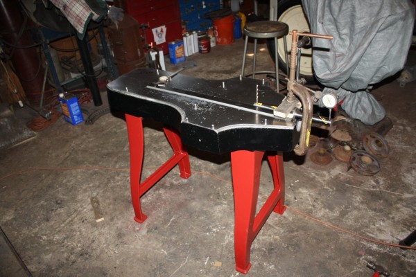

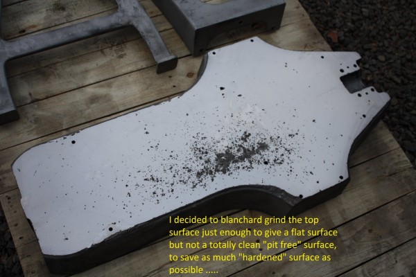

KR Wilson pan jig ... finally restored :)
Post by dobro1956 » Thu Jun 06, 2019 12:51 am

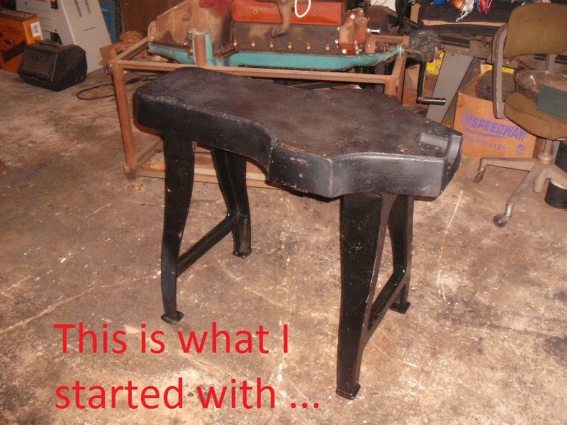

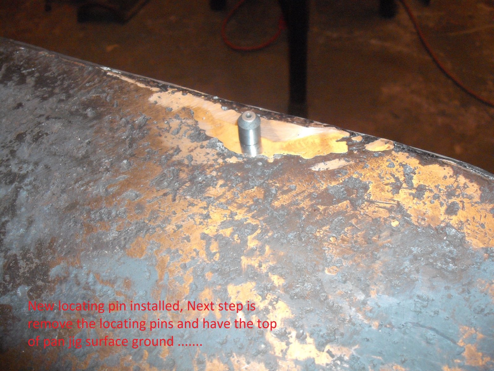

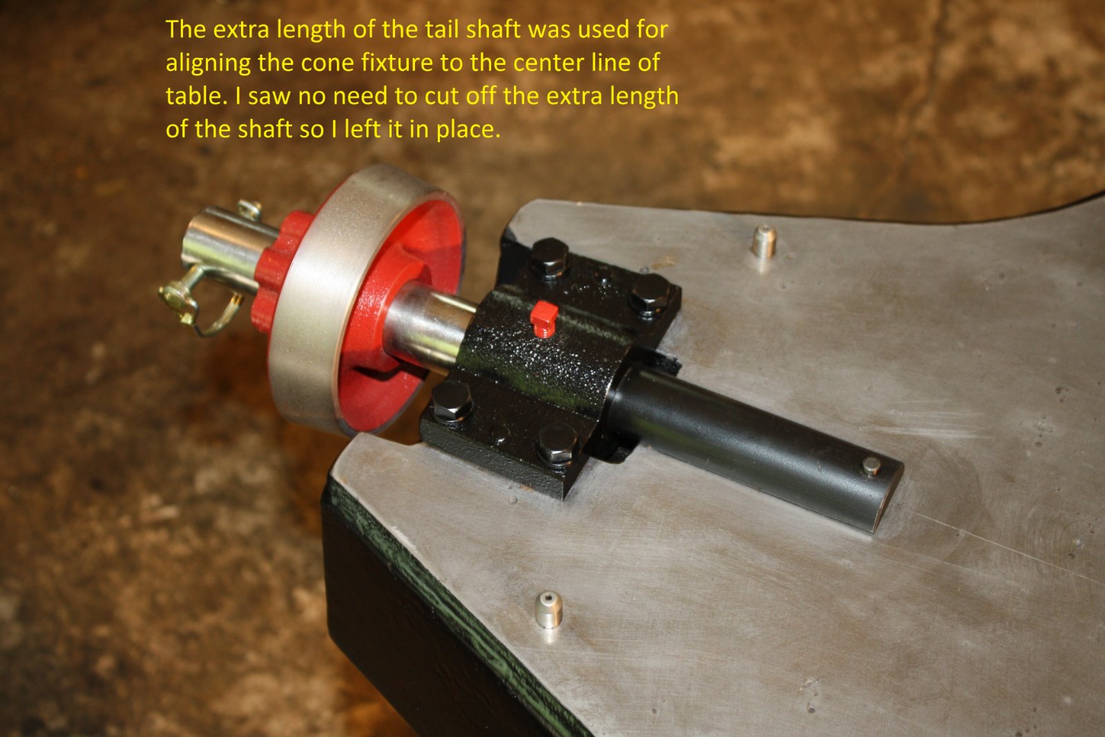

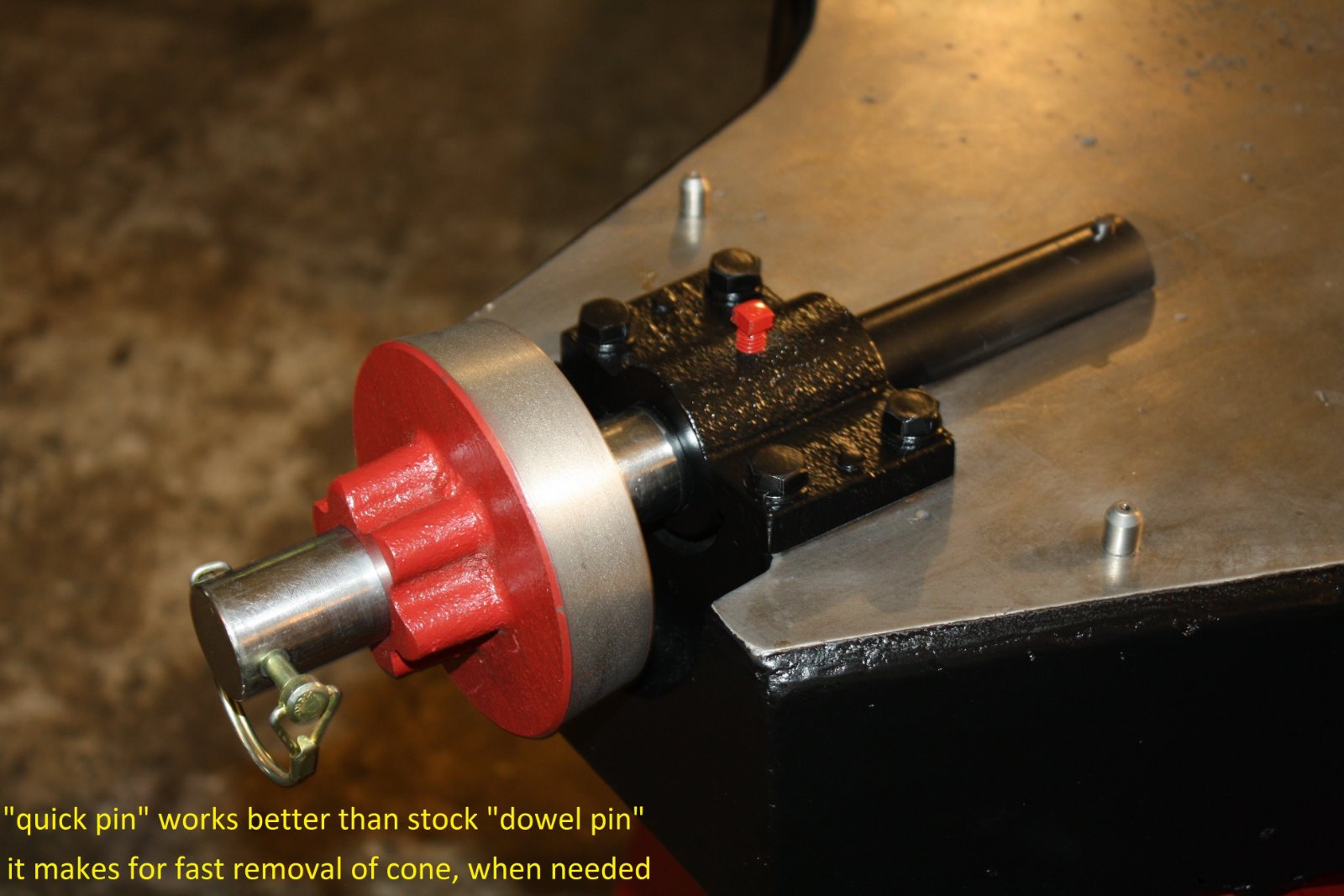

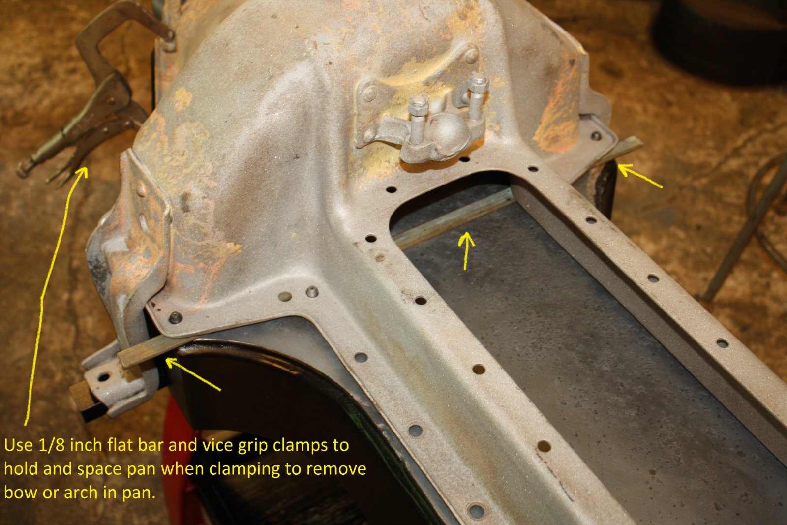

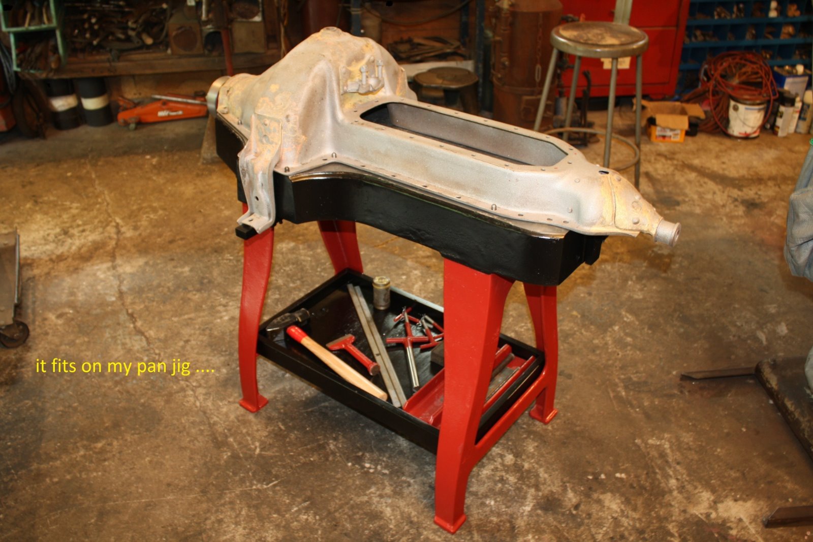

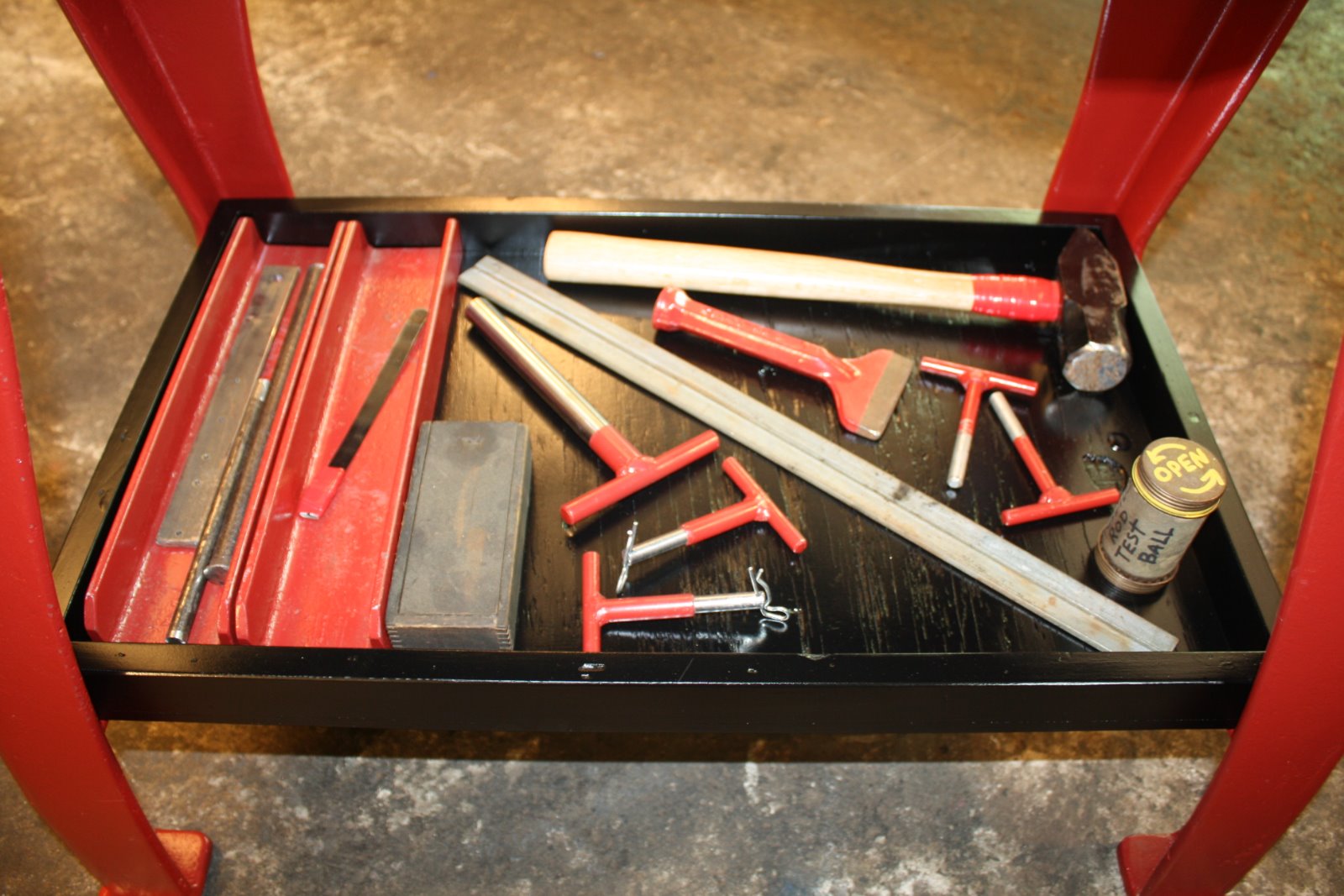

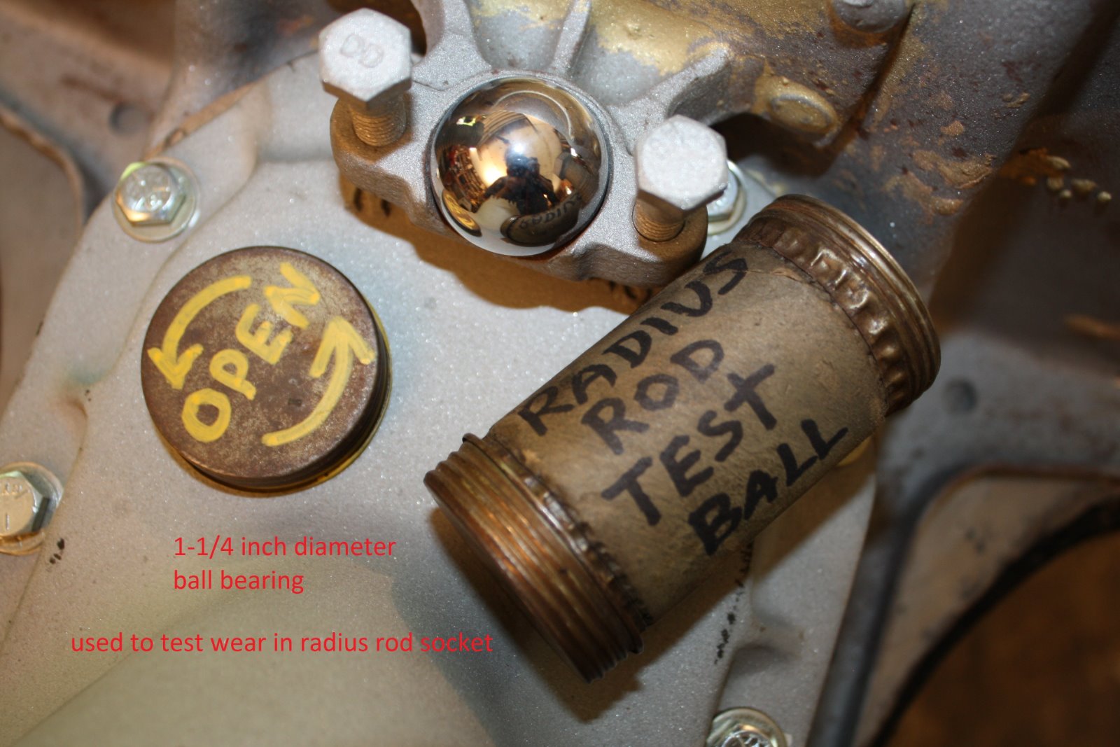

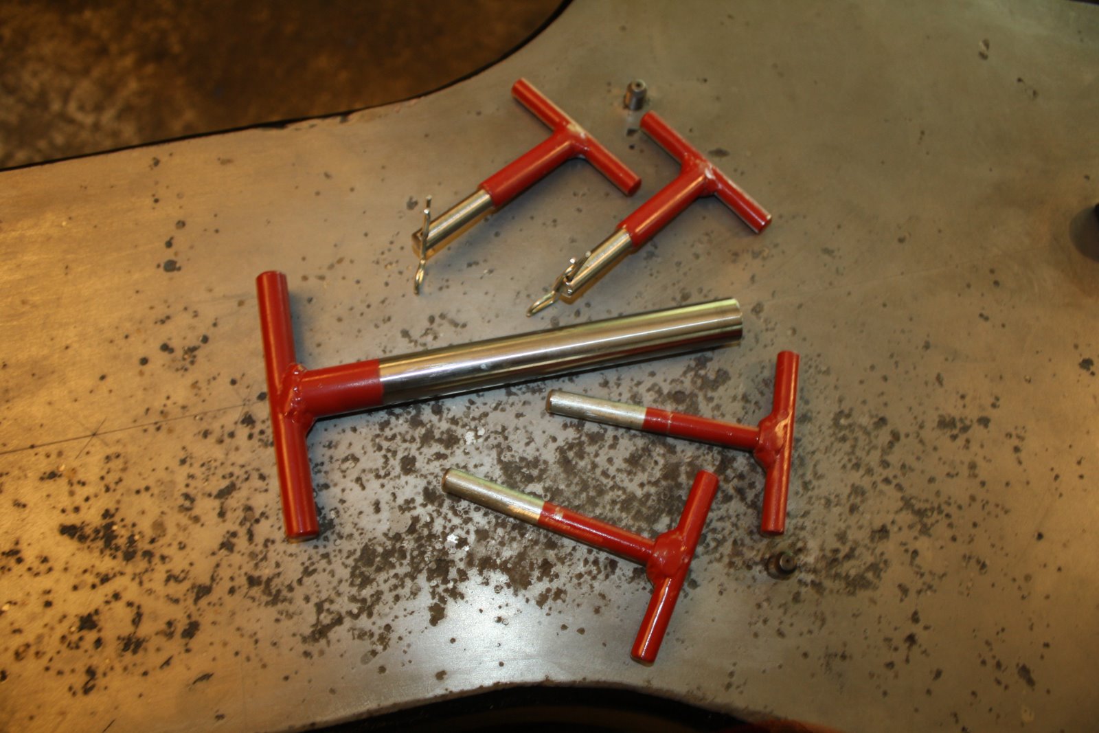

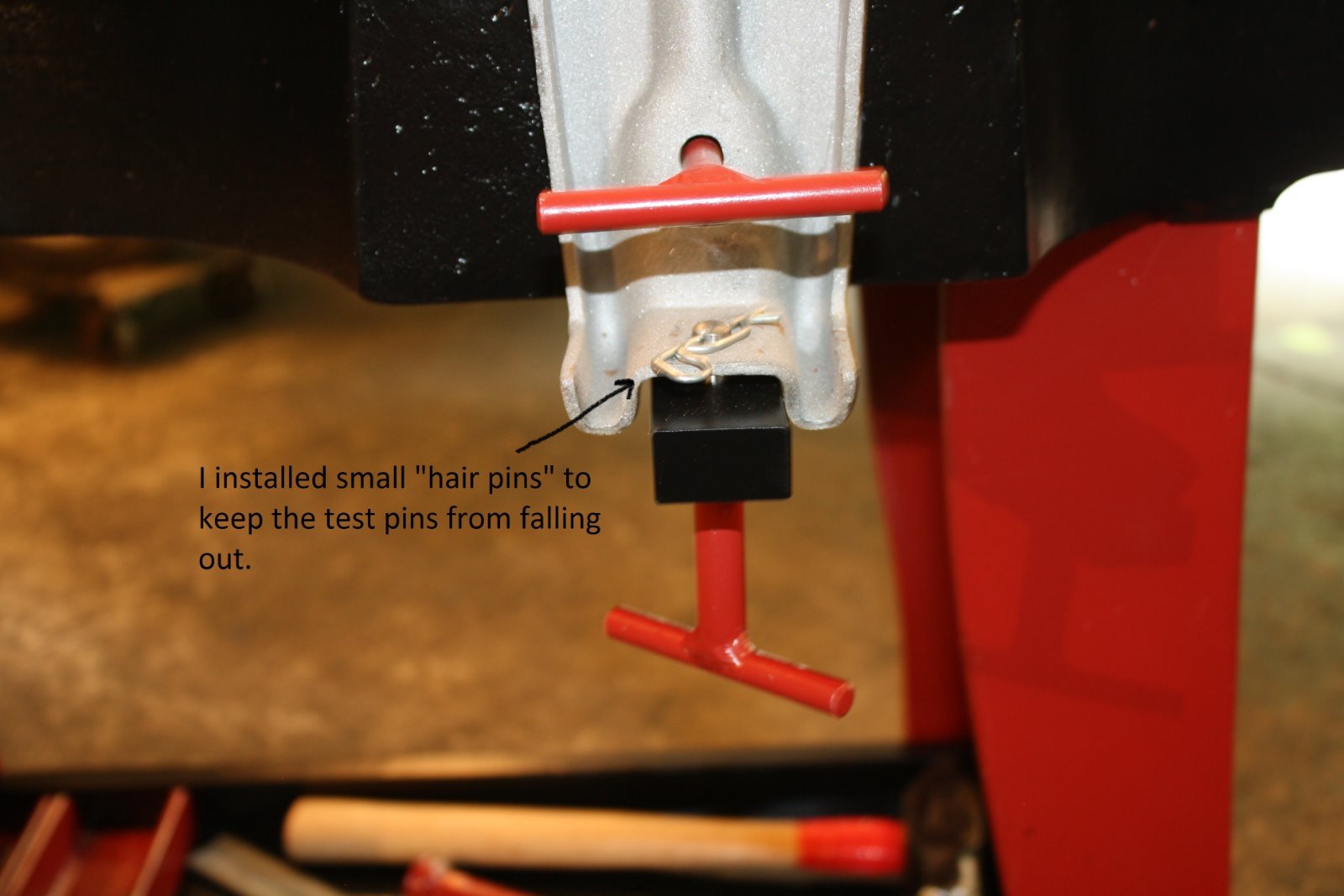

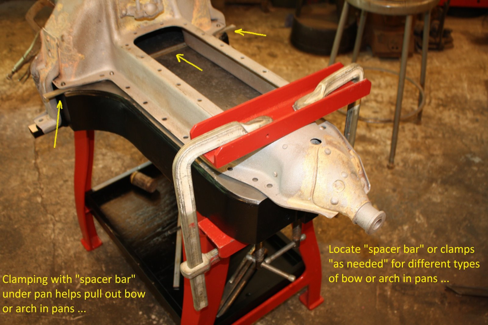

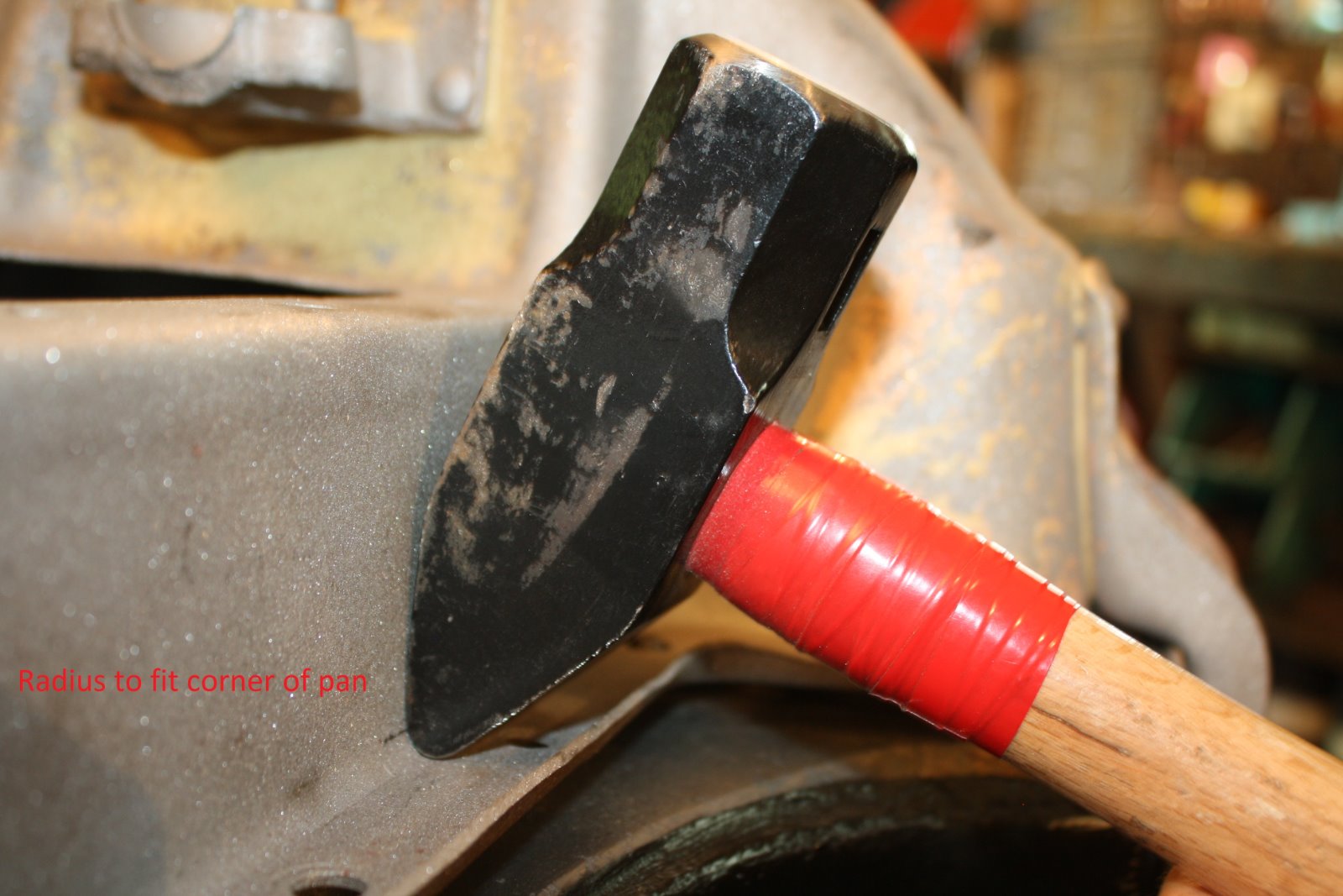

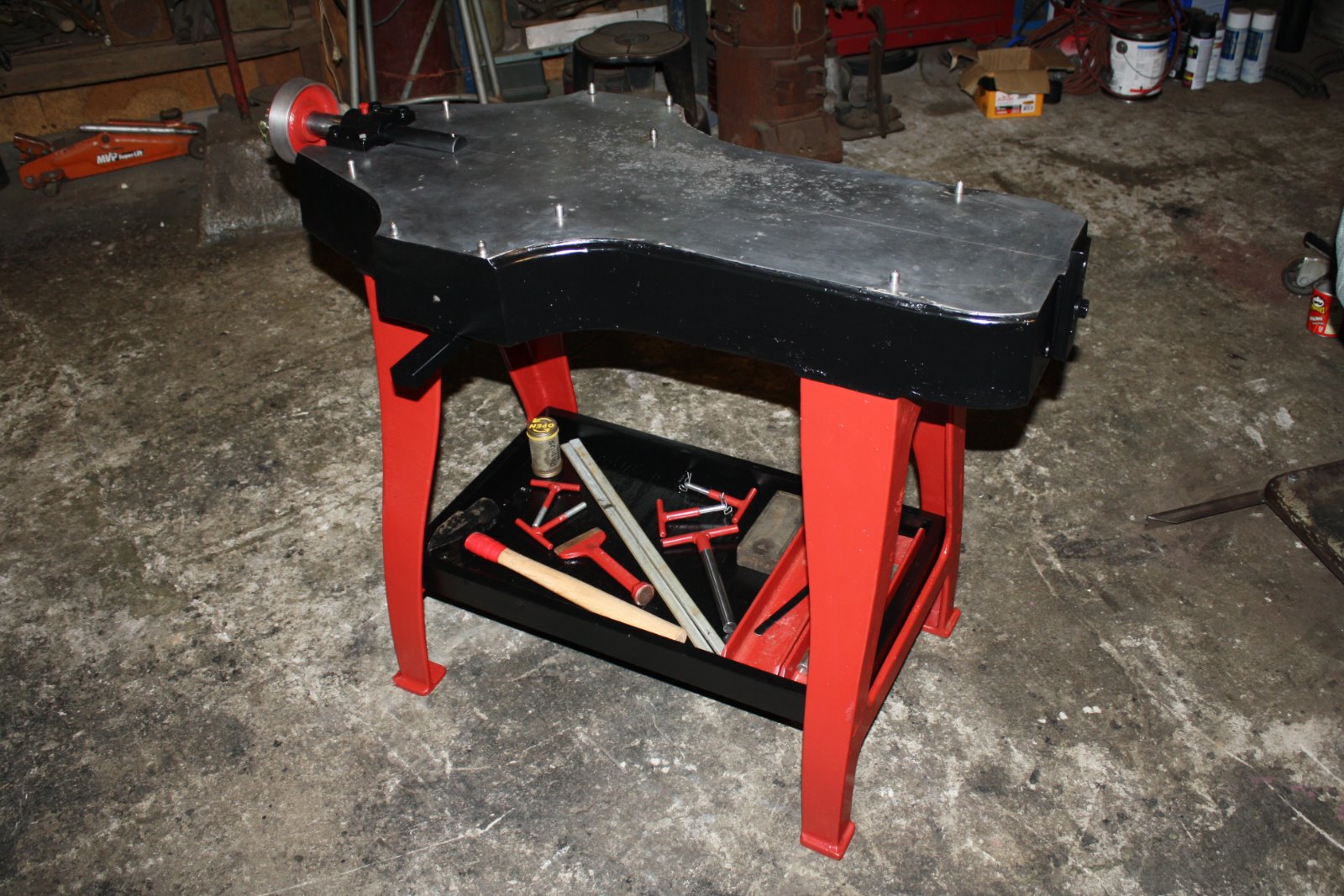

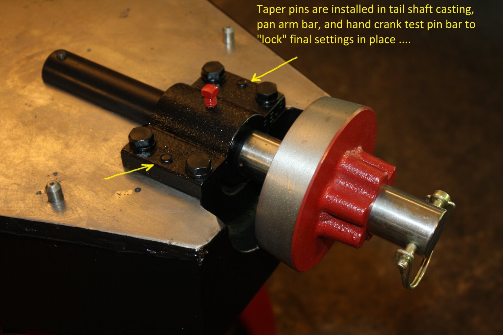

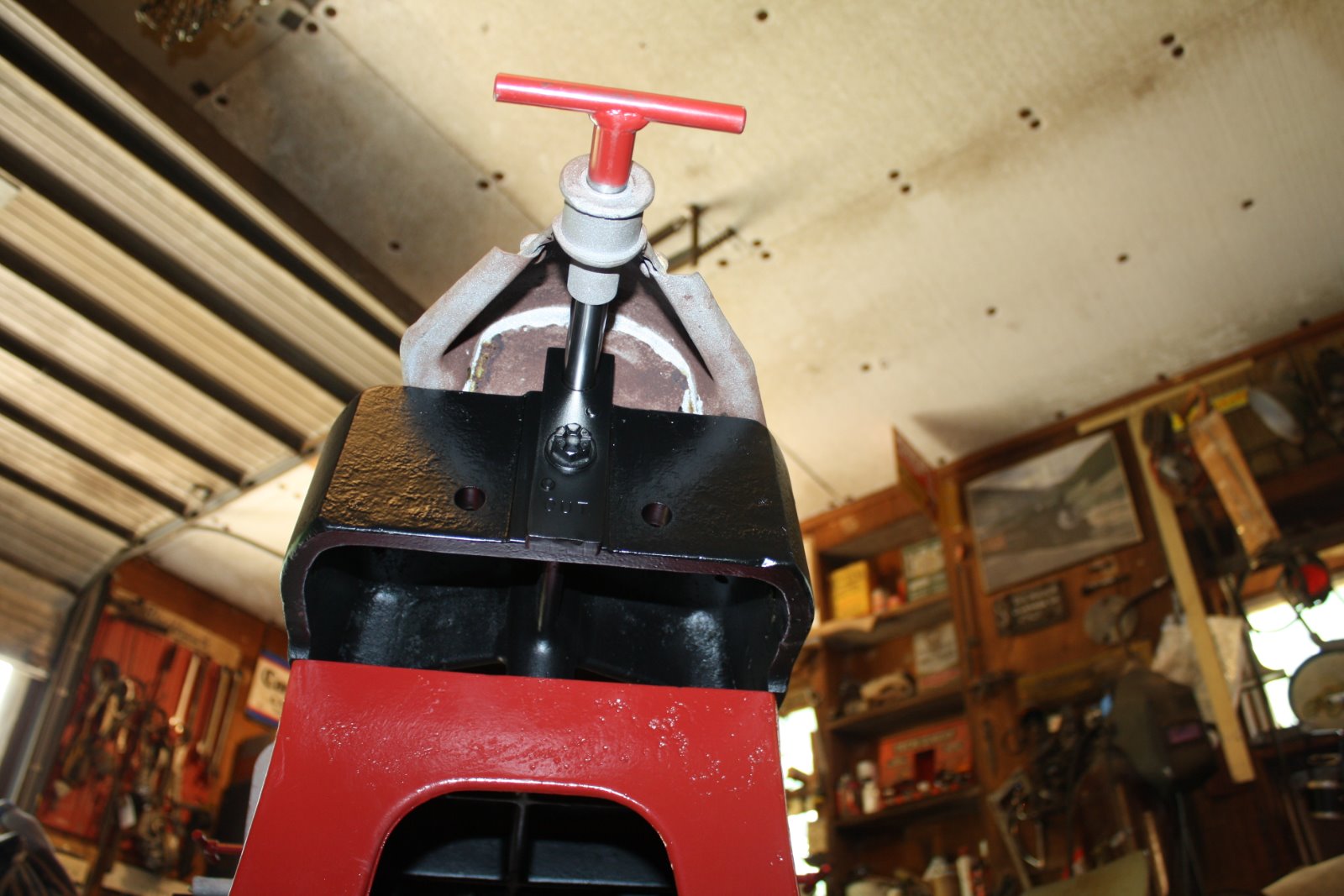

I have been working the last several months restoring a KR Wilson pan jig. I want to say thanks to Bill Howell for the gift of the pan jig. It is very much appreciated. It was in rough shape, but I ended up with something better than the homemade one I had started to build. This pan jig was missing all the attachments and had a very hard life as a work table/anvil/welding table. It had aprox a .070 thousand twist to the top as well as a low place from years of beating and use as a welding table. The Blanchard grinders were able to install shims and re-mill the bottom side of the table so that when they ground the top side, aprox .035 to .040 was removed from opposite corners and not the entire .070 from just one corner. I only removed as little as possible to give a flat surface with no twist and a smooth surface where the lip of the pan sits. The pits that I left, in no way affect the use of the jig and left more of the "hard surface" thickness in place.

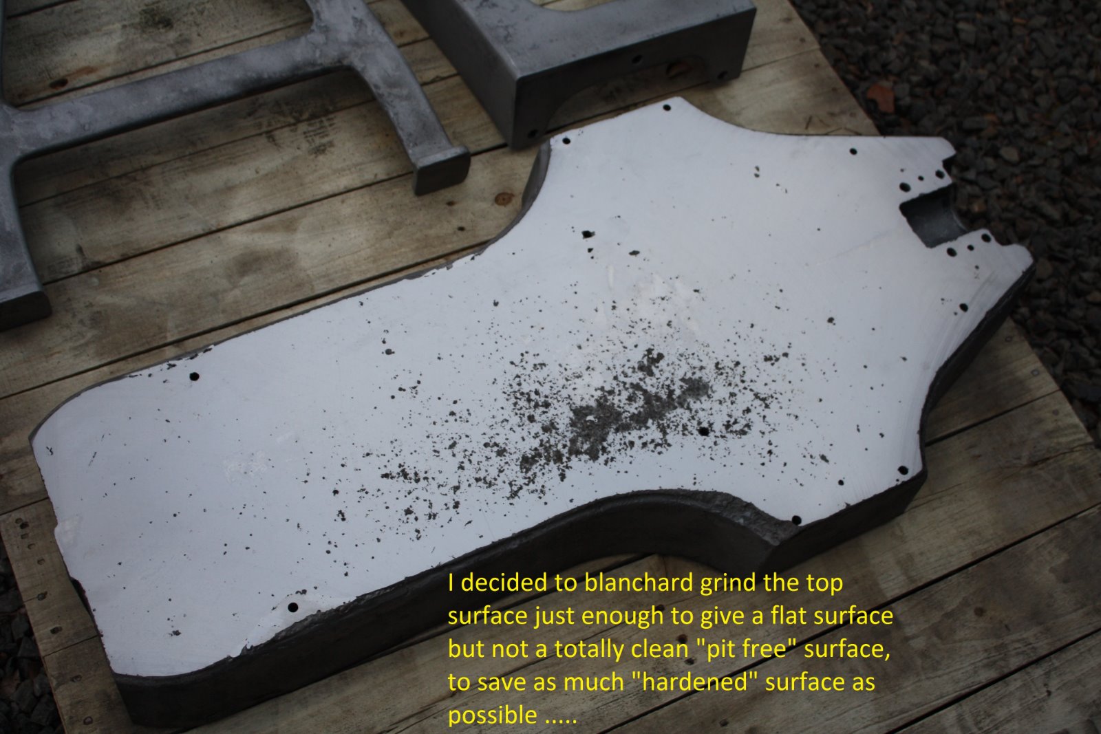

Some folks wonder why these jigs cost so much, Even with getting the pan jig as a gift from Bill, I still have almost 1000.00 in the restoration not counting anything for my time. But we now have another pan jig in Arkansas for model T folks to use. This jig is offered to use for free, by any model T guy who wants to bring their pan here to straighten. Ill watch, and you do the work. .... :).

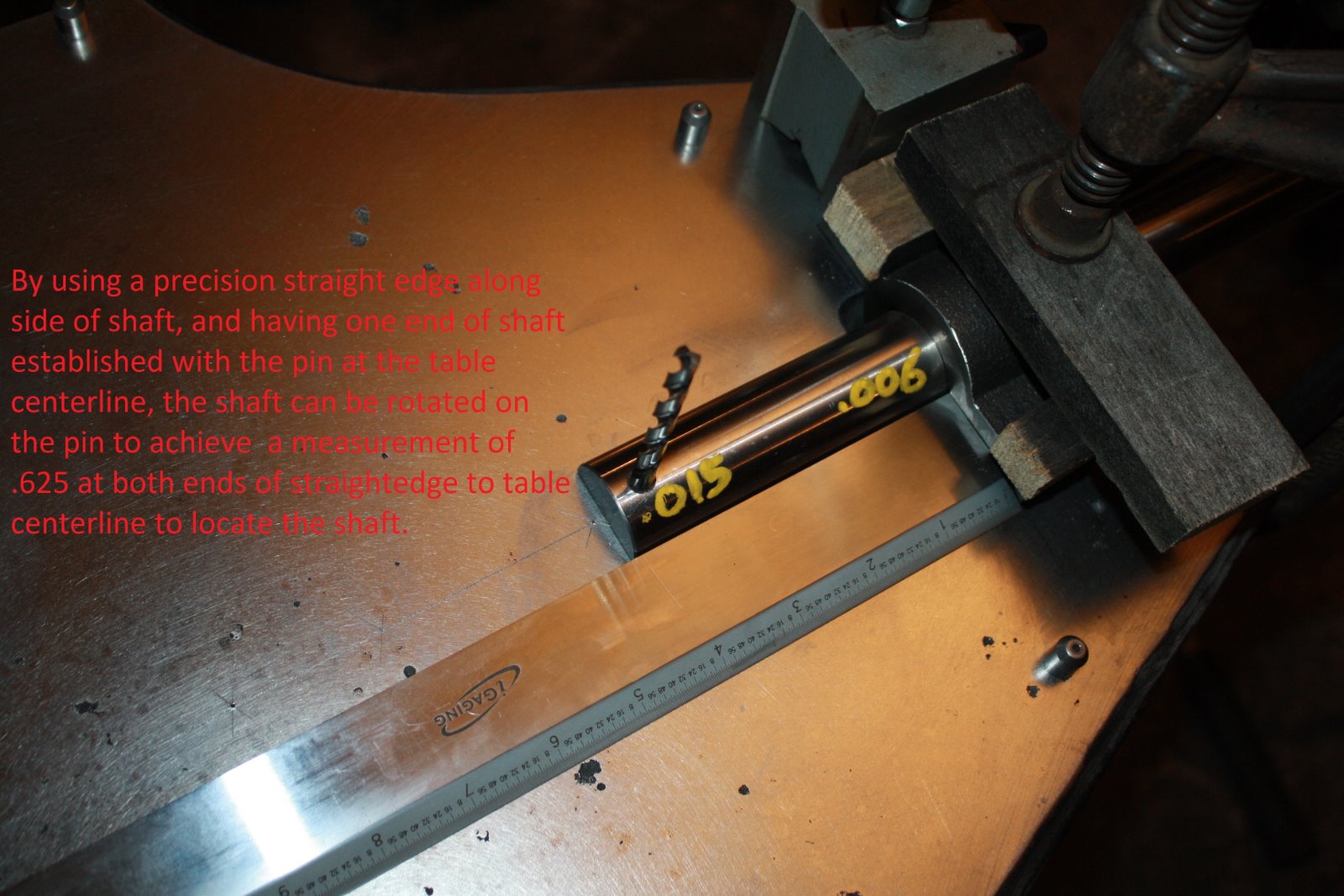

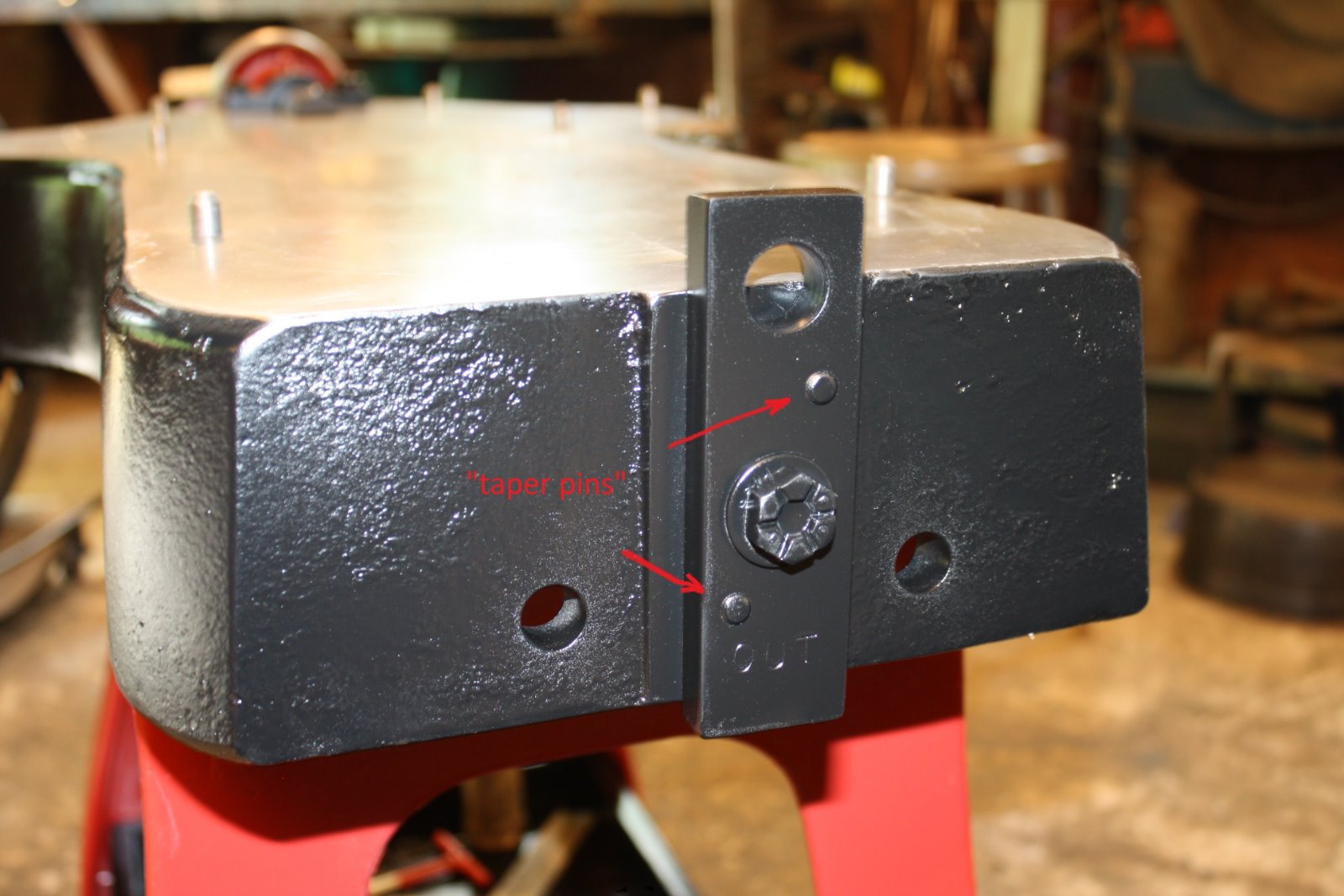

After I installed the "fixtures" but before I installed the "taper pins" to lock the fixtures final settings. I straightened my pan that Im using on the "speedster project" Then to "test" my layout, machining, and calibration of the fixtures, I took my freshly straightened pan to Bills shop and tested it on his two pan jigs. My pan fit all three pan jigs. The test was a good test of all three pan jigs, If all three fit OK then they must be OK. ...

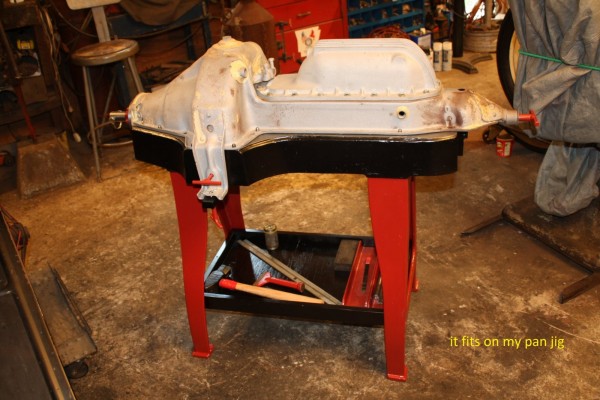

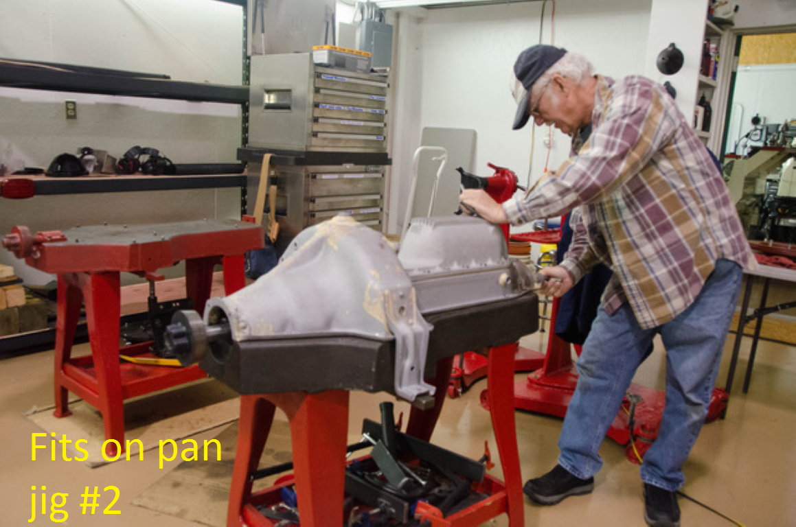

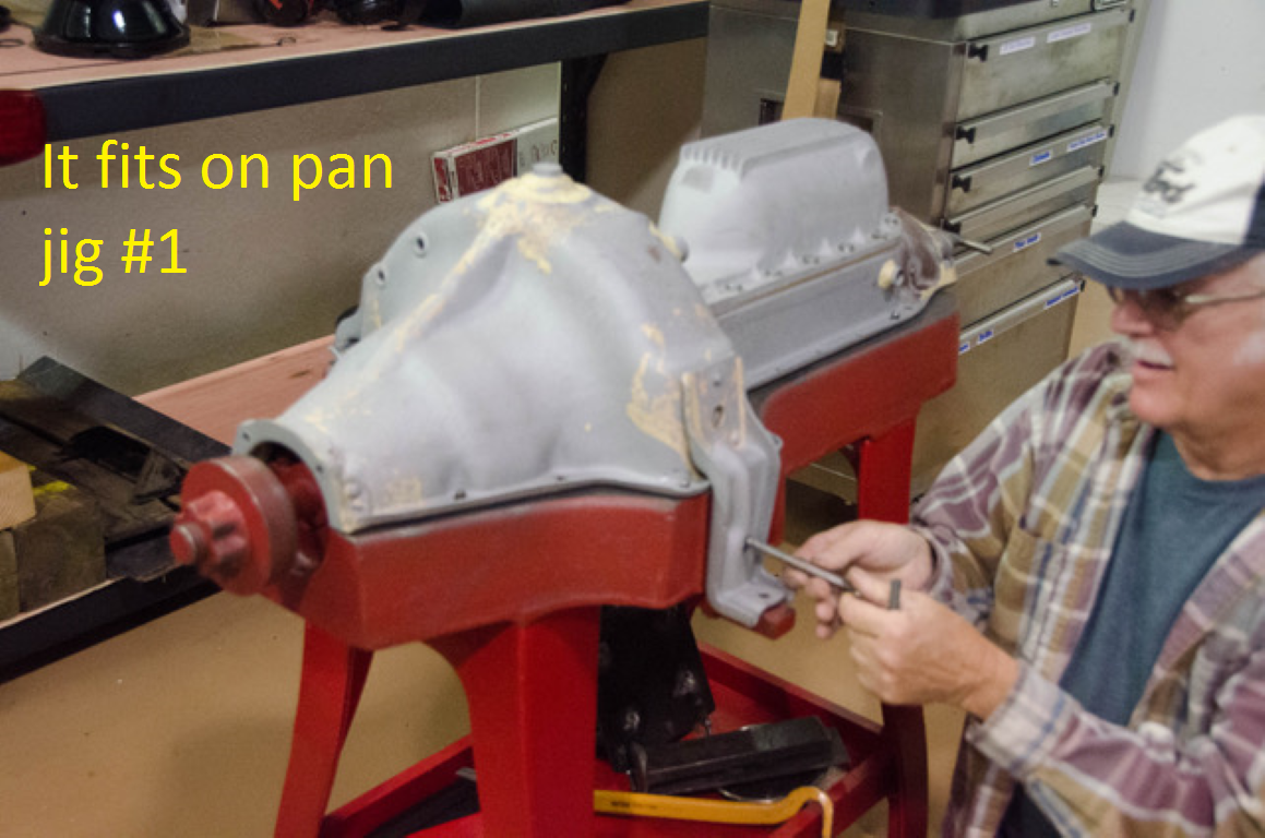

For the final test of my pan, I installed the "Sherman" deep sump pan on my pan, just to make sure everything stayed OK. All is good so now back to the engine build and finally get the speedster project finished.
Here are some random pics of the pan jig restoration ...

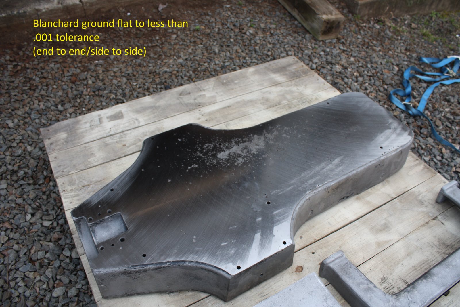

Thanks for the comments. The Blanchard grinder had a capacity of 96 inches long with an accuracy of .001 in 96 inches. The pan jig is about 36 inches long. So my top surface should be within less than a 1/2 thou. tolerance.
I plan on building a table top/cover to place on top of the pan jig. That way I can use it as a work surface for other things. I have a small shop, so space is at a premium. Things need to have a dual use.
I have wanted a pan jig for years, It really makes fixing the pans a much easier job. They are one of the hardest T tools to find. The transmission drum reaming fixture is probably the only thing harder to find. So now I'm looking for a drum reaming fixture. :) :)

Just a point of information for those working on a pan jig . The pins on the original jig are THREADED and are screwed into the jig. They are not loose pins driven or dropped into a hole on the jig. FYI
Jack
Thanks for info. After a little research I have done, your the first to mention threaded in locator pins. Being in the machine & welding field for 38 yrs. This makes much more sence to me ! Especially considering the stress them pins get as your sledge hammering that crankcase.

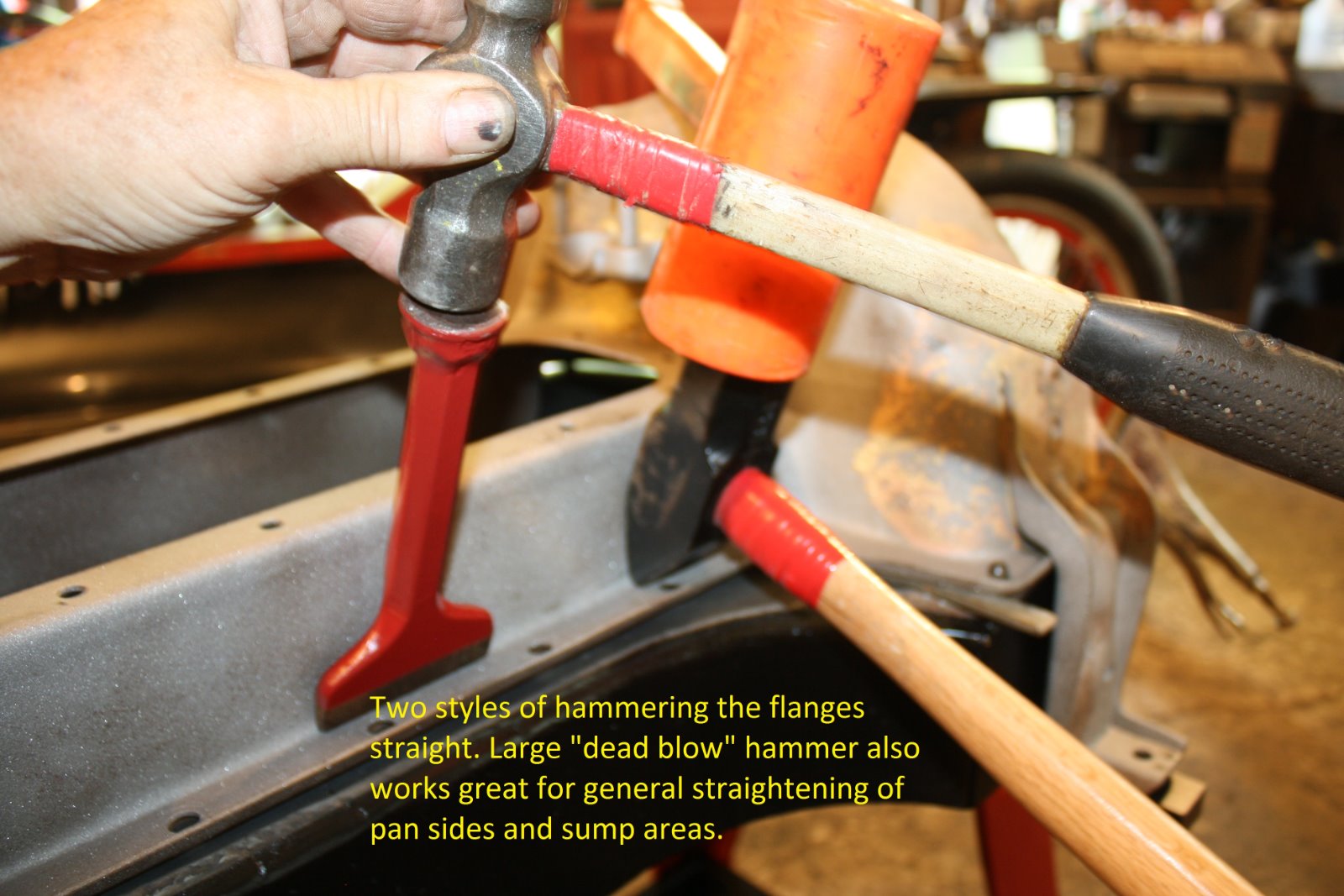

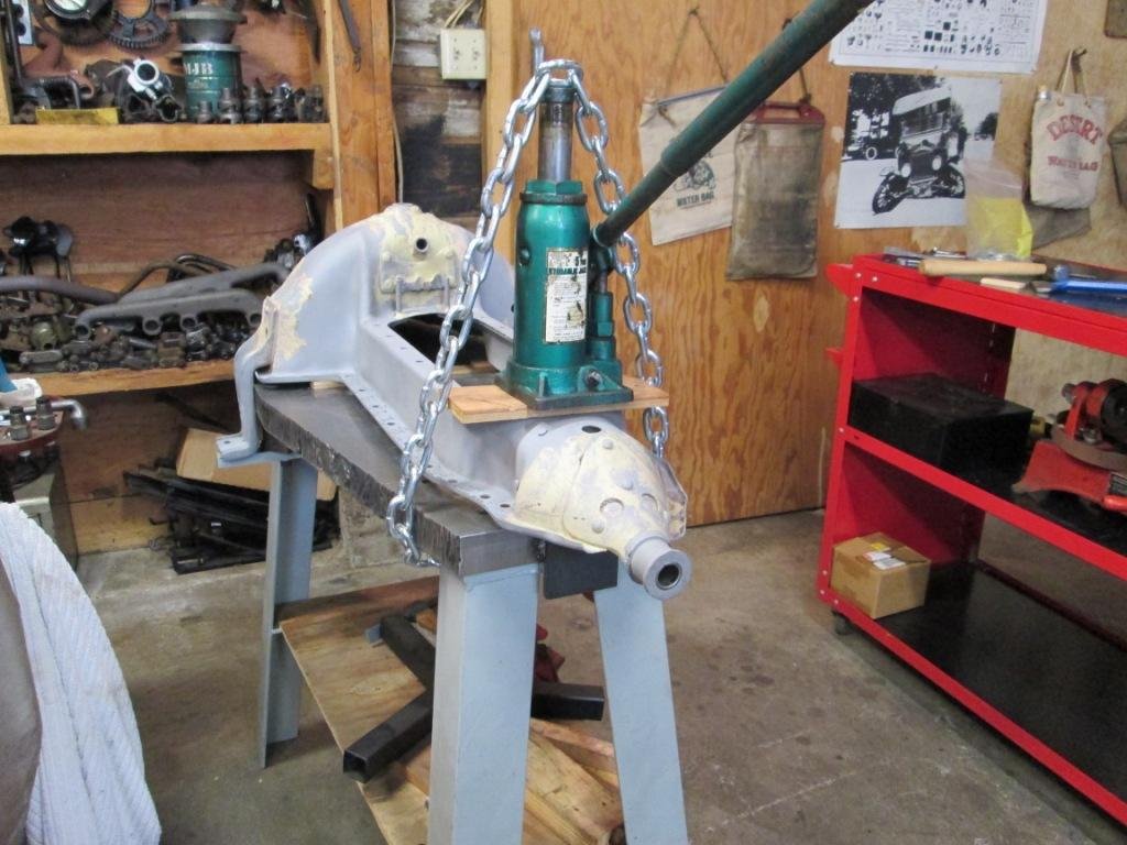

Ronald - you might consider putting the sledge hammer away - the only "hammering" that is required is getting the pan rail flat as Donnie explained above. PRESSURE & LEVERAGE are your friends when attempting to straighten the Ford crankcase. I use blocks in strategic areas with a chain & bottle neck jack - been straightening pans for a number years. My jig is custom made with all critical measurements coming off the late Herman Khonke's KRW jig.

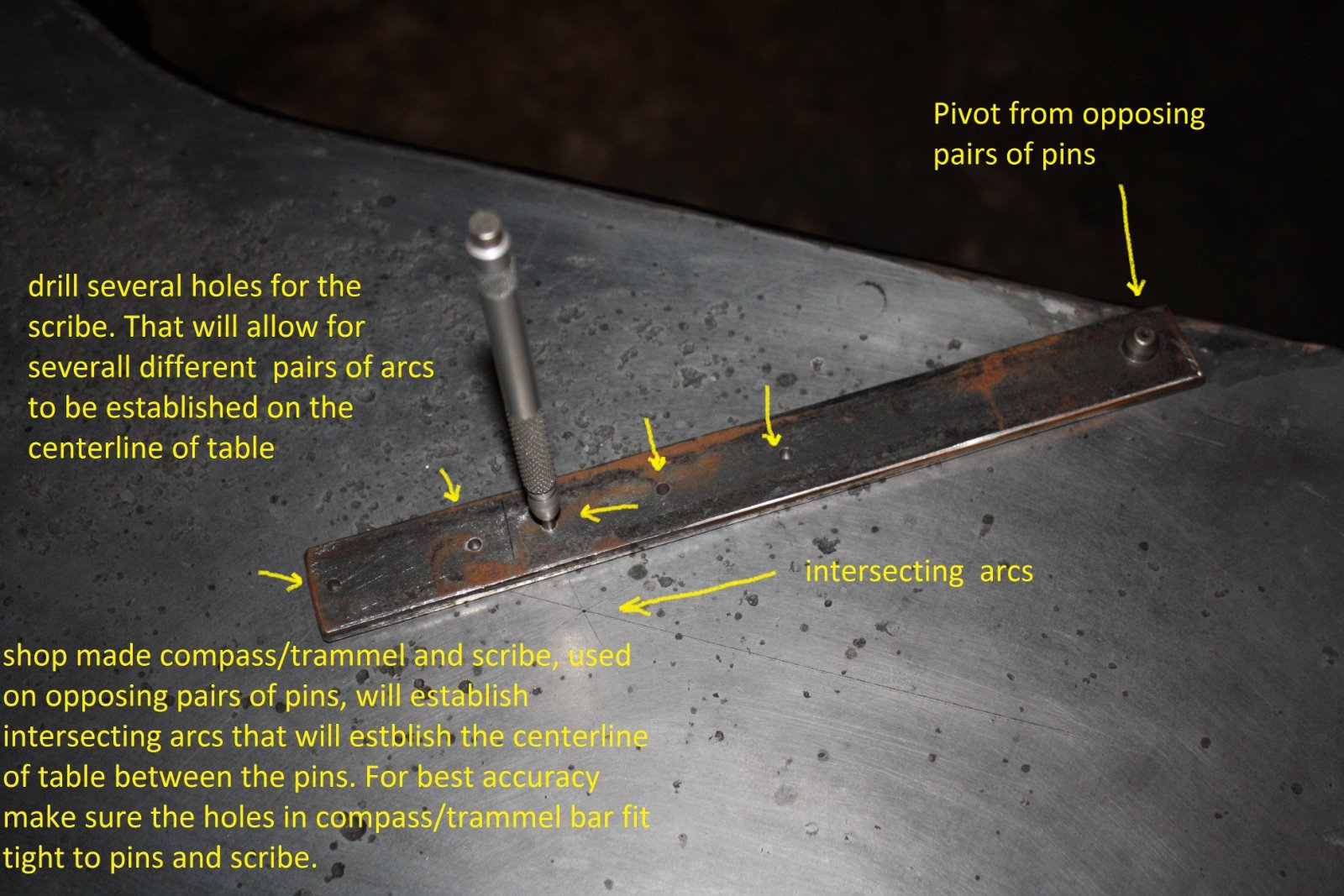

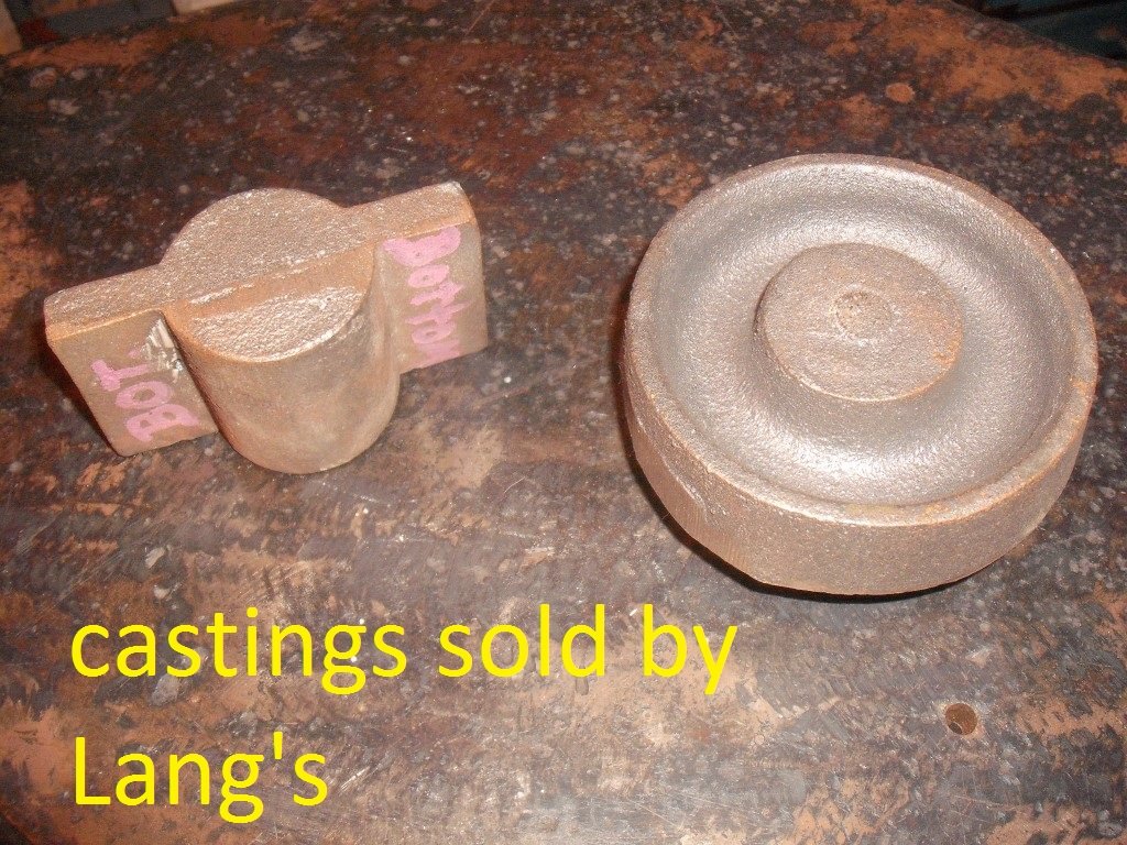

A real good layout jig for the holes at the rear is to just use a cast iron non starter hogs head. It is a perfect layout tool or even a drill jig. Then use a 26-27 hogs head and block to help locate the front holes. By using the above parts and some good layout techniques, you can get a accurate layout of the holes.
Now about welding. Welding is a pain in the @SS. The top approx 1/4 to 3/8 is a very hard surface just like a blacksmith anvil. The main body of the casting is a softer cast iron. It usually is a very high sulfur casting. It will take two different special rods to weld it. I can explain the welding procedures you will need to do to make sure the welds are good. Rods should still be available at Tractor Supply.
The castings for the cone and the casting for the cone shaft to fit into is available thru Lang's. I have heard they may be partialy machined now, instead of just raw castings like I used.
I also have a list of all the parts and materials I bought from McMaster Carr to use on my jig.
