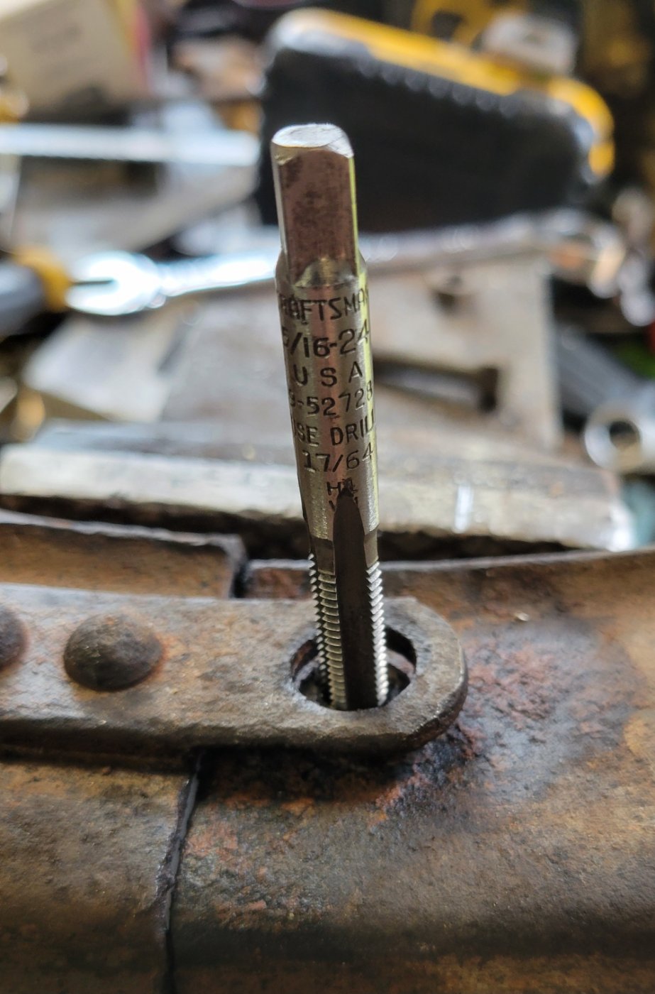

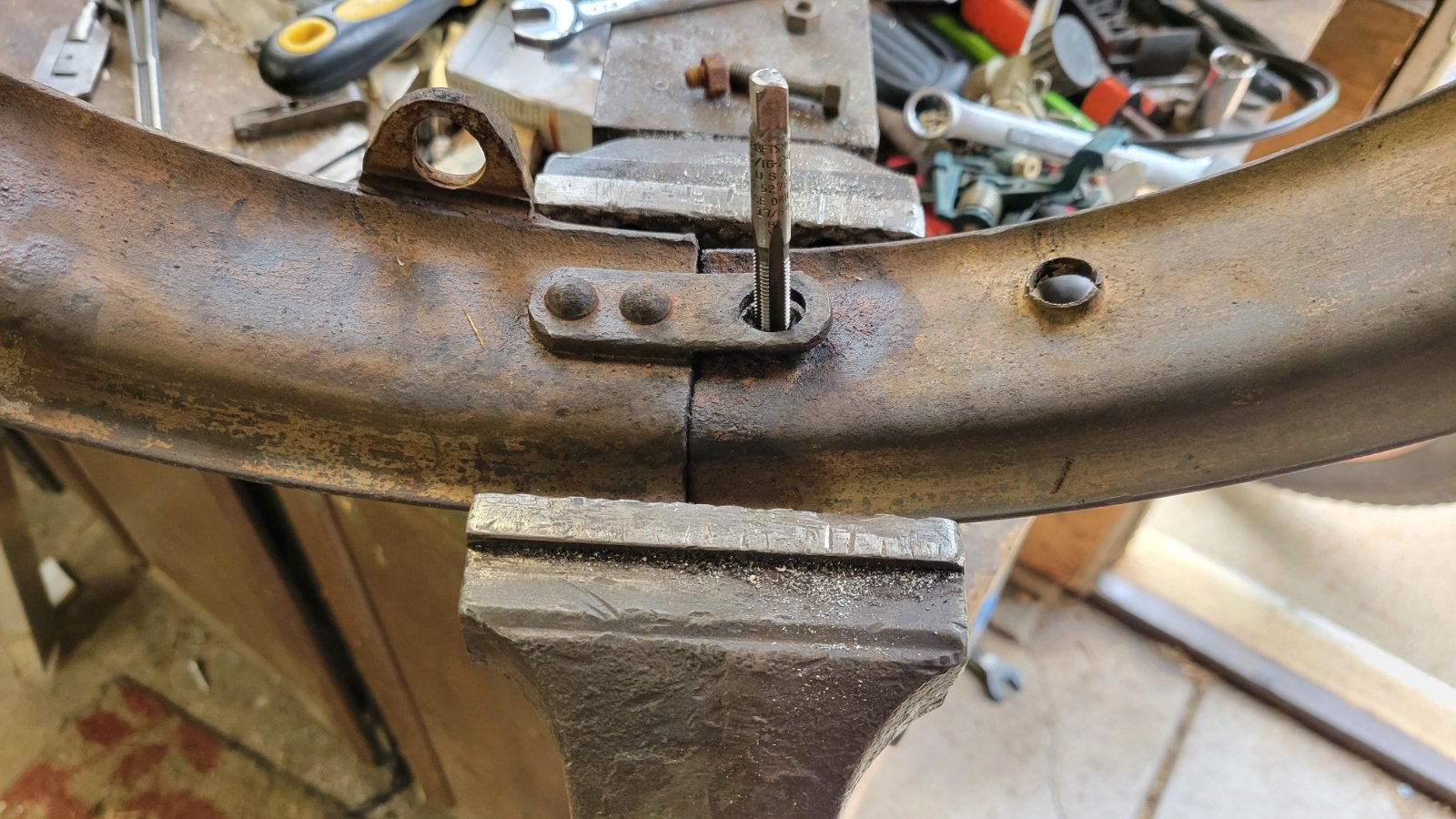

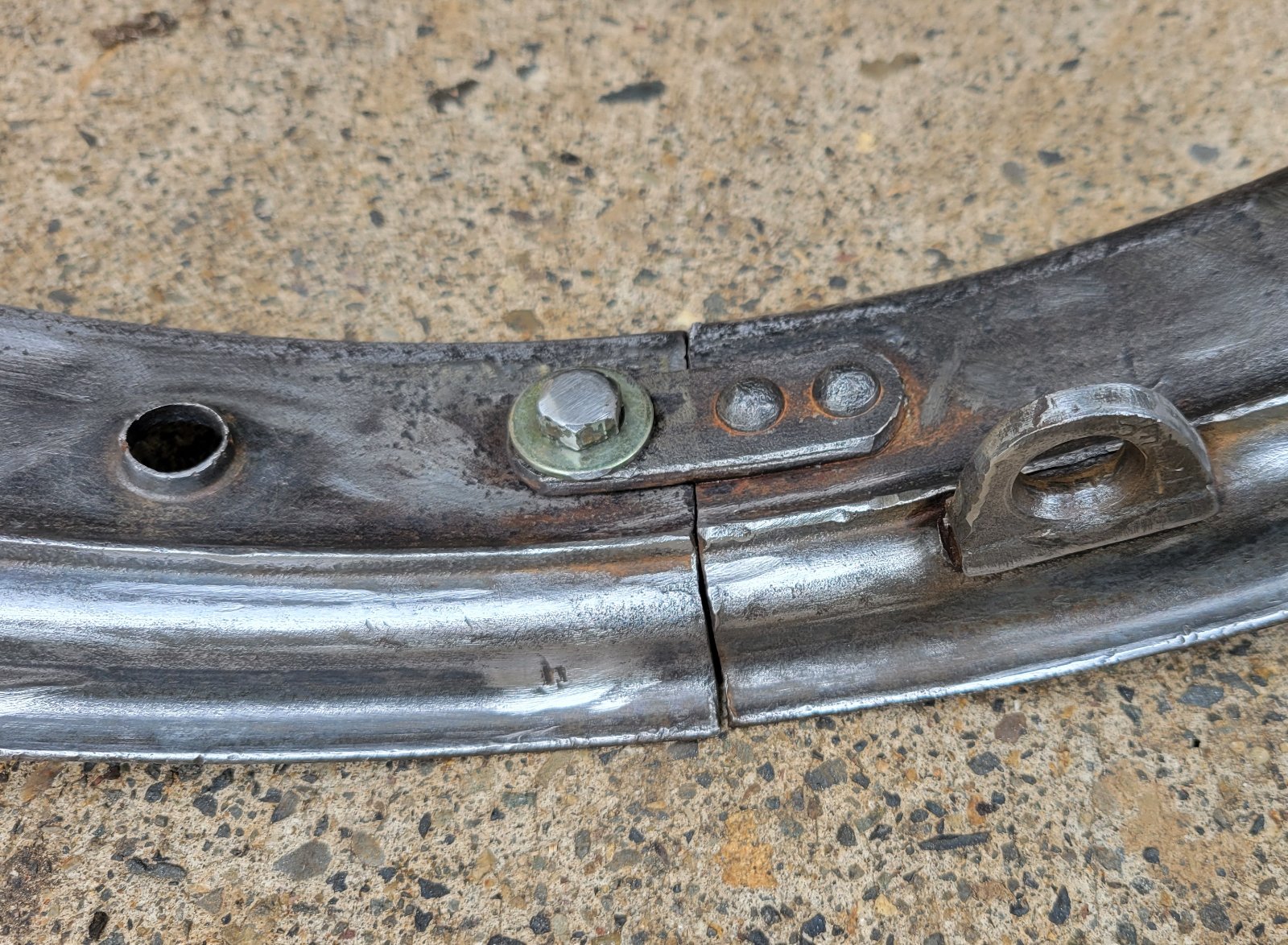

This rim is missing the latch bolt. It looks to be a 5/16" x 24 tpi thread. Does it just use a short bolt and washer?

Just a sloted round head screw.
Posts: 1502
First Name: Keith
Last Name: Townsend
Location: Gresham, Orygun
Re: 21" split rim latch bolt?
Post by KWTownsend » Thu Jun 27, 2024 4:23 pm

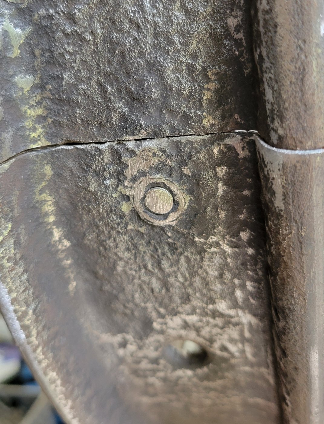

Then just flush on the under side?
Posts: 5485
Post by RajoRacer » Thu Jun 27, 2024 4:45 pm
I might add to Jeff's description - it's a rather LARGE round head slotted screw - no washer needed !
Posts: 1502
First Name: Keith
Last Name: Townsend
Post by KWTownsend » Thu Jun 27, 2024 5:00 pm
Satisfactory for git 'er done?
