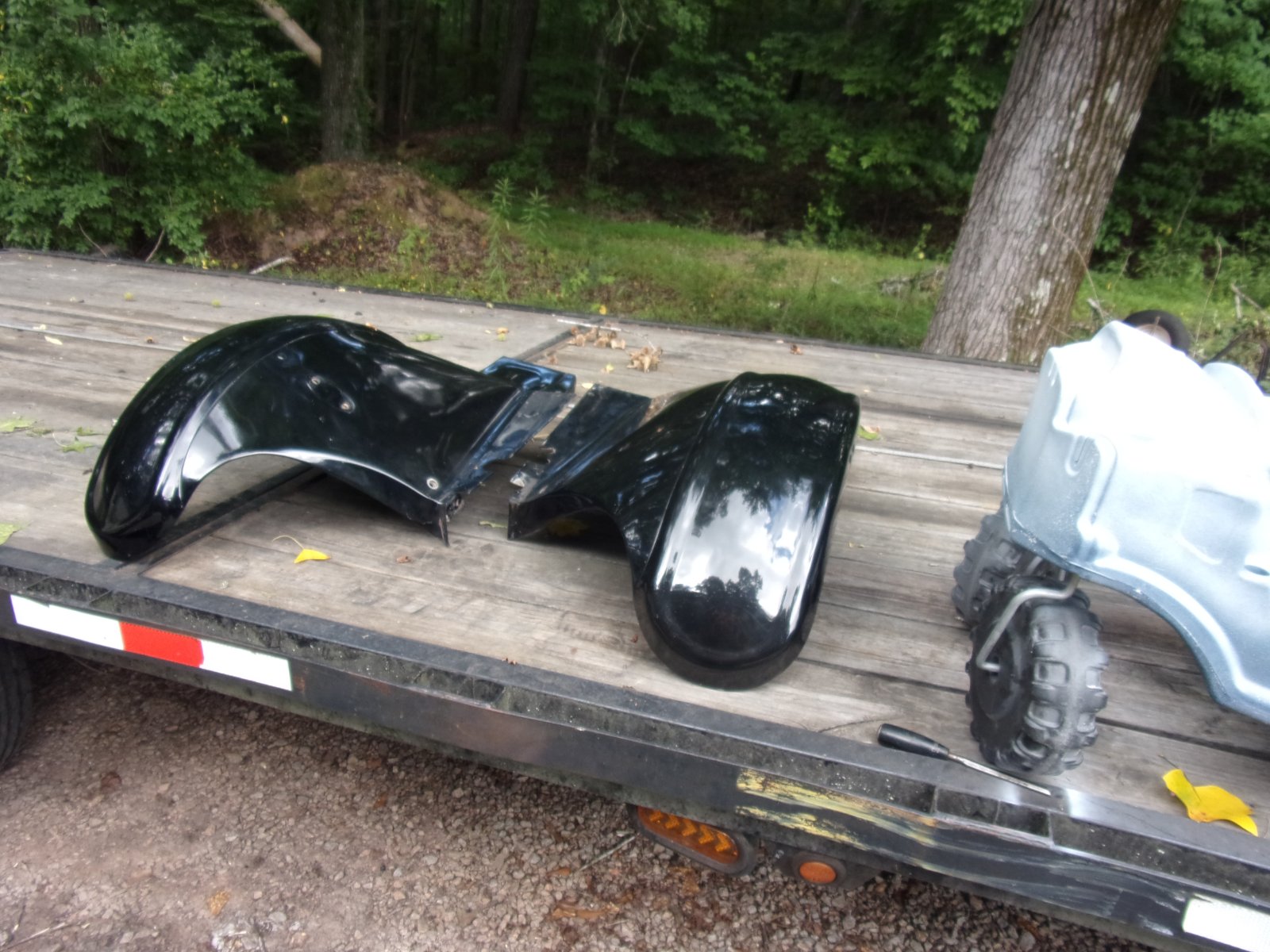

Since I'm working on my "new to me" front fenders, I noticed the PO had used the same black paint on the top and bottom of the fenders, but the top surface was extremely high gloss while the bottom on the fenders was flat and pitted. Presume clear coat on the exterior. But, I'm scuffing everything up and doing some minor body work prior to painting with lusterless OD green for my WWI ambulance project. So, was wondering if anyone used the rattle can bed liner or undercoating sprays on the bottom of fenders or running boards to protect them from dirt and moisture collecting in the nooks and crannies?

No, nobody does that on a model T.
- Posts: 7925
Re: Undercoat fenders?
Never seen it. I don't think it would give much protection at body joints Periodically flushing debris out of body joints and from around fender braces and other places that mud or dust can collect is a good idea. Any place in the body structure that can collect dust, mud, leaves, bugs, mouse droppings, etc. needs to be cleaned out periodically to prevent corrosion and wood decay. Spraying Fluid Film inside these areas and into the inside lower portion of doors can help prevent corrosion. Any Fluid Film that seeps out onto the exterior surfaces will collect dust, but otherwise will do no harm.

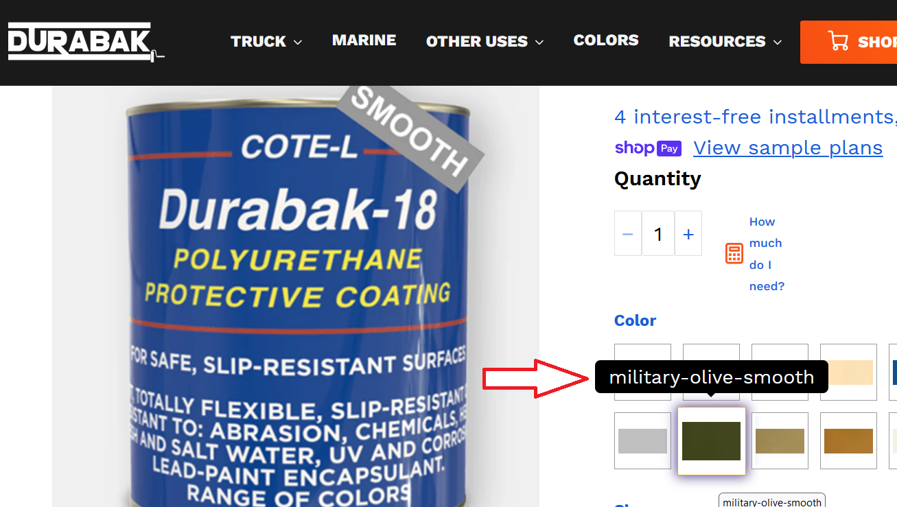

It makes sense to protect one's vehicle. When restoring a T many things are done to make it "correct" none of which Ford did. (paint for one thing). Since you will be paining the underside of your pitted WWI ambulance front fenders lusterless OD green who's to know whats under the paint, pits or bed liner. And if its smooth then .....
https://www.durabakcompany.com/products ... 1676475427

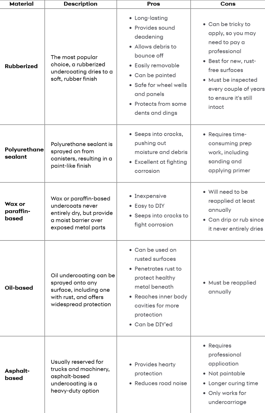

Genuine Ziebart Rust Protection and Undercoating is asphalt-based - ensures that the underside and all upper body panels of your vehicle remain rust-free. It's inspected and renewed once a year
Many possible materials used for undercoating https://www.synchrony.com/blog/automoti ... ating.html
