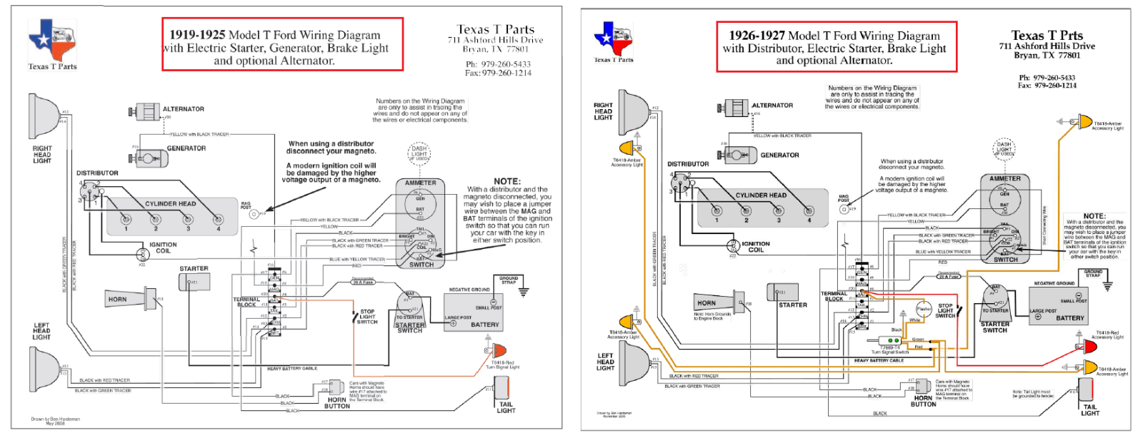

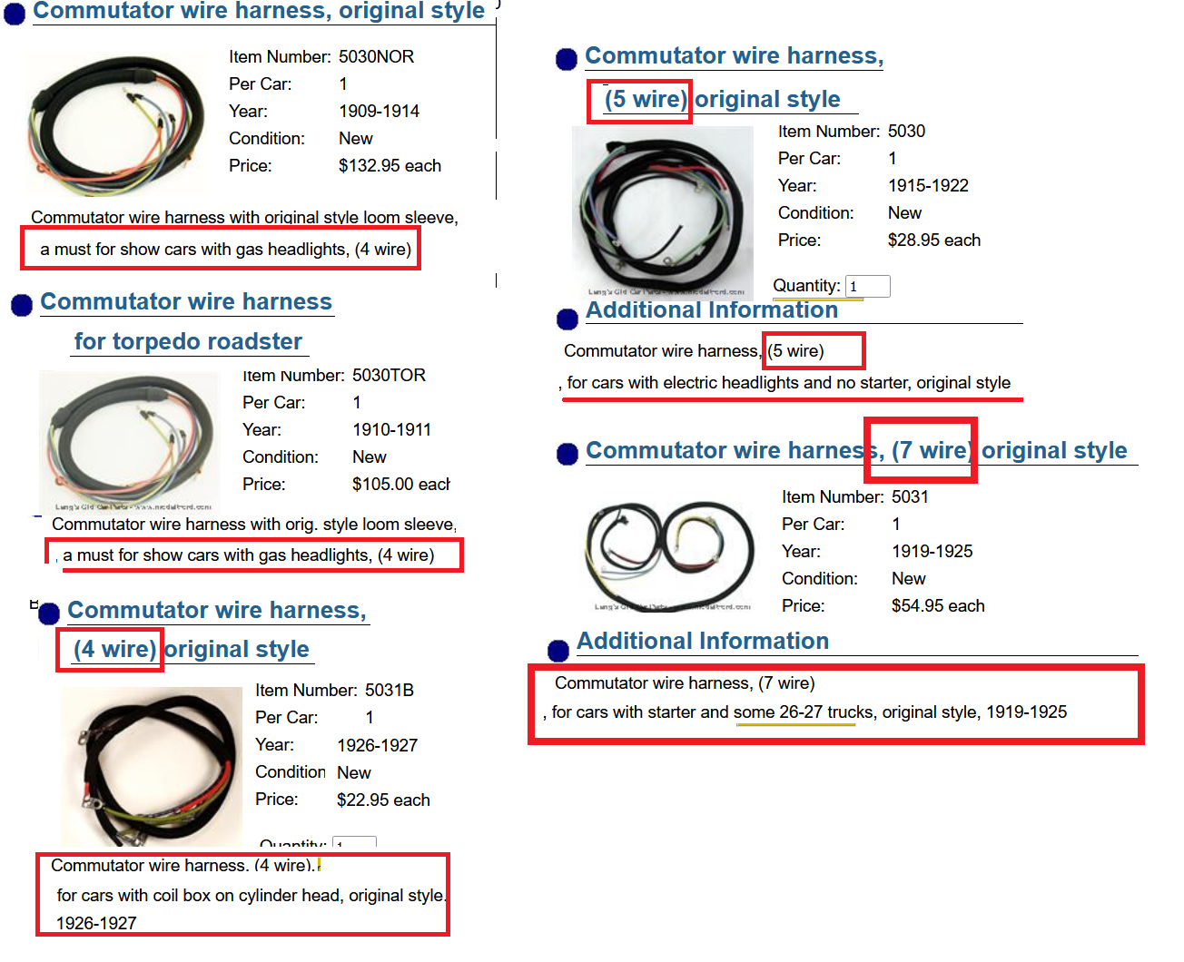

They are not all the same...

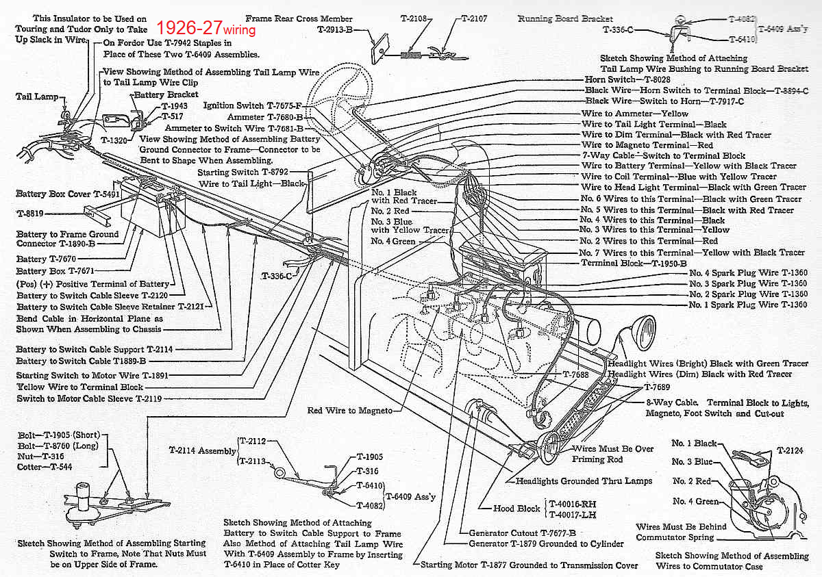

COMMUTATOR WIRES
The 4 wire likely are different in length
The 5 wire are for non starter cars
The 7 wire for starter cars up through 1925

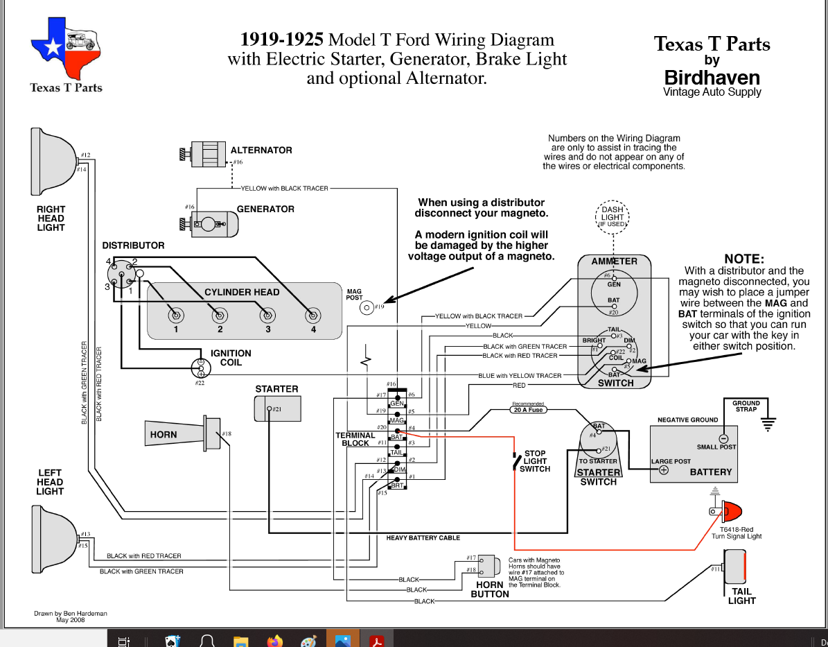

HEADLIGHT WIRING
Wiring diagrams are the best way to explain the differences. Magneto bulbs are wired in series while 2 contact filament & LED are wired in parallel.
Note that the single wire descriptions
Ultimately the electrical components dictate the wiring diagram
For example the wiring diagram for a distributor

Re: Model T Wiring: I Learned a Thing!
Post by Jerry VanOoteghem » Wed Jul 10, 2024 1:21 pm
Frank,
That is exactly the wiring diagram that I used. Useful as it is, it does not state what P/N harness does what.

Posts: 6540
Post by TRDxB2 » Thu Jul 11, 2024 1:03 am
Frank,

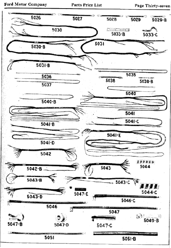

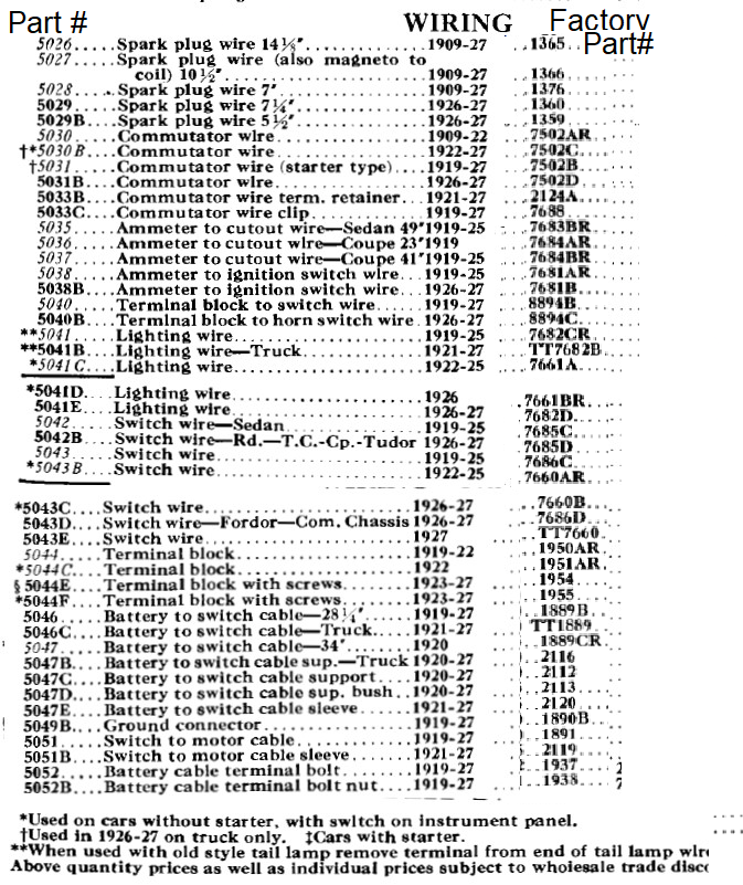

The supplier descriptions of a harnesses identifies its intended use. Wiring diagrams are somewhat generic just indicating connections & not wire length etc . For example: The two Texas T wiring diagrams (1922-25 & 1926-27) for the distributor are identical except for the addition of the tail light wiring.
However the harness for these years are routed differently. Thee diagrams reference the "factory part" number so you need to use the cross reference to match the order/supplier number. If you get confused looking at these diagrams don't worry, you wouldn't be the first. I don't guarantee their correctness.
The lighting harness' for 1919-25 & 1926-27 are routed differently. So you could use a 1926-27 lighting harness since you don't have a commutator
Cross reference

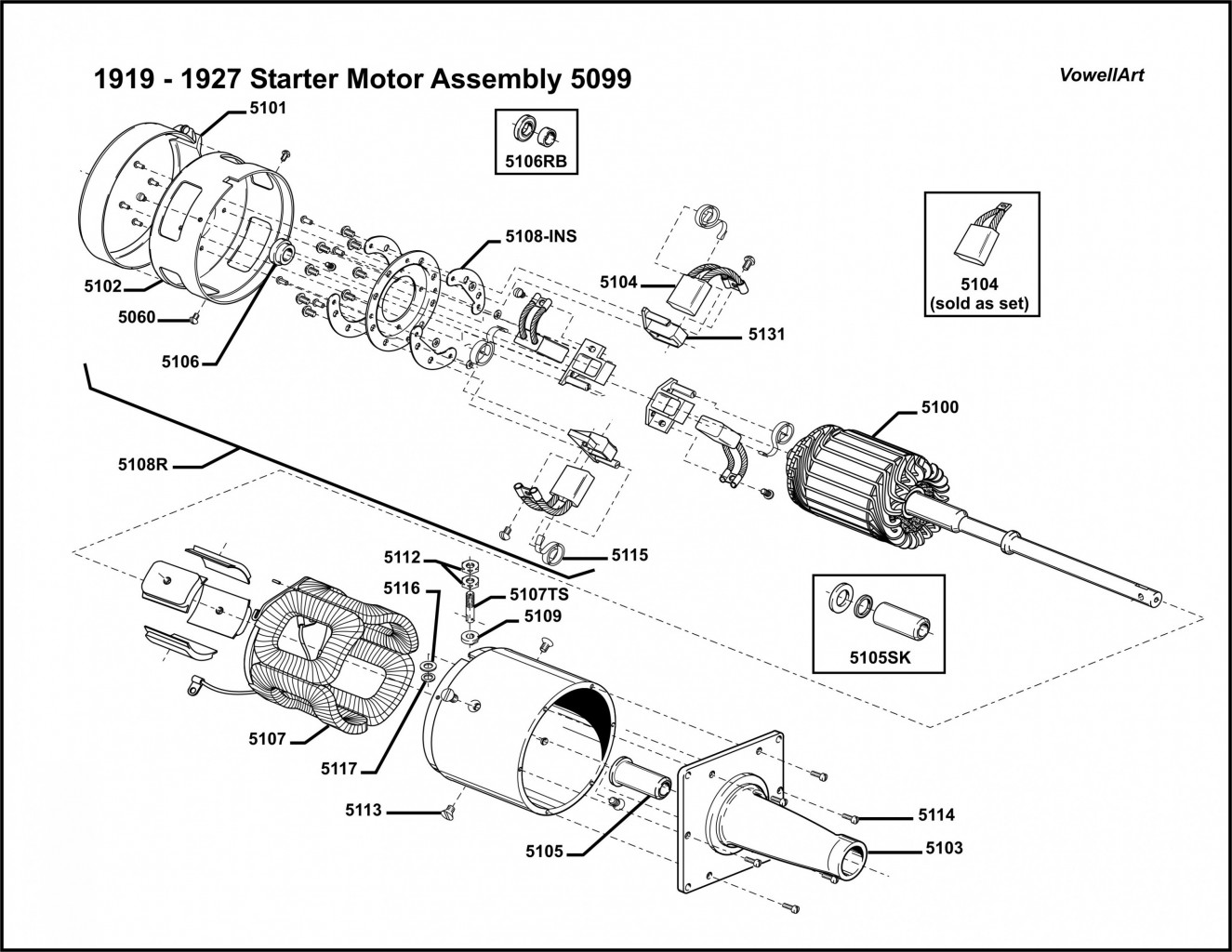

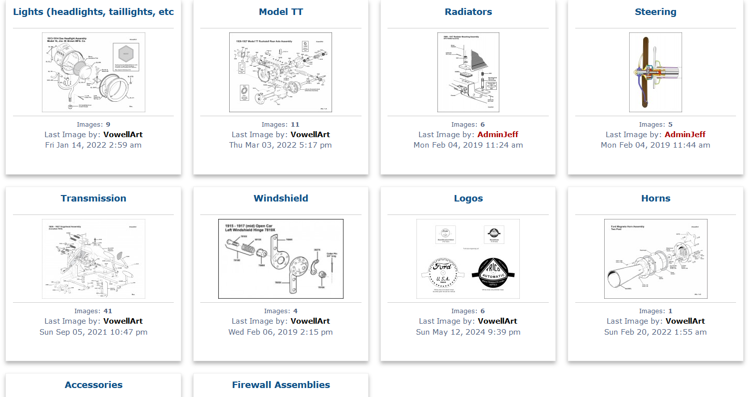

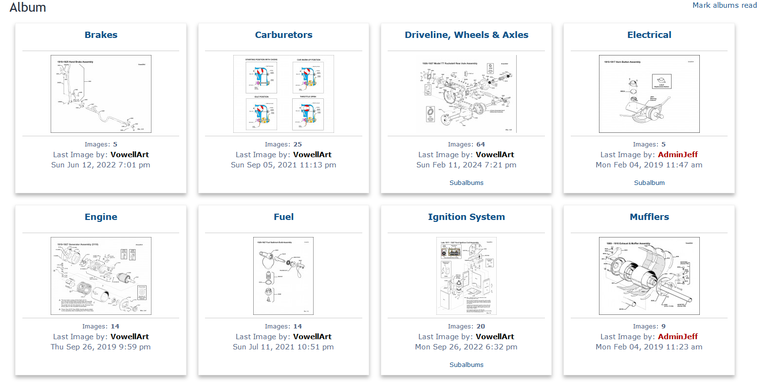

There are many line drawings available via the Forum site. This is a direct link app.php/gallery/album/11
Once on the site click on the title in on of the boxes to drill down to the desired diagram

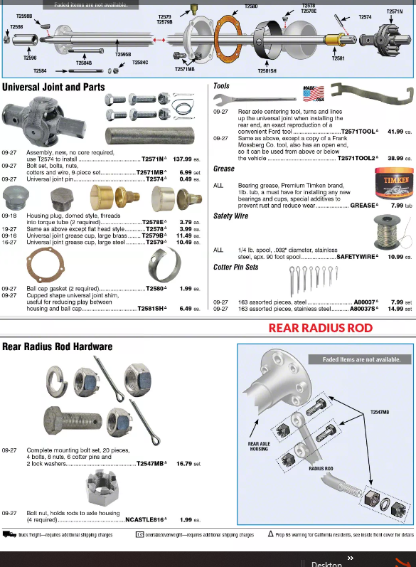

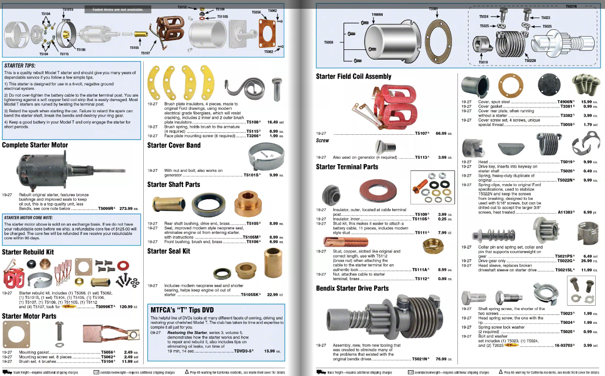

Then there's Ecklers catalog https://turn5.scene7.com/s7viewers/html ... /Model%20T
John Codman
