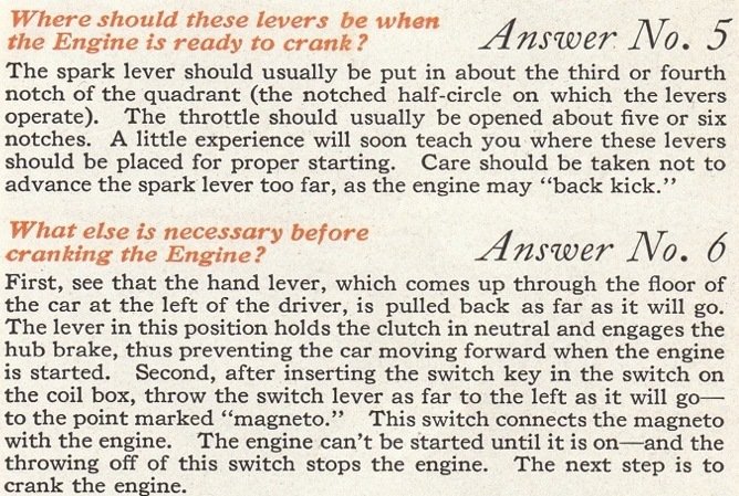

Jeff Humble is correct. Let me explain.
If you try to start the Model T engine with the spark lever fully retarded the first current pulse to the coils will occur at 26.5 degrees ATDC. By that time the piston is already on its way down the cylinder and much of the compression wil have disappated so the engine will be dificult to start. By advancing the spark lever 3-4 notches (which Ford recommended) the first spark will occur at 4 degrees ATDC making the engne easier to start and run.
When the Model T magneto was developed the magneto obvioulsy had to produce current pulses to the coils at time that would allow easy starting and
an adequate to spark advance for normal operation. The initial advance setting at 15.5 degrees ATDC provided for both situations AND provide with a modicum of protection for battery starting if a Model T owner added batteries to the pre 1919 cars ignition system. Ford never supplied ignition batteries from the factory.
Notice the recommended (magneto) spark lever starting position.
Over twenty years ago Steve Coniff and I co-wrote the following article for the Model T Times Magazine explaining all this in greater detail.
When reading, pay close attention to Figures 4 and 8 noting, the magnets are mounted on the flywheel advanced 7 degrees ATDC.
Hope this helps

Sorry about including the starting instructions twice.
