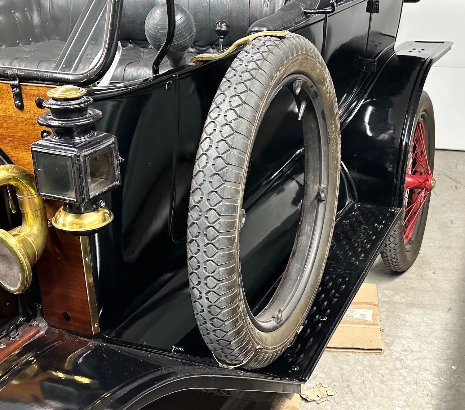

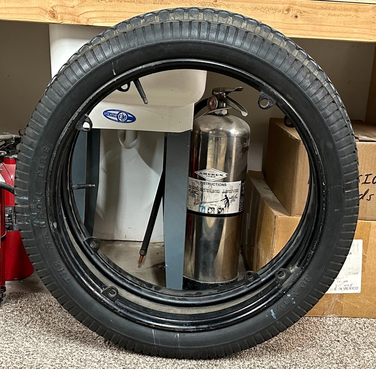

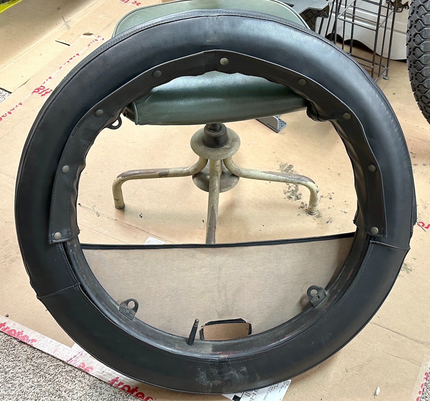

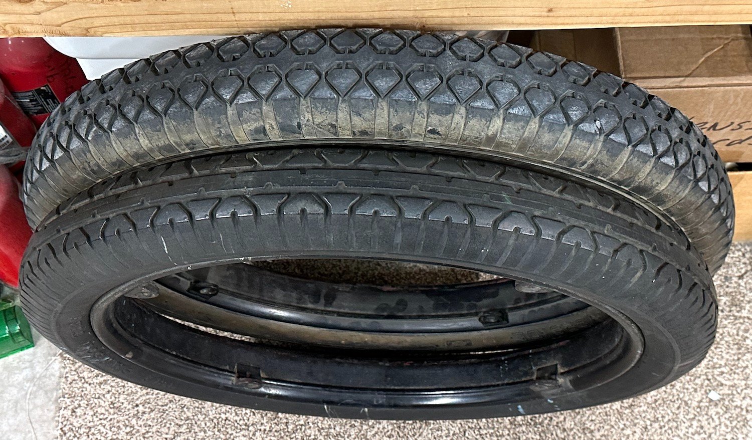

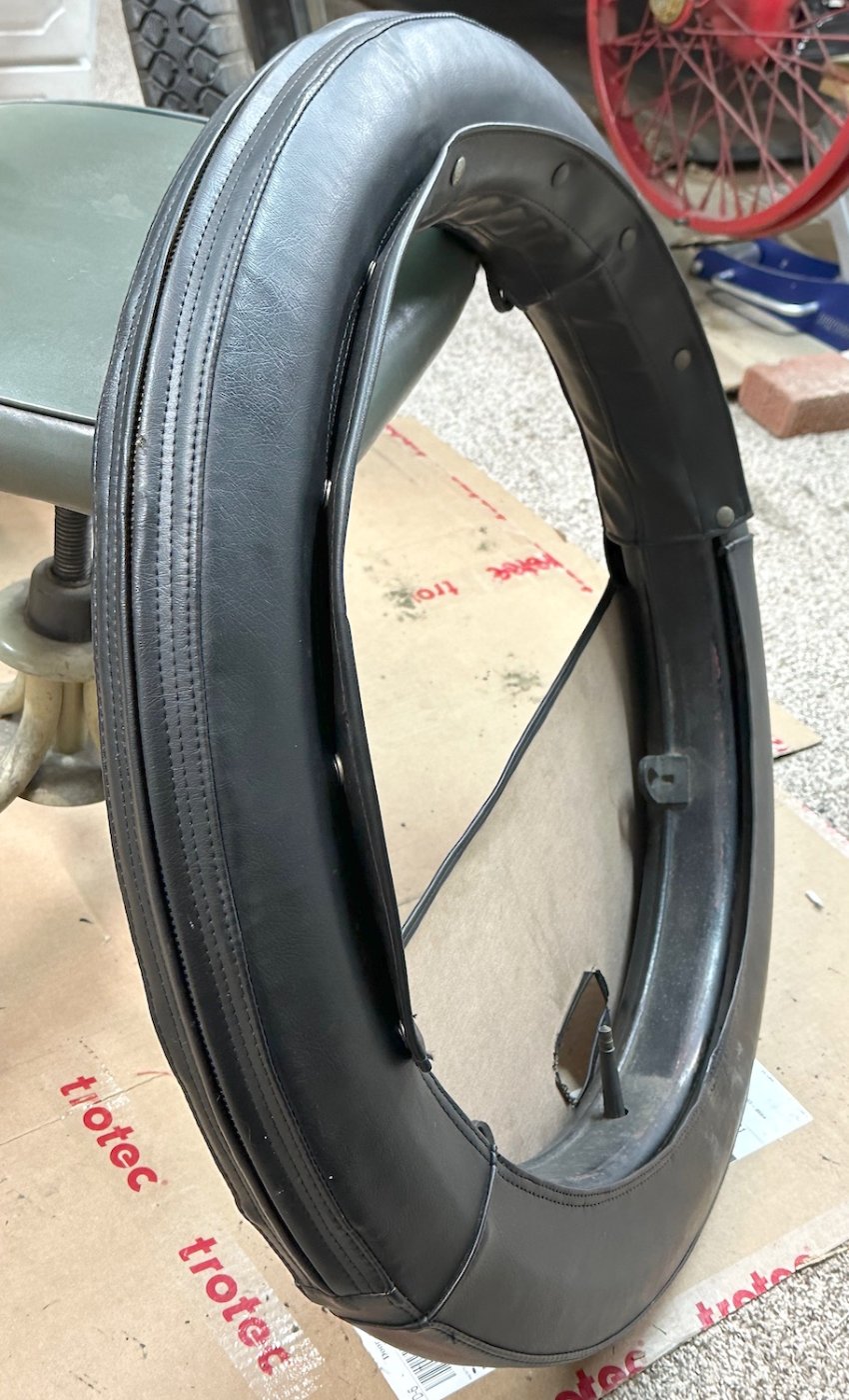

As mentioned in the Samson Tire thread, the spare hiding under the very nice tire cover was a Samson. It is a straight 30 X 3 1/2 size, not the EX size. I have in mind getting the car on the road and out to a show in a neighboring town a distance of 30 or so miles away. The '23 has a good spare & I thought it would work well on the '14, both have demountable rims so why not?
Whall, it turns out that not all these tires are the same size. I could not even JAM the '23 spare into the '14 carrier, its too wide & tall! Not only that, that wonderful tire cover wouldn't fit either! I tried one of the new Ward's Riversides on the ground and while they could just be JAMMED into the carrier, they were still too big for the cover. OK, I'll go without a spare this trip and rely on mobile coverage and the AAA card to get me out of any jam.
Beyond the immediate need, what can I do to get useable spare that will fit both the carrier & the cover? My feverish brain wondered if a 30 X 3 tire is enough smaller to fit both the carrier & the cover?
Paul
Paul

Re: Can a 30 X 3 Tire Be Used on a 30 X 3.% Rim?
That last picture shows the Riverside JAMMED into the carrier.
Paul

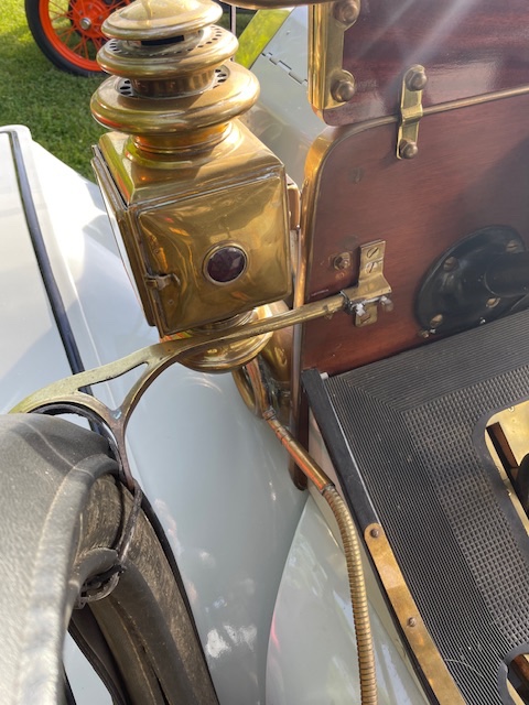

If your spare tyre brackets are brass reproductions, you could open them up a little to take a fatter tyre. Cast iron originals may not like being "bent"
Early cars carried spare tyres, but they were not mounted on rims, so they would easily fit into your bracket.

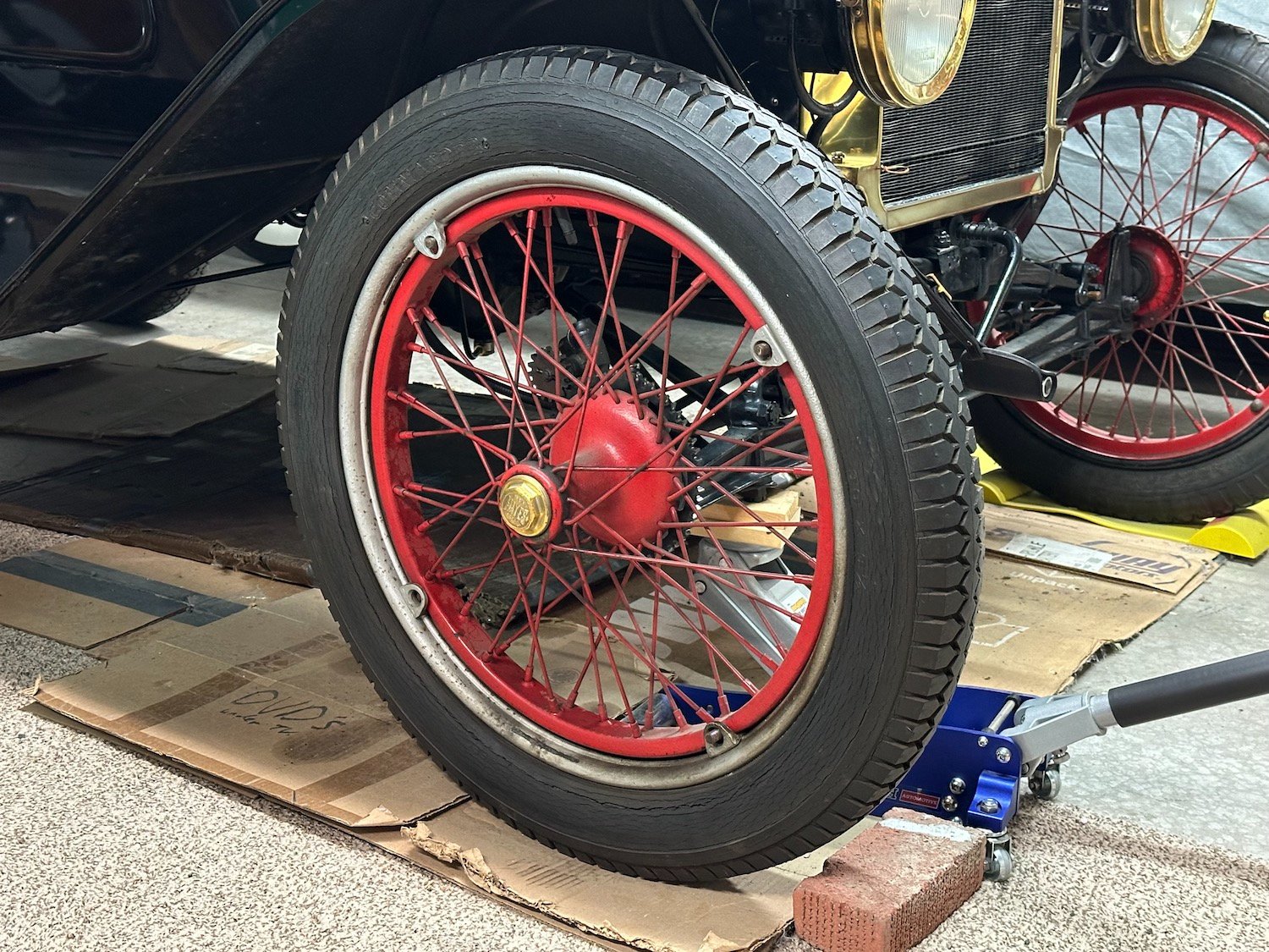

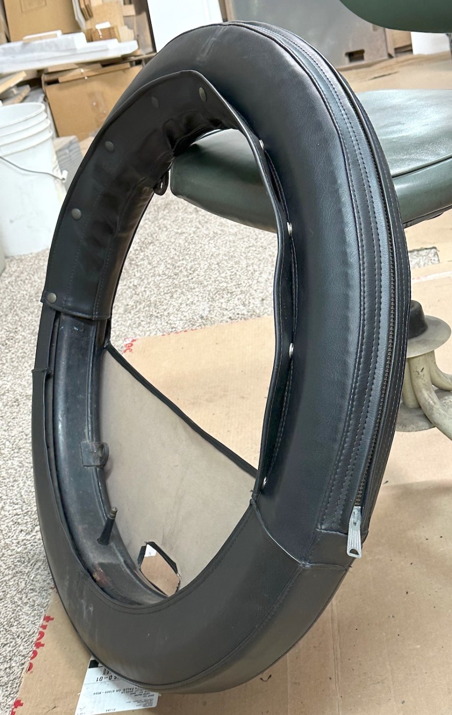

Thanks for all the replies about this situation. I have two concerns that caused me to think about doing this. First, I wanted to use the spare tire carrier that is on this car. It is not a reproduction but like everything else on the car is original. This car was built in the 1960s by a long time T mechanic who used original accessories rather than reproductions. I'm not above bending that brass top mount to get a 1/2" more clearance to fit a modern Riverside tire. How would it be bent without marring it?
The other consideration is the desire to use that excellent tire cover. It fits the Samson like a glove but will not fit the Riverside. This car is garaged and I do not need a cover. I want this cover because it is very nice and perfect for the graphics which lend the car a sense of place. I am Model T alone up here and all my tours are solo. I do take my cars to other events of a historical nature and that local connection would be appreciated.
While the Riverside was off the wheel, I slid the spare off the '23 onto the Hayes wire wheel on the '14 with no hoo-haw at all. Yes it filts and would certainly be useable.
From what I can gather from the opinions here, mounting the 3" tire on the 3 1/2" rim might work but it would be an emergency bodge rather than a workable long term solution. Too bad, I really liked that cover.
Here is a pic of the Commander off the '23 mounted on the '14 wheel.
Paul
Paul

With care the brass casting could be opened up some using heat to just slight dull red color. Too much heat can melt.Hudson29 wrote: ↑Mon Jul 22, 2024 12:55 pmThanks for all the replies about this situation. I have two concerns that caused me to think about doing this. First, I wanted to use the spare tire carrier that is on this car. It is not a reproduction but like everything else on the car is original. This car was built in the 1960s by a long time T mechanic who used original accessories rather than reproductions. I'm not above bending that brass top mount to get a 1/2" more clearance to fit a modern Riverside tire. How would it be bent without marring it?
Paul
Those brackets as Allan mentioned are made to carry a deflated tire casing only, so the tire can compress into the brackets and held with leather straps.
Early tires are more true 30x3 1/2, any modern ones are actually 31x4, the so-called X-size. They fit 30x 3 1/2 rims but are larger width and height, so your original cover would be hard to use.
