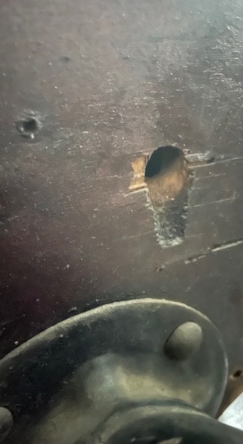

Re: Fire wall drilled for Right or left hand drive
Post by Original14T » Tue Aug 06, 2024 6:07 am
Left hand side unused hole from drivers compartment

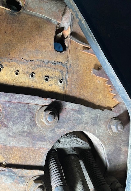

Post by Original14T » Tue Aug 06, 2024 6:09 am
Left hand side from engine compartment

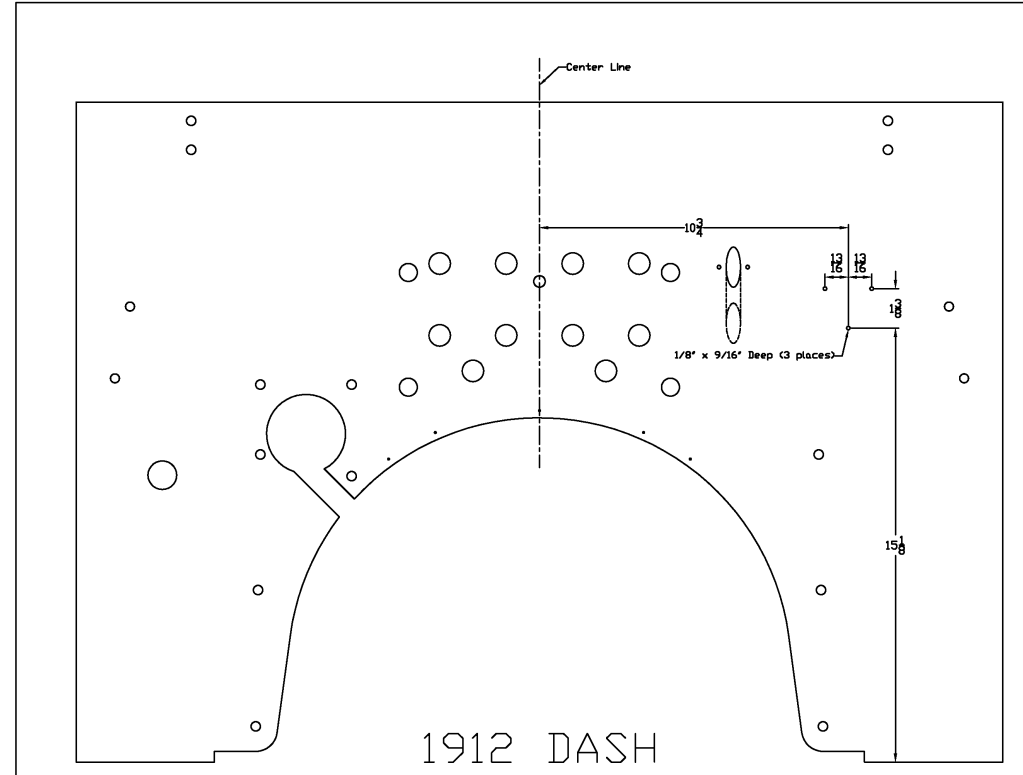

Post by Kerry » Tue Aug 06, 2024 8:23 pm
I have this in my files, can't remember its origins but only the one hole showing.
