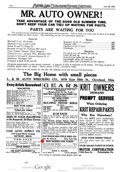

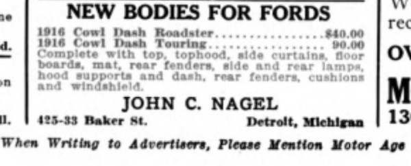

A full-scale aftermarket body business was in play while the "new" 1915 and
1916 Ford open cars were in production. John C. Nagel's Detroit company was
selling complete 1916 Touring car bodies, tops, lamps and all, in his 29 June 1916
adds in the Motor Age magazine (red dot).
Also, Nagel had adds in the 17 June 1915 edition of Motor Age for the "new cowl"
1915 complete Roadster body that would fit 1912 chassis and up. The aftermarket
sheet metal was available by the time a complete car 1915/16 could be had from
Ford. Lamps, tops, seats and windshields were probably any that would fit properly.
Could easily have been an aftermarket body for a RHD chassis and never was a car.
