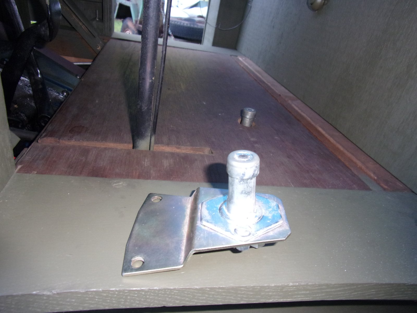

What kind of starter switch are you using?? A Model T switch does not have a "rubber flap between terminals", nor are the terminals spaced so closely that the cable ends could have a chance to touch each other,I'm going to grind my ring terminal ends down a little as well to make sure they do not rub against each other at the switch and make sure the rubber flap between terminals is protecting them.
- Posts: 5265
Re: Did I Fry My Starter?
The new available "tractor" switches have a small rubber flap between the terminals.

Here is a pic of the two starter switches I have. Identical, but do not know if Model T or tractor switch. Both have rubber flap in between posts.
And, after two days of getting close to the ledge, it turned out to be low voltage on the battery. Charged battery today while running errands and reconnected original switch and it starts as before.
Never occured to me that the starter is a "go" "no go" thing. I"m used to slow starters or clicking or something when battery is low. To have the horn and siren work and the coils buzzing but not even a click on the starter is new to me.
But, looks like dodged bullet and learned something new so all is right with the world. Thanks to all who took the time to comment.

Good to have your report, and that the battery was the culprit
That footswitch is the modern reproduction, which uses a tractor type push switch.
Here is the original Ford design of the later footswitches.
And the guts inside, a simple flex bar that makes contact to the terminals when the button is pressed. The originals do get worn over time, a lot of juice goes when starting, reason enough to never hold down the footswitch for a long period, and also, with long cranking over the starter motor can overheat too. A good tuned T motor will fire over with a brief push of the switch.
